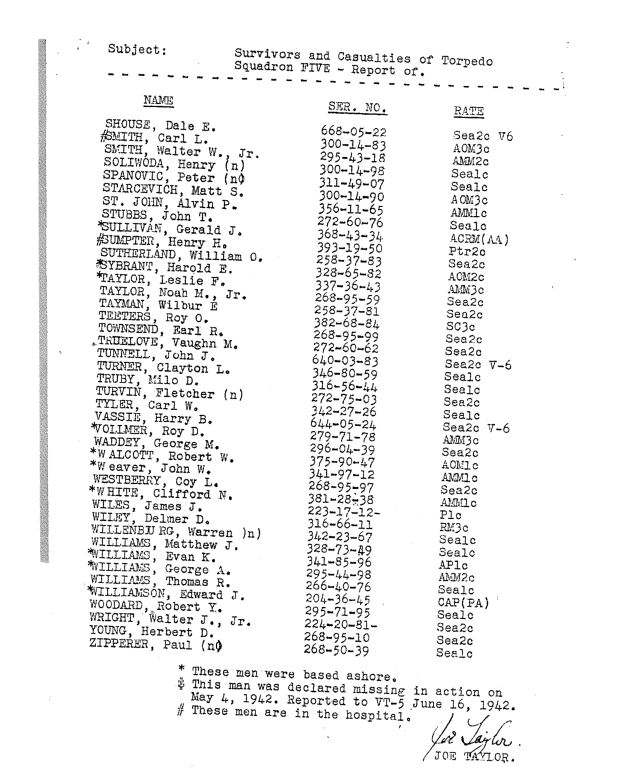

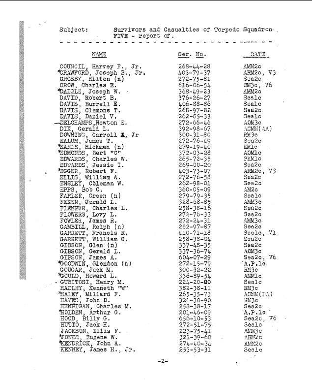

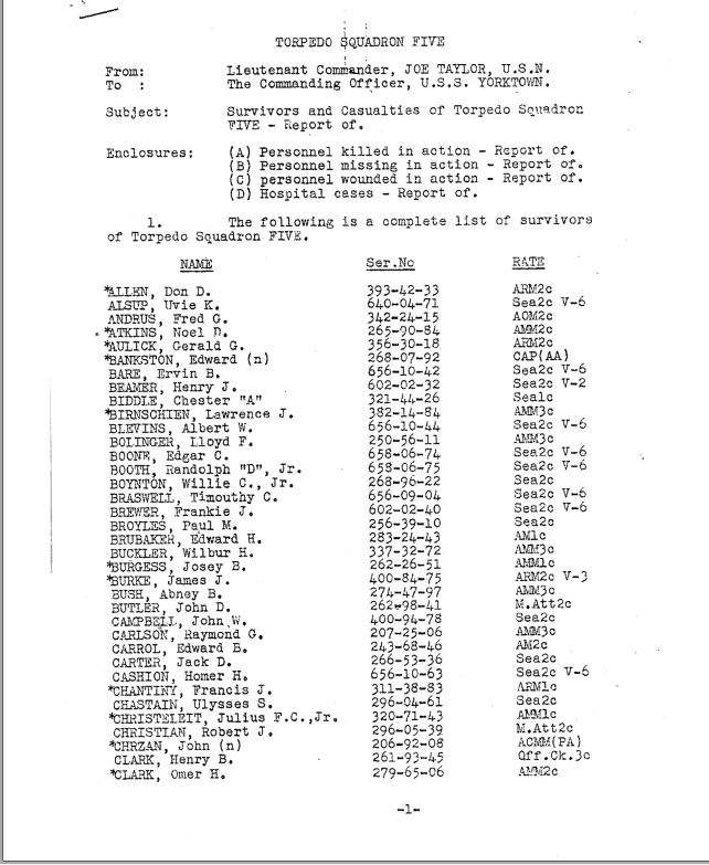

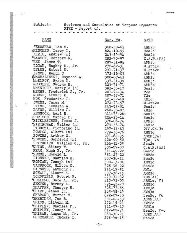

R Leonard
Shows up here on page 3 of a VT-5 list of survivors.  The asterisk next to his name means he was stationed ashore.  This report has no date, it could be after the Battle of the Coral Sea since VT-5 was relieved by VT-3 for the Midway deployment.  The other full Yorktown squadron that did not deploy to Midway, VS-5, submitted a similar report on 22 June 42.  In those days, all squadron maintenance, ordnance, whatever, were performed by squadron personnel, not ships company, hence the large number of enlisted personnel.  The noted enclosures were not with this copy of the report.
I am unable to verify at the moment whether he was actually a TBD crewman.  The TBD gunners were usually ARM variety as they also performed radio work.  TBD was a 3 seater, but the third man was carried only when on a level bombing type mission as a bombardier and was usually an NAP.

R Leonard
Oh, and the TBDs operated by VT-5 off Yorktown were TBD-1s.  There were never any TBD-3s.

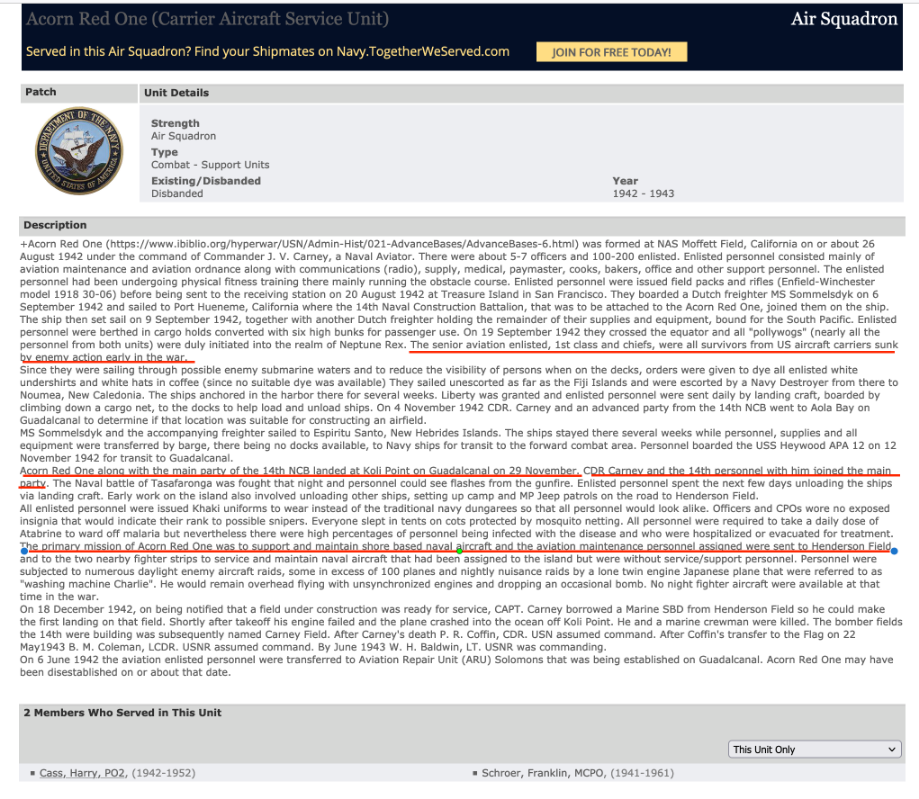

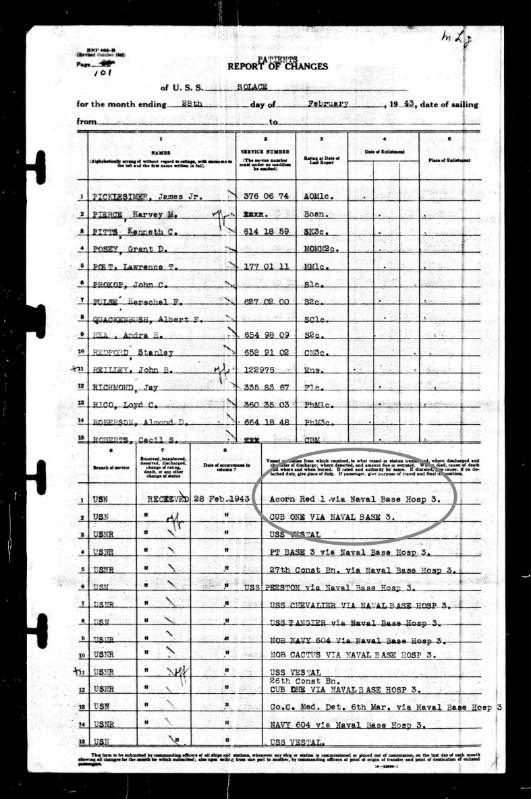

On 6/22/2021 at 4:48 PM, Salvage Sailor said:
As to the veracity of the attached to Carlson's Raiders' and "making the landing on Guadalcanal" claim, well, that's in the realm of a sea story at the moment unless some documentation surfaces.
Yorktown Surviviors Arriving at Pearl Harbor 1942
My brother I think I may have found the Guadalcanal connection ... when he was shot down in Feb 1943 ... On his Hospital Ship Muster Roll ... It says "Via Acorn 1" next to his name.  On September 6th 1942 ... It looks as if he is Leaving Pearl Harbor on the Wharton destination unknown.  Then looking up Acorn 1 ... I came across this description attached.  It seems some how that he may was attached to this unit.  I was wondering why a man with such an impressive service life ...haha.... would embellish anything towards the end of his life or when ever his memoir was written.  I think something here is the connection.  Let me know what you think! Man I love researching stuff.  Collecting these helmets is great and I love the pieces but this is the juice for me!
Z
