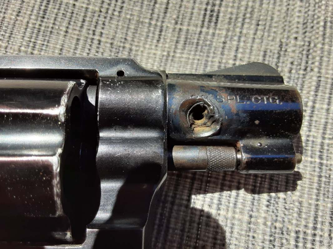

hyrax222 Posted June 21, 2021 #1 Posted June 21, 2021 I need an original barrel (I'll wait till you're done laughing) or an excellent reproduction. Anyone able to help me? Thanks! hyrax222

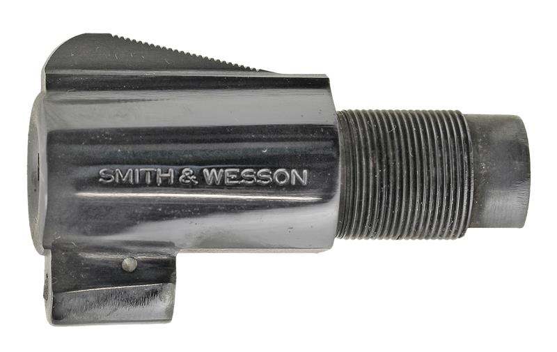

Charlie Flick Posted June 22, 2021 #2 Posted June 22, 2021 Hello Hyrax: The task might not be as tough as you might think. The original steel barrel on your M13 should say "Smith & Wesson" in one line on the left side. On the right side it should say ".38 SPL. CTG." in one line. The original barrel would have had the revolver's serial number marked on the barrel flat. With the original serialized barrel damaged or gone you will have to go with a replacement barrel. I would search for a 2 inch blued barrel for a Military & Police .38 Special, either the steel version (a pre-Model 10) or the alloy version (the pre-Model 12). Below is a pic of what the barrel should look like. It is taken from the site of Gun Parts. Corp. which says on its website that 2 inch barrels are out of stock. The proper barrel will not say "Airweight" or "Aircrewman" on it. If you can get a new replacement barrel with no serial number on it that would be best, but you may have to accept one that is a used take-off barrel that is already serialized. You will also need a new barrel pin. Another alternative may be to hunt for one of the demilled examples of the M13. They are easy to find but almost all of them have had their barrels crushed or torched as part of the demilling process. Finding one with a suitable barrel may be difficult. One last alternative is to check Ebay and gunbroker.com. I hope that info helps you. Regards, Charlie
hyrax222 Posted June 22, 2021 Author #3 Posted June 22, 2021 Charlie Flick- Thanks for the reply. I have the orig. barrel, but there is a hole burnt into it. I have a new Model 36 barrel but it is not maked correctly for an Aircrewman. So, online auctions are one of the few choices left. I'm not very hopefull! hyrax222

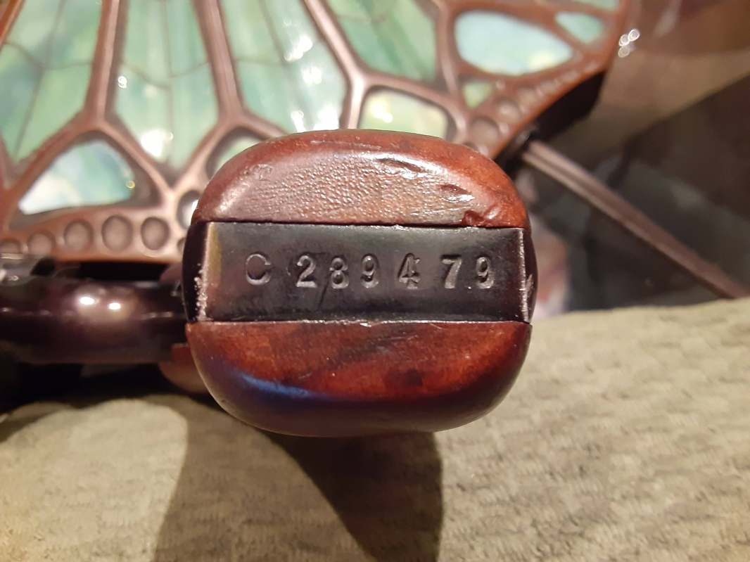

hyrax222 Posted June 26, 2021 Author #6 Posted June 26, 2021 Right side of barrel-".38 SPL. CTG." Hole burnt through. Left side of barrel-"SMITH &WESSON". Frame and crane stamped- "26582". Bottom of butt-"C289479". Bottom of barrel- "269478". What a hodge-podge of numbers! Does any of this help? hyrax222
kwill Posted June 26, 2021 #7 Posted June 26, 2021 The frame/crane number (26582) is an assembly number used to keep parts together during manufacture but other than that it doesn't mean anything. The barrel has been replaced since the serial number doesn't match the one on the butt. When these were demilled the crushed, torched and/or cut parts were sold as scrap and dealers would try to put guns together from the pieces. Does yours still have the markings on the back strap and top strap? C289479 would have shipped in mid-1954, probably to Norton AFB.

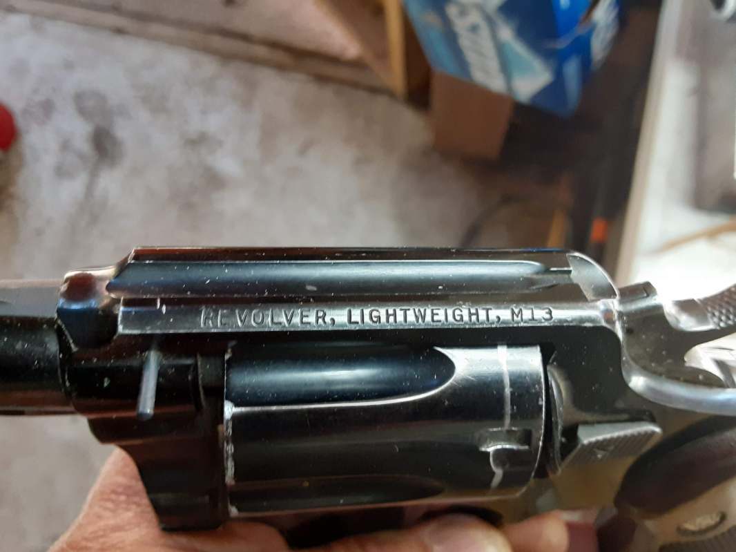

hyrax222 Posted June 26, 2021 Author #8 Posted June 26, 2021 Marking intact on backstrap-"Revolver, Lightweight M13". hyrax222
kwill Posted June 26, 2021 #9 Posted June 26, 2021 I may be misunderstanding you but the back strap should be "Property of U.S.A.F." and the top strap should be "Revolver, Lightweight M13."
digi-shots Posted June 27, 2021 #11 Posted June 27, 2021 Interesting revolver... are you sure about the numbers on the butt and barrel not matching? An 8 can look like a 6 or 9. Could the burned out hole have distorted the numbers under the barrel?

hyrax222 Posted June 28, 2021 Author #15 Posted June 28, 2021 Many thanks to Charlie Flick, kwill, story and digi-shots- Numrich pic and ad close, but out of stock. I miss-read the ser. no. on bbl. It matches the no. on butt. I have been on S&W Forum. Checked avail. on Brownells, Gunbroker, Numrich, Jack First, Slinks, Popperts, Sarco, Ebay...nothing. Many J frame bbls. and no K frame 2" bbls...this could take awhile, unless someone coughs up one out of their "stash"! hyrax222
