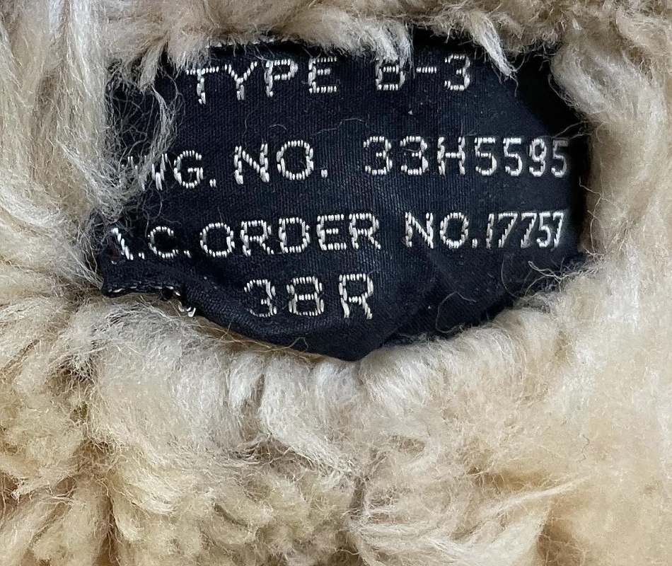

Someone pointed this B-3 jacket out, to me, And I thought instead of posting photo's of it and hear its a dude, I thought I would post the tag and go from there.
So does this look like a Real WW2 B-3 Tag?
Thanks for looking!!!!
Semper Fi
Phil
No it doesn’t to me. There are no-name contracts but they are well established - not sure about B-3s. If you look up the drawing or contract number you might find an issue. I remember one older repro used the numbers off of trousers or something else so it would look official.

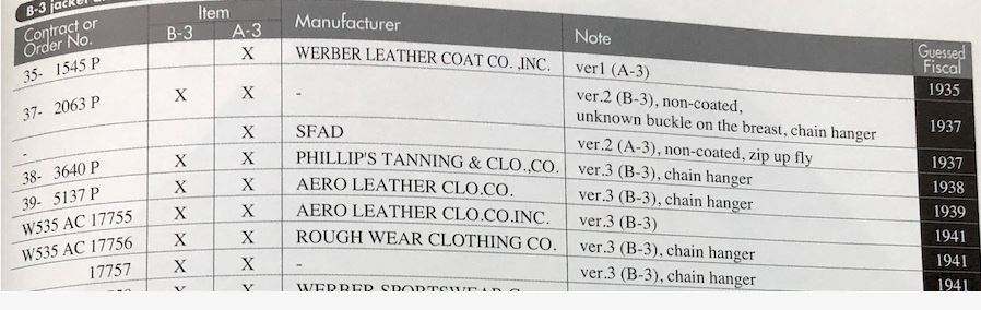

Rough Wear had a 17757 contract...but not sure if the tag would be marked Rough Wear or not

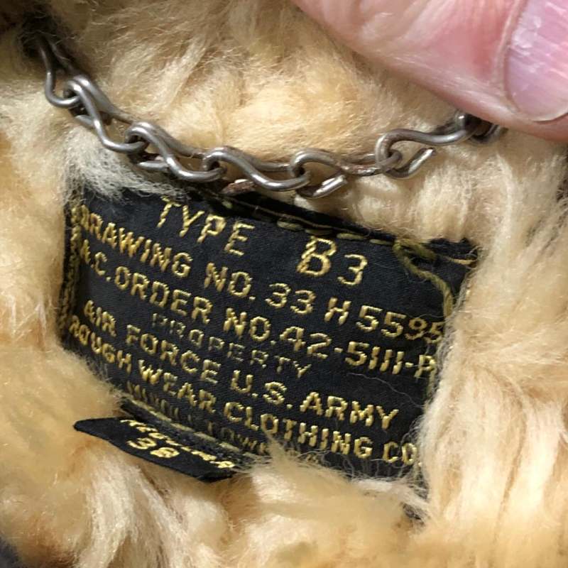

This is a photo of the Rough Wear Clothing tag from another B-3 posted on another site.
This one has all the info I would expect to see. Where the first one has minimal information.

Just not sure, Phil. The white on black label doesn't look right for that contract. The overall jacket doesn't look bad to me.

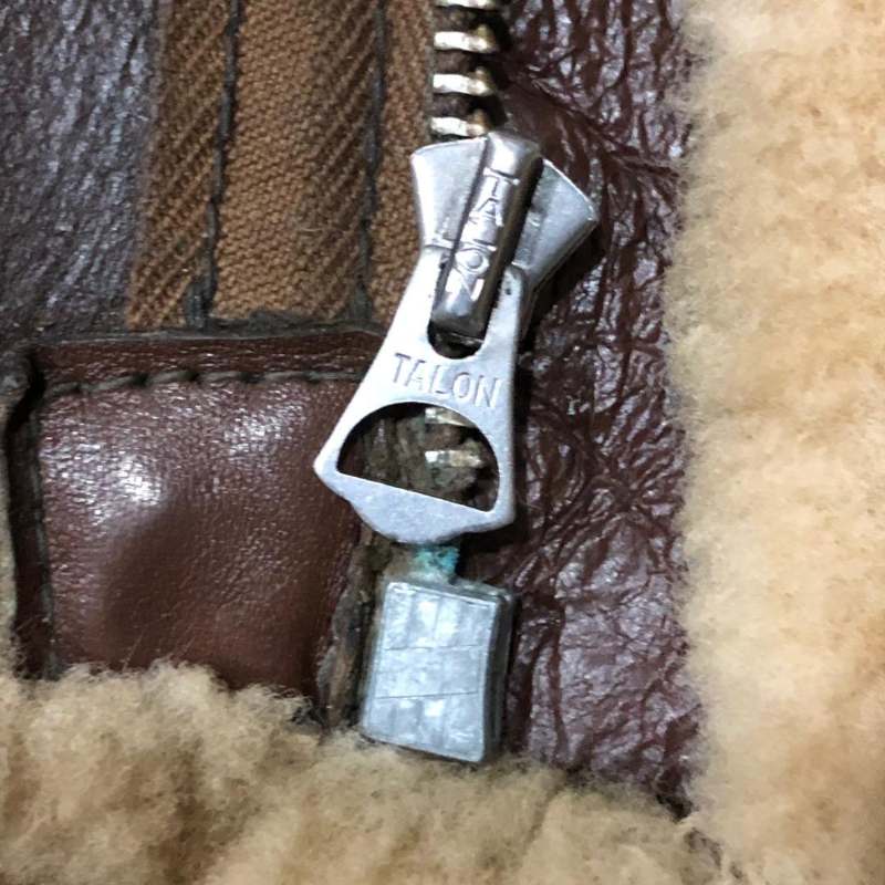

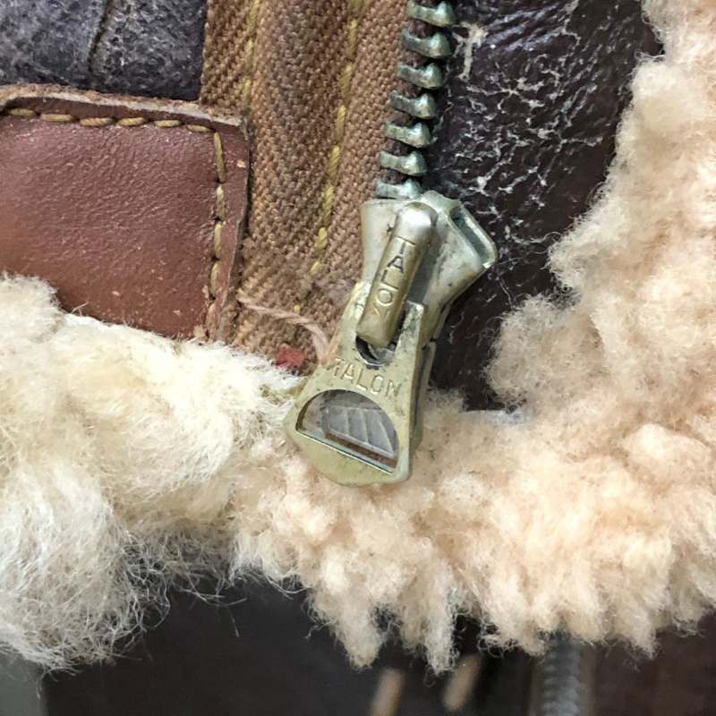

Does the zipper work and what kind is it? Need pics of the slide and the box end. That's kind of a staple question with vintage jackets and can tell a lot.

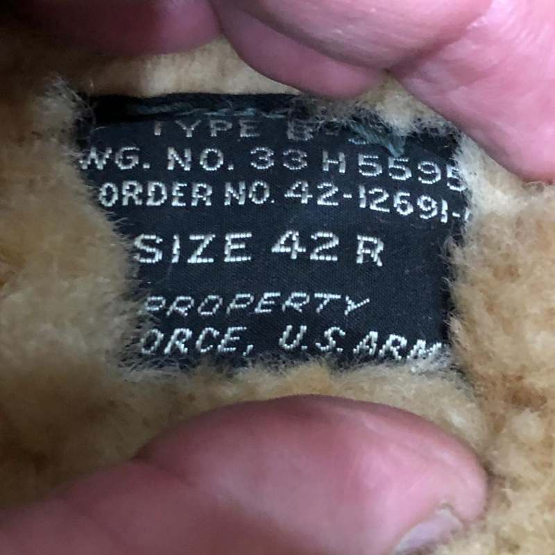

Okay, foot in mouth. The straps are finished on my unnamed and on my RW example. Both backs are 3 piece. My unnamed has white lettering as well but is different enough that I would call this jacket unverifiable. The label checks all the boxes for the intra and post war sporting labels.

This is the No Name.

Phil, At a fair price it would make a good repop project, but that's all. Jackets that are split all the way down the back in the center like that are nothing I have seen in WW2 military leather A-2 or B-3 jackets. Not sure about the D-2. I would have to refresh my memory.
The subject label and jacket are 100% genuine and, if still available, I’ll buy if you do not.

Saying all contributors here "don't know what they are talking about" might be a little rough. I think we all see the redskin, correct though partial numbers, etc. I wouldn't die on the hill that this is absolutely authentic though it appear it to me. Why? Because I learn something every day. You will see I retracted some of my concerns earlier based on looking at originals. The original pic of the label is the concern to me still. No contract year, no maker, no property mark. All very typical of the post wartime-ish and civilian variants.
I can be more certain when it is other's money but if I must air all concerns, I have to bring up any noticed variations.
Can you explain the variations in this label for us? Were all GW labels from the 17757 contract like this?

The label is genuine and so is the B-3; I know this from my decades of experience:  This is a one-looker for me, as I know my A. C. flying jackets and this contract exceedingly well, and I can see the label is cotton, not synthetic, as are all labels made today, and no repro maker has perfected their "redskin" sheepskin to this level, and sheepskin breeds today simply do not match what was available in 1941 when this jacket was contracted and produced.  Additionally, age and wear represent salient areas of detection that cannot be favorably duplicated, whether it's a steel helmet, a leather jacket, or a cotton or wool uniform.
I am unsure what the "GW" abbreviation you stated means vis-a-vis the 17757 contract, but every 17757 B-3/A-3 Winter flying Suit I have seen does indeed have labels exactly as seen here (winter flying suits were contracted for in sets, and both jackets and trousers will share the same contract and P. O. number).  Prior to 1942, contractors were not instructed to list the "Property" declaration on labels.  A great illustration of the transition phase for the "Property" declaration mandated for labels is J. A. Dubow's 23379 A-2 contract:  this was awarded on Dec. 26, 1941, and we can find examples of this contract without the "Property" declaration and also with a separate label sewn below the main label that does bear the "Property" declaration.  A reasonable deduction for this event is that the main labels were made before the new directive reached the contractor and some jackets could be produced, then the contractor, having received the directive, had to have the separate labels made and attached to all subsequent jackets yet to be produced.  I have not, however, seen this with any B-3/A-3 sets produced in "redskin," as these were all contracted much earlier in 1941, with completion of all contracts very likely in 1941 or very, very early 1942.  Additionally, for example, the HLB Corp. P. O. No. 42-5112-P for B-3/A-3 sets date to a contract from very early 1942, yet every example I have encountered does not display the additional "Property" label sewn below the main label, so the main labels exist as did labels for contracts produced prior to 1942.
The specs. for the B-3/A-3 sets, A-2's, B-6/A-5, etc. all stipulate for the contractor to list their name or contract number or P. O. number, with most contractors choosing to list both name and number, but some, as seen here, elected to only list the contract number, and none elected to list only their name.  Labels were supplied by the contractor and were paid for by the contractor as part of the contract (unlike the other materials that comprise the contract work) and there was no stipulation by the A. C. for size or color of labels, which is why we can find shorter or longer labels and labels that are taller and with and without borders, silver-on-black labels, gold-on-black labels, white-on-black labels, and later in the war, brown-on-white labels and red-on-white labels.  The contractor simply went to a label-making company and had a woven label produced in whatever quantity was needed with the information mandated in the contract and/or spec.  I have seen memos from contractors where it is noted that label maker X is making labels for, say, Rough Wear Clothing Co., and that "we should contact that label maker for pricing."
