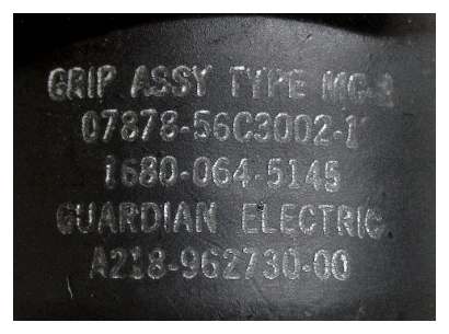

Sold as a US-made B-8 control stick (and I confess I thought it was too), looking closely at the grip's left-side base, the paint-stamped markings tell otherwise and definitely make it an MC-2. We'll get back to this point later while discussing the typology.
GRIP ASSY TYPE MC-2
07878-56C3002-01
1680-00-064-5145
GUARDIAN ELECTRIC
A218-962730-00

The manufacturer - Guardian Electric- is not only mentioned by name on the grip, but also with its logo.
There are also what I believe to be a quality control stamp underneath the hand rest, and a unique serial number (we'll get back to them at the end of the next paragraph).

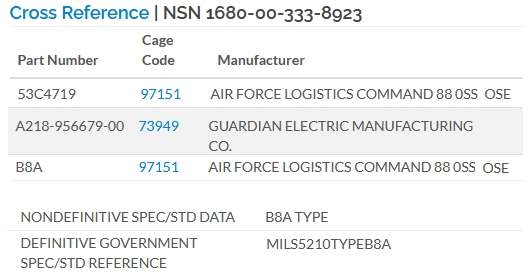

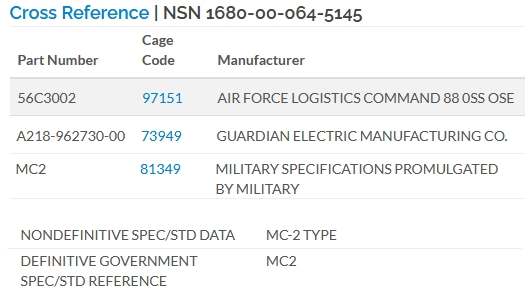

Definitely eager to learn more about it, I searched the web for the NSN 1680-00-064-5145 present on my grip.
As correctly stated in the previous quote, the gathered data (see below) indeed matches perfectly the part's designation for an MC-2 (07878-56C3002-01), as well as the manufacturer (Guardian Electric) and the part number specific to this contractor (A218-962730-00), just as stamped on my example.
Cropped data montage (C) wbparts.com (complete page HERE)
Note that the NSN assignment for this part is dated January 1963.
I decided not to stop at the MC-2 type and also searched for its counterpart with the -53C4719 number mentioned in the previous quote, number that would theorically match the B-8 grip. The search result came up with the following cross-reference data, giving away the NSN 1680-00-333-8923 that corresponds to the B-8A type, dated January 1963 as well.
As you can see, Guardian Electric indeed manufactured some of those too.
Data comparison confirms the quoted statement regarding their huge similarities :
  • same NSN assignment date, supply group, and Item Name Code (INC)
  • 17-pin connector
  • 1.5 in"-wide mounting end
  • 3 / 1 / 1 switches (3 pushbuttons / 1 toggle hat button / 1 trigger)
Yet, the only slight differences I've spotted are the overall lenght (6.5 in" for the MC-2 / 6.0 in" for the B-8A) and mounting end lenght (0.906 inch for the MC-2 / 2.843 inches for the B-8A).
Since I hven't found any "B-8" or "B-8 type" matching NSN in the online databases, and given the B-8A and MC-2 with NSNs dated January 1963 are said to have replaced -at least- two similar parts (listed below) as "obsolete" / "item cancelled as duplicate", my guess is that the following NSNs were most probably among the early B-8's.
  • NSN 1680-00-562-2961 terminated in January 1963
  • NSN 1680-00-801-3973 terminated in January 1960
The previous evidence makes me believe that as for 1963, only B-8A and MC-2 remained manufatured, and the "B-8"-only nomenclature refering to the early grip models (the head of the family if you will) was not produced as such anymore.

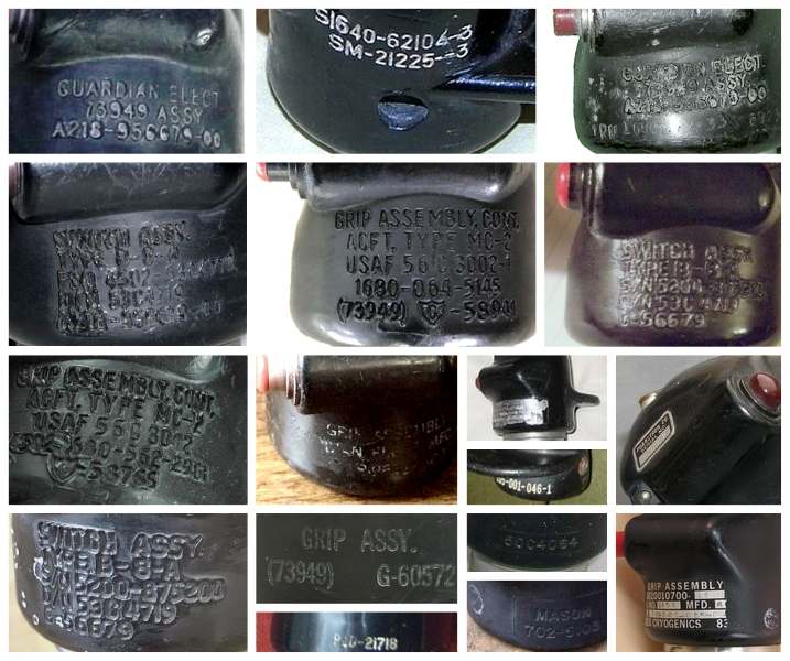

During my pictures' quest for illustrating this writeup, I've looked at a multitude of part number markings on the grips, leading to multiple (more than 20) cross-reference NSNs to the B-8A / MC-2 controllers. Some were more limited in time, quantity and number of manufacturers than others, some specifically made for a given branch or aircraft, however they ALL can be considered from the B-8 family.
Smoothly / roughly heat-stamped, engraved then painted inside, paint-stamped or even foil-labeled, featuring between 1 and up to 5 lines of alphanumeric characters mostly on the left-side bottom... the marking method for the B-8 flight grip family widely differs regarding the part number, contractor, and manufacturing period.
This montage is quite representative of the huge markings' variety !
Although the control grips from that prolific family are very similar and can be confused with each other (the many cross-reference NSNs do not help, for sure !), concording online sources state that a few noticeable evolutions appeared circa the end of the 60's and became more and more common on the grips issued, as the contractors adopted them and the 70's unfolded.
Consequently, regardless of the NSN or grip type nomenclature, these simple differences can help at least identifying the early grips from the later ones.

Noteworthy, some of the markings present on the grips seem to be specific of the manufacturers, and somewhat off the NSN / part number regulations.
Thus, the most remarkable one for Guardian Electric grips is their logo, a capital G inside a shield, as seen on my example and many others.
The paint-stamped "(G6)" underneath the hand rest seems to be some kind of a quality control check, batch number, production line, or something of this kind that is internal to the manufacturer, given that I've found similar "G+number" stampings on Guardian Electric grips (and not only the B-8 type).
Finally, the heat-stamped "7411306" underneath the top pushbutton's bulge will remain a question mark, since it doesn't lead to any result on a part number / NSN search.
I've found differing 7-digit  numbers heat-stamped at the same place on a couple of other Guardian Electric B-8A / MC-2 grips, so I would assume this is a unique serial number internal to the manufacturer, but there's no way to be sure.
Similar markings on Guardian Electric grips.

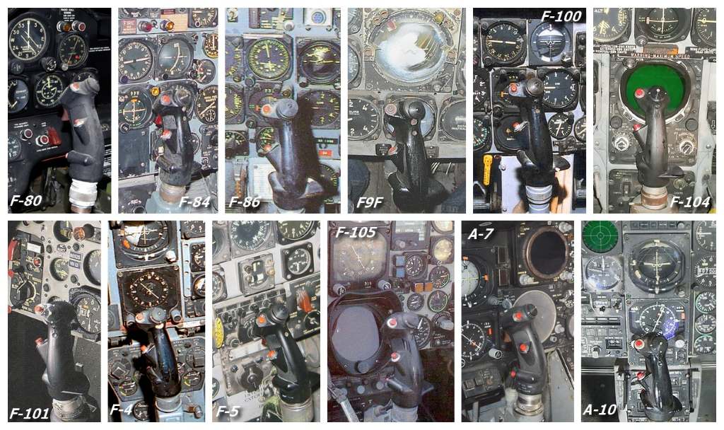

Knowing this example came from the US in the first place, let's begin by a non-exhaustive list and cockpit montages of famous US aircraft (foreign ones are unlikely) that have been fitted (at the minimum for one version of each aircraft, at best for the whole series) with the B-8 / B-8A / MC-2 grip family.
Please note that other notorious US helicopters and jets sport very similar grips, but because either their connector to the control yoke is not vertical, either there are a few added pushbuttons, I won't be showing them here.
  • P-80 / F-80 / T33 Shooting Star
  • F-84 Thunderjet / Thunderstreak
  • F-86 Sabre
  • F-94 Starfire
  • F9F-6 Cougar
  • F11F Tiger
  • F3H Demon
  • F-100 Super Sabre
  • F-101 Voodoo
  • F-104 Starfighter
  • F-105 Thunderchief
  • F-4 Phantom II
  • T-38 Talon
  • F-5 Freedom Fighter / Tiger II
  • A-7 Corsair II
  • X-29 (!)
  • F-15A Eagle
  • A-10A Thunderbolt II

As a matter of fact, because they were still in use at least in the late 70's / early 80's, some of the Century Fighters (jets of the 60's with a 3-digit nomenclature) and the F-5 family, built between the late 50's and the early 70's, deserve to be kept in the probable list nonetheless.
Because we're talking about late or modernized versions of these jets, there's no secret that newer grip sticks were parts that could be easily inserted in production lines, or replaced during a retrofit process.
Truth is, I've found a significant number of F-105, T-38A, NATO F-104 and (C)F-5 cockpits fitted with late-type grips features that tend to confirm this theory (one-piece tall pushbuttons & dot / arrow markings on the toggle hat).
On the other hand, even if they were retired in the 70's, F-100s and F-101s did not seem to have benefited these grip's improvements : only one F-100 and two F-101 cockpits sporting late grip features were to be found, so I have cautiously decided to put them on the bottom of the list.

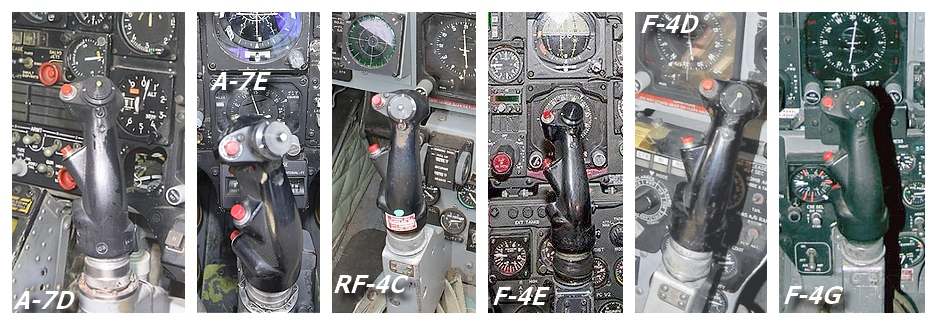

➡️ Two of the most famous jets in History - F-4 Phantom II and A-7 Corsair II - used a modified variant of this grip, basically a B-8A type lacking the hand rest, making it pretty easy to identify in the cockpits and on the used market today.
Even if a lot of these grips were of the late-type configuration for these planes remained in use until the mid 90's in the US forces, the lack of hand rest rule them out regarding my grip. Yet, I'd like to add a few words about them regardless.
I've learnt these grips were mass-produced out of a regular B-8A mold sporting a hand rest, then trimmed later (likely on assembly lines, frequently leaving a "scar" on the right side), allegedly to facilitate the use of the steering wheel / anti-skid bottom switch.
While being produced exactly the same way as their counterparts featuring a hand rest, they sported different NSNs ; I've managed to find -at least- two of them, considered as cross references for the B-8A.
  • NSN specific of the F-4 grip : 1680-00-968-1063 (january 1963)
  • NSN found on two A-7 grips : 1680-00-878-2167 (august 1967) - unsure if specific of the A-7 though...
Montage of cockpit views showing the characteristic lack of hand rest.
However, given the huge amount of cross-references in this control grip family, it remains possible in my opinion that other specific NSNs might have been manufactured for these planes without the hand rest out of a modified mold - and not trimmed afterwards (but it's hard to tell for sure).
Nice example of a Guardian Electric B-8A with part number matching a Phantom pilot grip (C) IMA-USA
The "trimming" scar is clearly visible on the middle close-ups.
On a side note, the B-8A grip on the Phantom was only meant for pilot (forward seat), while the RIO (back seat) sported a more specific canted stick derivated from the B-8. A couple of F-4 front cockpits sporting hand-rest grips can be found on museums, but it's safe to say these were scarce and not the norm on Phantoms (or perhaps mistakes when the planes got restored ?).
Montage of the successive F-4 pilot grips using NATOPS 1975 Flight manuals' extracts (full version on bottom of the linked page)
1- initial naval Phantoms' grip (F-4B & early -J variants : B-8A w/o bottom pushbutton switch)
2- most common B-8A-type grip (B-8A without hand rest)
3- late grip (more ergnomic, adding a second four-way switch for weapon selection on the top)

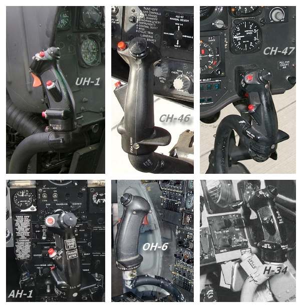

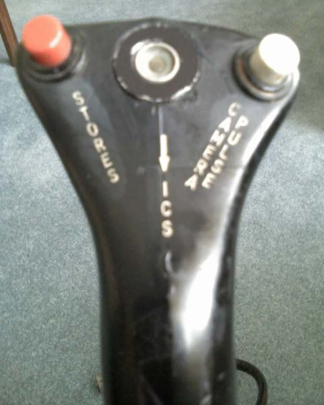

➡️ Let's also put aside the helicopter hypothesis, for the vertically-fixed B-8-type grips used as cyclic controllers sported characteristic screws on the front and bottom (facing the pilot), unlike with fixed wing aircraft. NSN 1680-00-914-2653 (dated 1960) and 1680-00-106-4546 (dated 1968) appear to be frequently encountered chopper grips, pretty iconic of the UH-1 breed as far as I've noticed.
Moreover, on most of them, the controls' descriptions were engraved and painted white next to each pushbutton (trim rel. / cargo release / auto lev.), the most notable difference with jets being the main 2-stage trigger usually used as a radio / intercom switch.
Montage of B-8-type cyclic grips sported by choppers circa VN era.
The far right example belonged to a Cobra gunship, you can't be mistaken with such explicit markings !

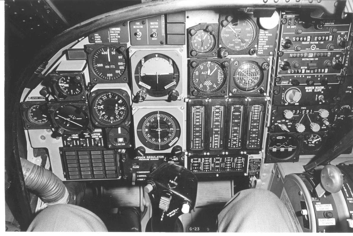

➡️ The rare F-15A Eagle B-8A-type grip featuring 32 pins (instead of the regular 17-pin connector), a taller middle-side black pushbutton  and manufactured by Essex Industries (NSN 1680-01-025-0403 dated July 1976), can naturally be put out of the list too.

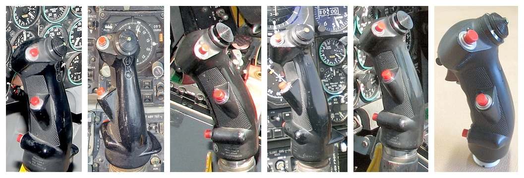

➡️ Last but not least, remains the case of the mighty A-10A.
Built between 1975 and 1984, and from the cockpit views I've found so far, I assess the Thunderbolt II used the late B-8A / MC-2 grip assembly from the beginning, until the A-10C upgrade in the early 00's which added a new grip controller along with a more modern glass-cockpit (just as the T-38C's).
Almost all the cockpit photos I have found so far confirm this statement (a couple of them miss the green dot), showing grips sporting the same configuration as the one I own with the brown trigger and plastic guard when seen from the correct angle.
This picture and attached information found on the forum look pretty relevant as well to me.
In the end, the research and reasoning I've made make me think the probability that grip belonged to one of the following jets seems reasonably plausible.
Besides, judging by the presence of a brown trigger + trigger guard (which is not that frequent) on many examples, and the fact these planes served in the USA later than the others in the 80's until the early 00's with such grips, I guess we can put the T-38A and A-10A on top of the list.
Nothing for certain of course, but at least we will have eliminated quite a lot !

That is a cool grip,  may not be at big of an item as a helmet but hell they sell for just about the same bit of money.  I noticed you are making all the stock numbers as an NSN which your grip lacks.  Your grip has a FSN, Federal Stock Number which exited til around 1974 then they became NSN, National Stock Number, unless you go outside the US then it might be a NATO Stock Number.  US made items will have the ID code 00 or 01 usually as the 5th and 6th digits in the NSN,  FSNs lacked the country code bit.  I know for example off the top of my head a stock number for an item from the UK will have the country code 99 as its 5th and 6th digits.
In regards to the helicopter theories, not sure on some in that list, but the grips for a Huey were usually marked 204- or 205- and also directly screw into the metal stick assembly, they didnt have the threaded coupling like the B-8 style etc.   I can also 110 percent say it wasn't a OH-6 grip either,  that pic you show that might have come from a surplus OH-6 had the grip replaced in civilian life.  OH-6 and later OH-58A and C aircraft had what is called  a LOH grip from the manufacturer who original was Mason I believe.  Much different style grip and alot of times when OH-6s were surplussed they got refitted with a generic style grip like the B-8 style etc.  Civilian Hughes 369 aircraft and later MD came with that style grip vs the military LOH style grip, but again those are usually directly screwed into the metal stick assembly vs a threaded connector.  The threaded type grips seem to mostly come from fixed wing aircraft.  Id say your grip is from the early to mid 70s.
Grips are a very cool addition to collections. Id like to get a UH-1 and OH-6 type grips for my father.  I have a compelete stick and grip assembly from an OV-1D Mohawk, the radio/ICS switch on it broke off unfortunately.  The OV-1 has a unique grip in its own,  some jets have a similar shape but aren't the same.

22 hours ago, mohawkALSE said:
[...] directly screw into the metal stick assembly, they didnt have the threaded coupling like the B-8 style etc
Did I forget to mention the lack of thread coupling on B-8-type helicopter gr....? Skipped it, darn it (I only mentioned the front and rear coupling screws on the bottom) ; anyway, it was another clue that would rule them out.
Thanks for the clarification on the NSN / FSN, dating info for my grip, and chopper insight, everything was very interesting !

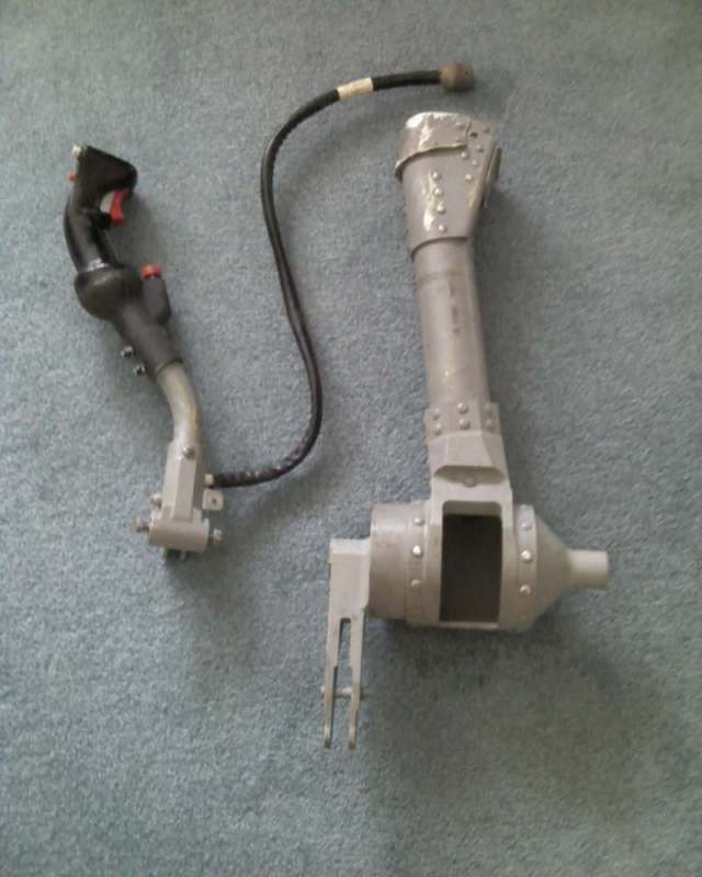

Also, that's a very cool OV-1 control assembly you've got there 😉.
