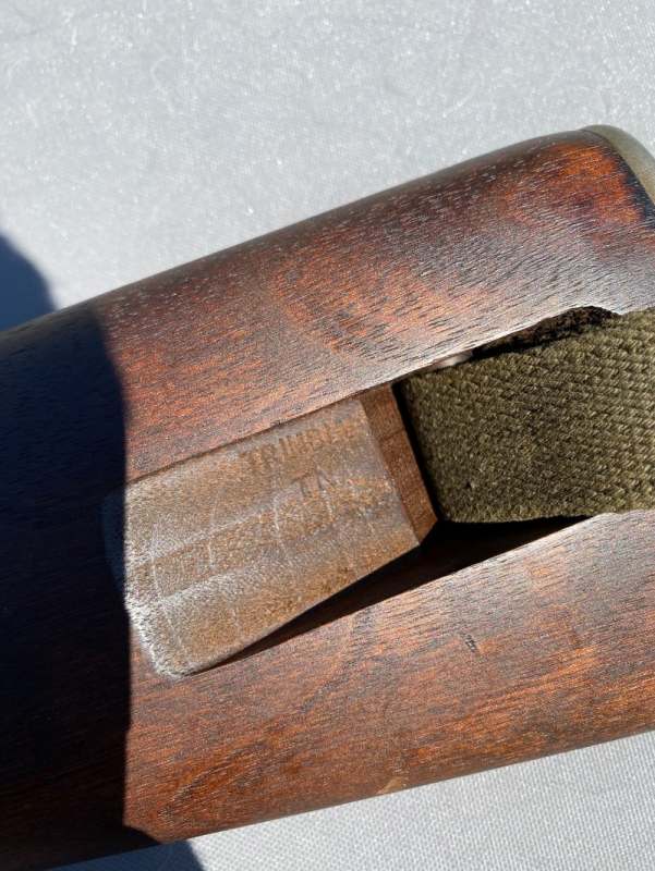

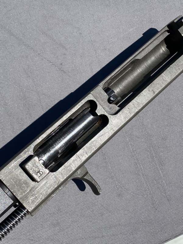

Opportunity to purchase this and I’m just curious what my fellow carbine enthusiasts think about it.
tarheeltim

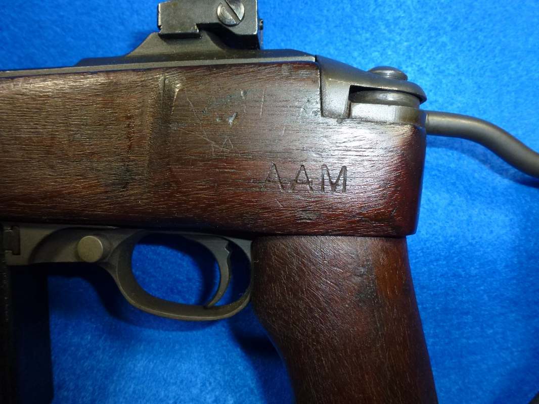

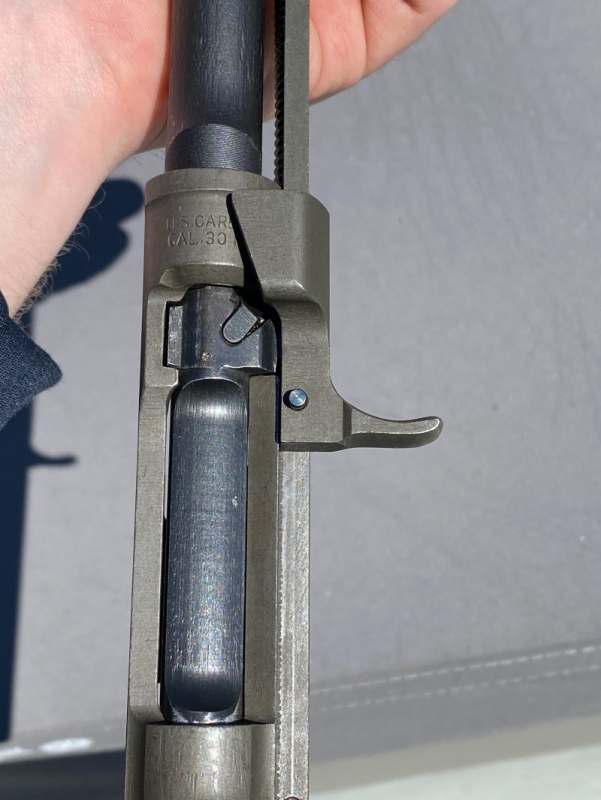

From what I see, I like it.  Obviously, it's not possible to see how all pertinent parts are maker marked from the photos.  Trimble stock is definitely correct.  Early features like flip sight, barrel band, and safety are nice.  Can't see how barrel is marked or if it has import stamp.  Even if it's not all matching NPM, would be nice to have if the price is favorable.

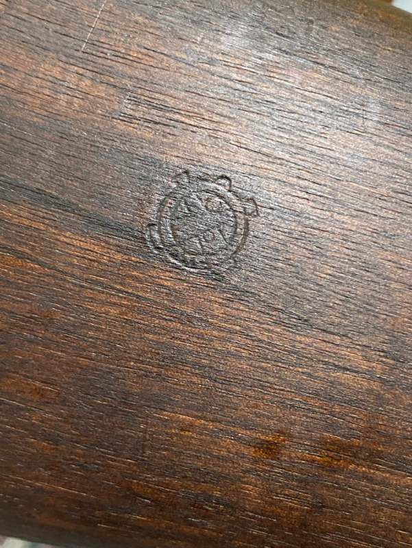

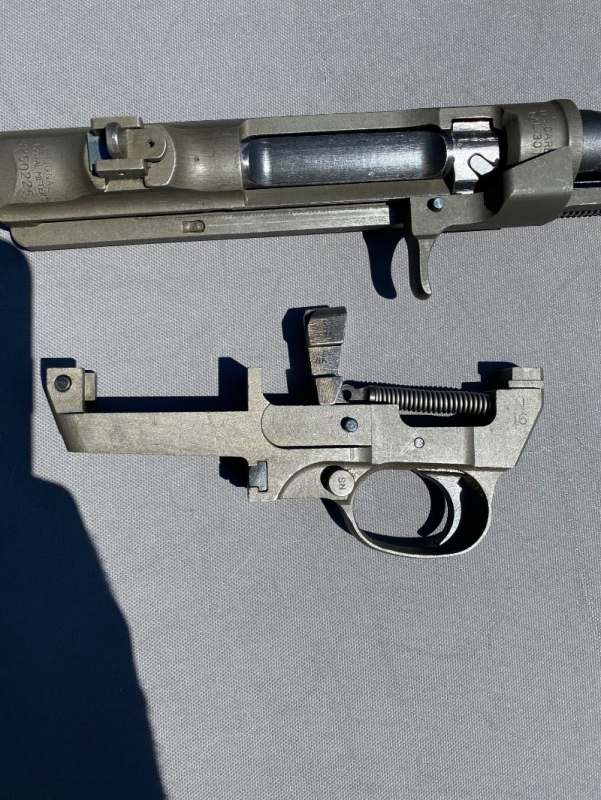

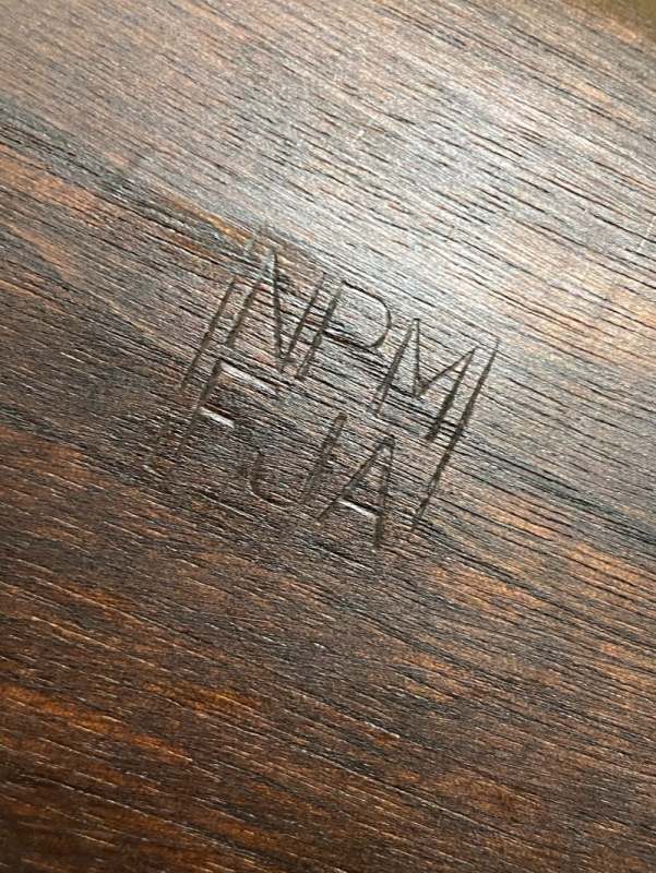

All internal parts are marked for npm. I stripped it down and made sure of that. The stock cartouches are what I’m skeptical of. There are just too many fakes around.

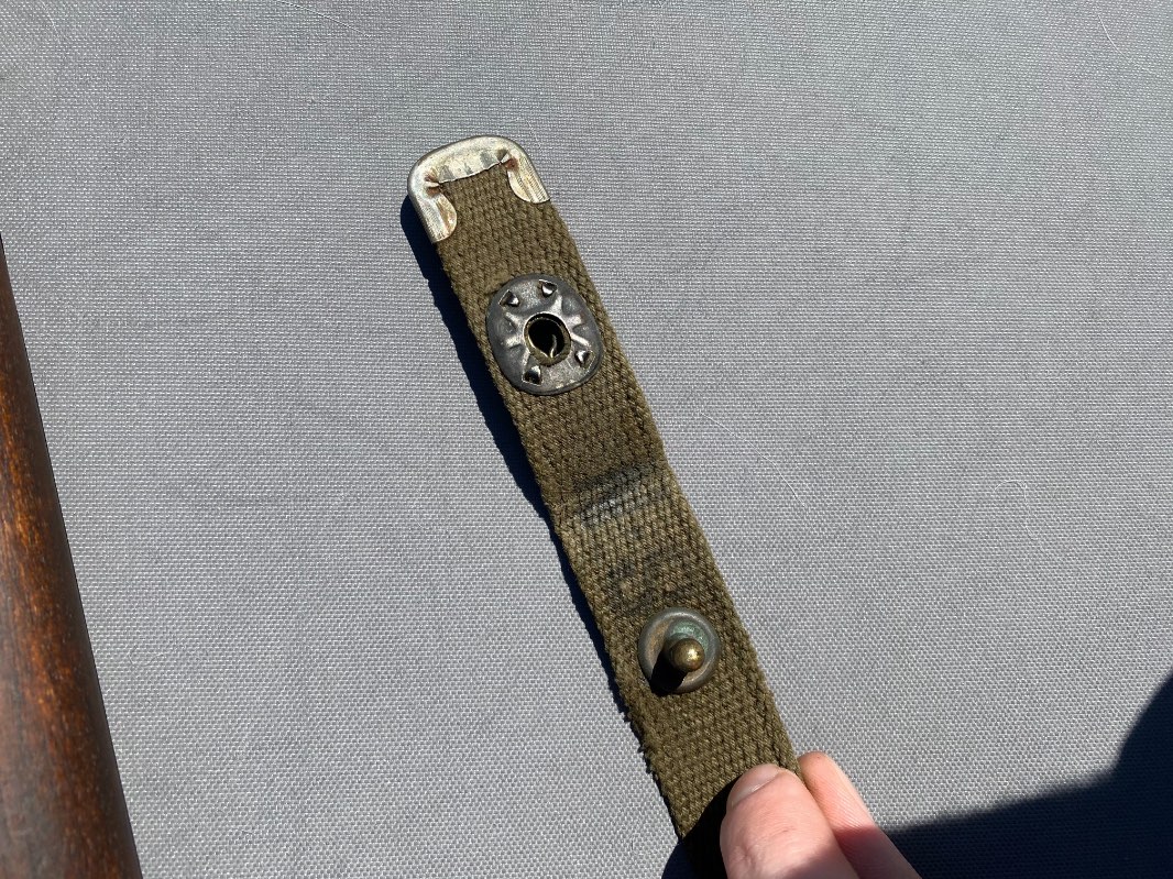

I agree about the cartouches, but still a nice piece. Sling looks good from here. Interested to see what the experts think.
Very nice with a bunch of early features. Those were made in Rochester, NY not far from where I am. The National Postal Meter's buildings are still there but I believe NPM is long gone.   I understand Trimble was a baby furniture maker before the war.

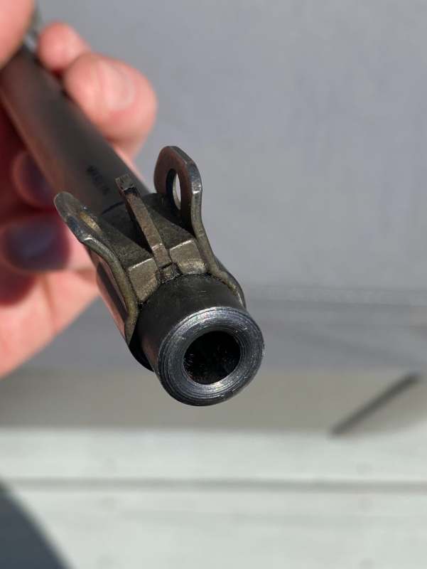

Looks good. Matches the features and markings on my NPM carbine. The Marlin barrel is unique. I couldn't tell from your photos but is there a letter stamped on the heel of the receiver?
Connor Bills
I do not believe so.

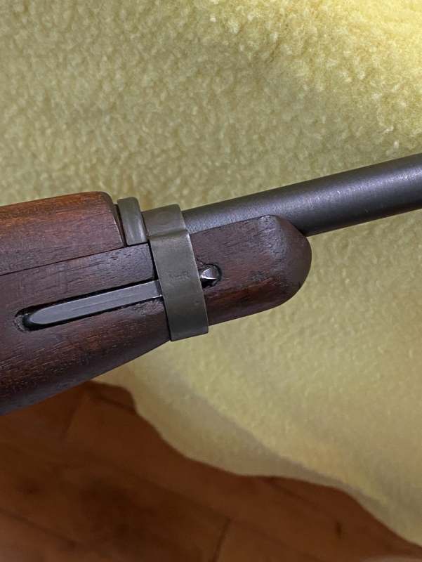

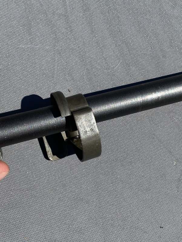

Has a Rock Ola marked front band, Would have to check "War Baby" to see if that may be okay.
Chuck.
Just checked "War Baby", there was no integration of front bands to NPM from "Rock Ola", maybe the "Carbine Club" newsletter has some information regarding this anomaly.
Chuck.
Chuck.
Carbine club members agree that the band may be original to rifle.
Carbine collectors and those who have the books agree that "you can never say never" when it comes to what may have come on a particular carbine during their production period. There have been thousands of anomalies noticed on otherwise correct as expected examples observed over the last 75 years. The "Rock Ola" front band may be original to that particular carbine. It surely is a very fine example of a NPM rifle, it really looks too good.
Chuck.

Agreed. That’s one of the first things to learn when dealing with these

To my eye it is very nice, and looking at the pics I’d say the most wear found anywhere on it is on the buttplate.....it is a pretty crispy example overall, wood and metal bits all have lots of condition. While the cartouches are sharp, so is the rest of it.

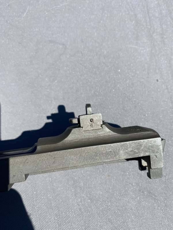

A give away is the cosmoline on flip sight, very nice piece. Have an OOP carbine reference book that has dates of mfg. by month. Using the serial # allotments one can get good idea which week a Carbine was mfg. Years ago when I really collected had all but an IBM. I would buy it unless just crazy price. Know a young collector that bought a presentation M-1 Carbine for under $1500!!
This is not meant to be a criticism of this particular carbine, but, I have been puzzled by the by the upside down "S" on the left side of the rear sight base of several observed carbines. I have wondered if they are post war made, arsenal sights or outright reproductions. Has any one noticed this characteristic [the upside down "S"] on verified, unmolested M1 carbines?
Chuck

I like to see those little imperfections on my Carbines.
The flip sight looks a little bit suspicious to me. If you post over in the CMP site, they will tell you for sure.
Flip sight is golden
