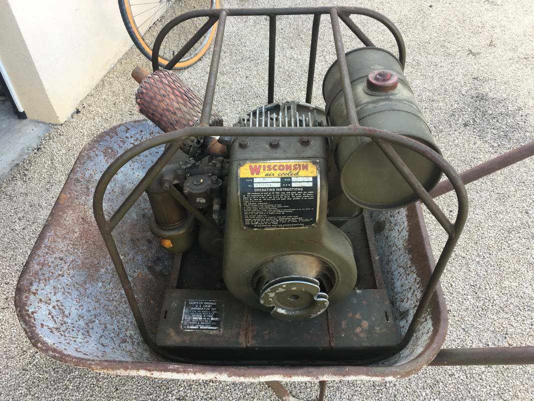

Could you please give me some information about this generator set E-1500 ? It's not currently mine (but it will be soon).
What is its period ? its use ?
Thanks in advance
Bertrand

Hello,
The generator is arrived at home. After a little cleaning, it looks better !
Unfortunately, there is no date on the data plates.
I'm still looking for information about its uses !
Thanks in advance.
Bertrand

SGM (ret.)
The serial number, 474629, puts production of the engine in the 1943-45 range (serial numbers roll over to 500K in 1946 and ran to 300K ending in 1942).  The "D" suffix on the model AK indicates that the engine was equipped with a "stellite" exhaust valve (a high-performance alloy exhaust valve for extreme duty conditions).
It seems like many parts are still available for these engines.
Pitt Auto Parts Catalog for Wisconsin Motors Models AA, AB, and AK
Hope you got it running and working!
