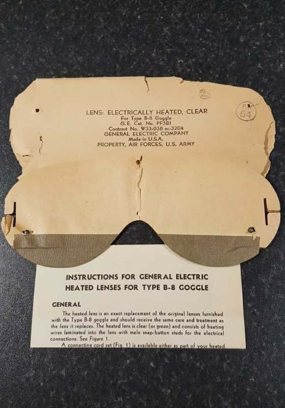

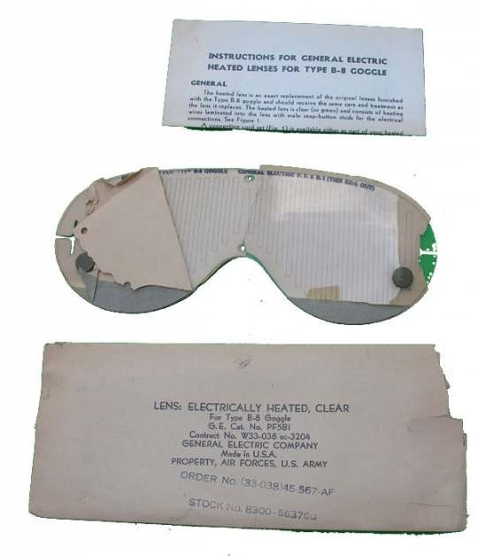

These were shown in another thread recently. I don't have any photos of them in use, other than in a GE ad (see below), but they are definitely of WW2 vintage. The War Supply Contract list shows they were made by General Electric Company in their Bridgeport Connecticut facility, contract number AC-3204, for $390,000, and were produced from June through November of 1944. Listed as "Goggles Lenses" on the page excerpt below. I had a pair years ago (early 1990s) when I collected USAAF, but only have one photo of them displayed. You can see the electric cord and the OD snap on the right section of the lens if you look closely.

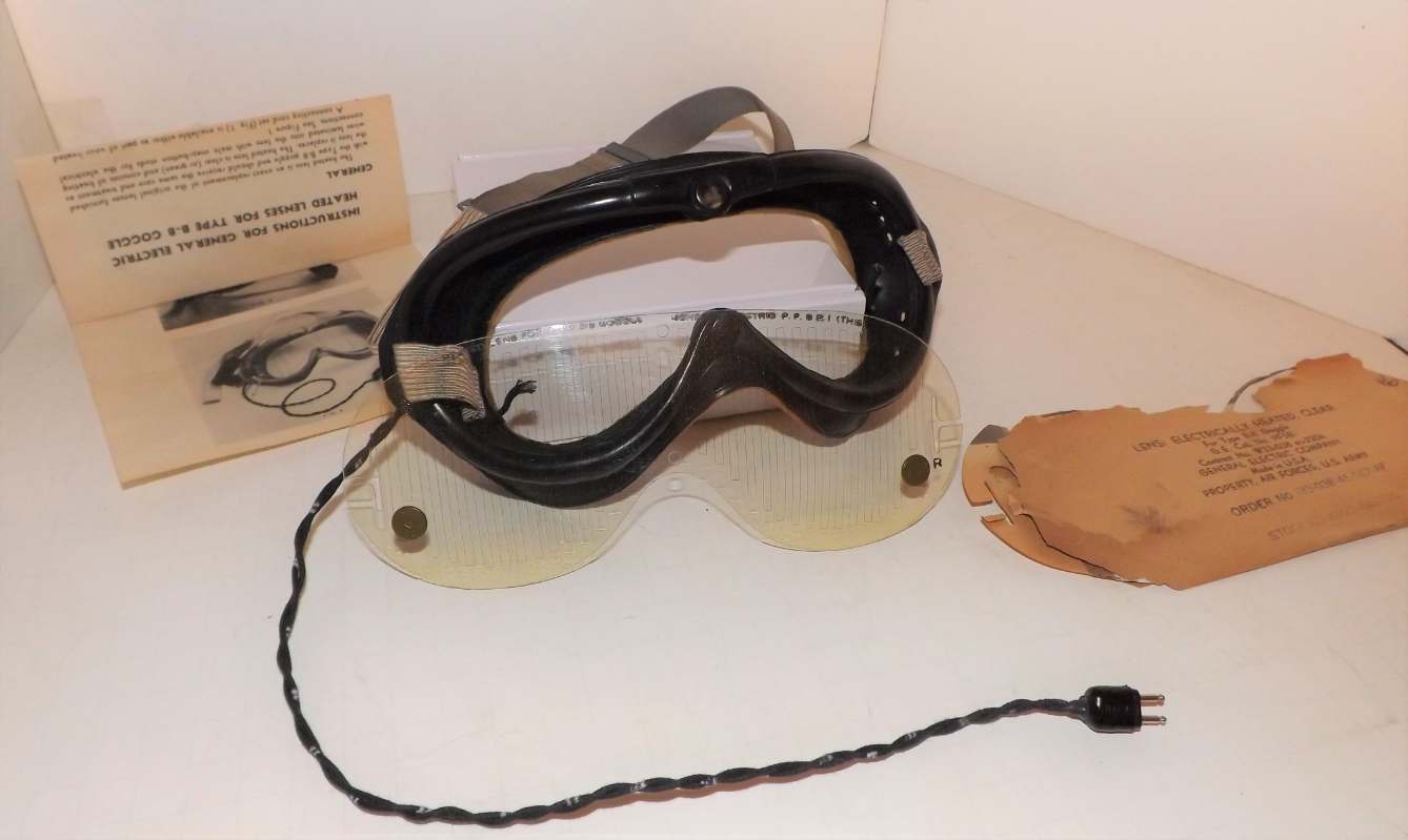

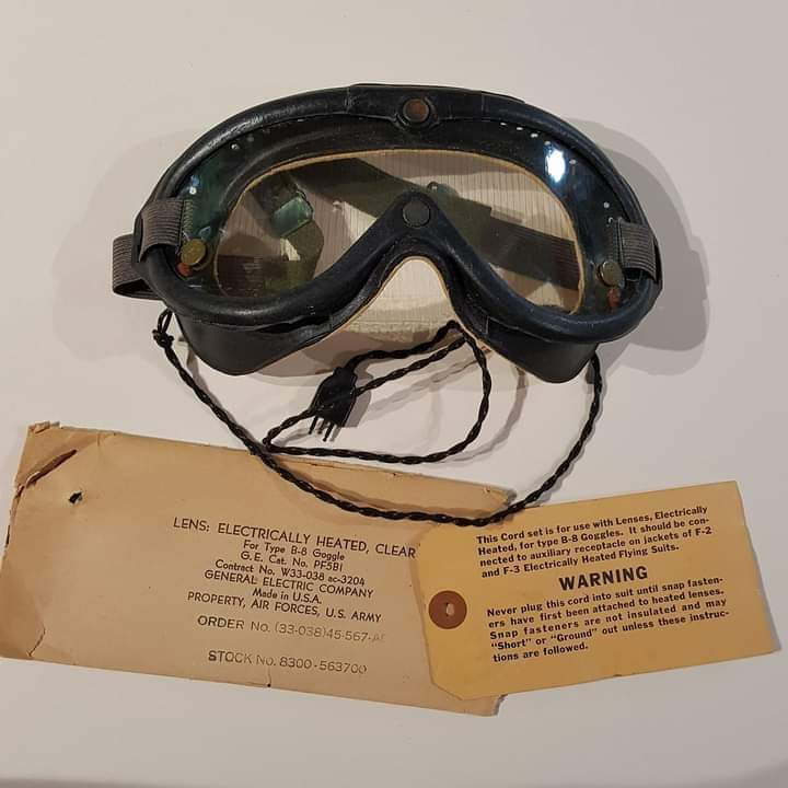

I have several pairs of these. I have been working on a repro power cord.
I made up a cord but am at a stop until I can find some snaps to connect the wire ends to.

Yes I think I have it as far as I can go without the snaps.
