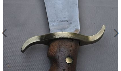

Just guessing that these early ones with no serial are a bit on the Rare side ?
The rivets look different than others Ive seen and no Lanyard hole ?

This Bolo I have looks to be one of the first 236 knifes that did not get a serial number. Compare the hallmarks in the first set of photos of a non serialed Bolo to the Hall marks on mine.
They appear to be the same.
I think I have one of the very first bolos out of the first group of 236 ?
If so, I would imagine that this bolo is extremely rare ?
Also pictured is an early serialed 1904 with No SA Marking.
