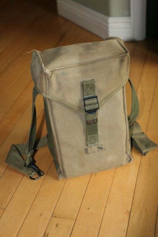

GaryX Posted June 13, 2021 Author #6 Posted June 13, 2021 I have recently seen on ebay a Western Electric 1017D-86418 with green paint like mine, that is, factory applied, inside and out before electrical components were added to the case. This posting, however, included a case with "U.S." printed on the outside. The line tester was not visible in the case, but it appeared to be of the correct size. This is the first I have seen a WE line tester offered with what appears to be a military case for it.
12thengr Posted June 13, 2021 #7 Posted June 13, 2021 The bag shown is an 'ammunition bag'. I don't remember the nomenclature for it. It was used to carry all sorts of things, ammo clips, grenades, even a steel ammo box could be crammed inside. Not unlikely that an enterprising signal corp. man would carry various equipment in it but that's not the bags primary function.
GaryX Posted June 14, 2021 Author #8 Posted June 14, 2021 Thank you, that is good to know. It makes the offering somewhat less attractive than if it were a bag manufactured for the WE 1017 D-86418 line tester specifically. Had it been, the bag would have provided some provenance pointing this tester to military instead of civilian usage.
