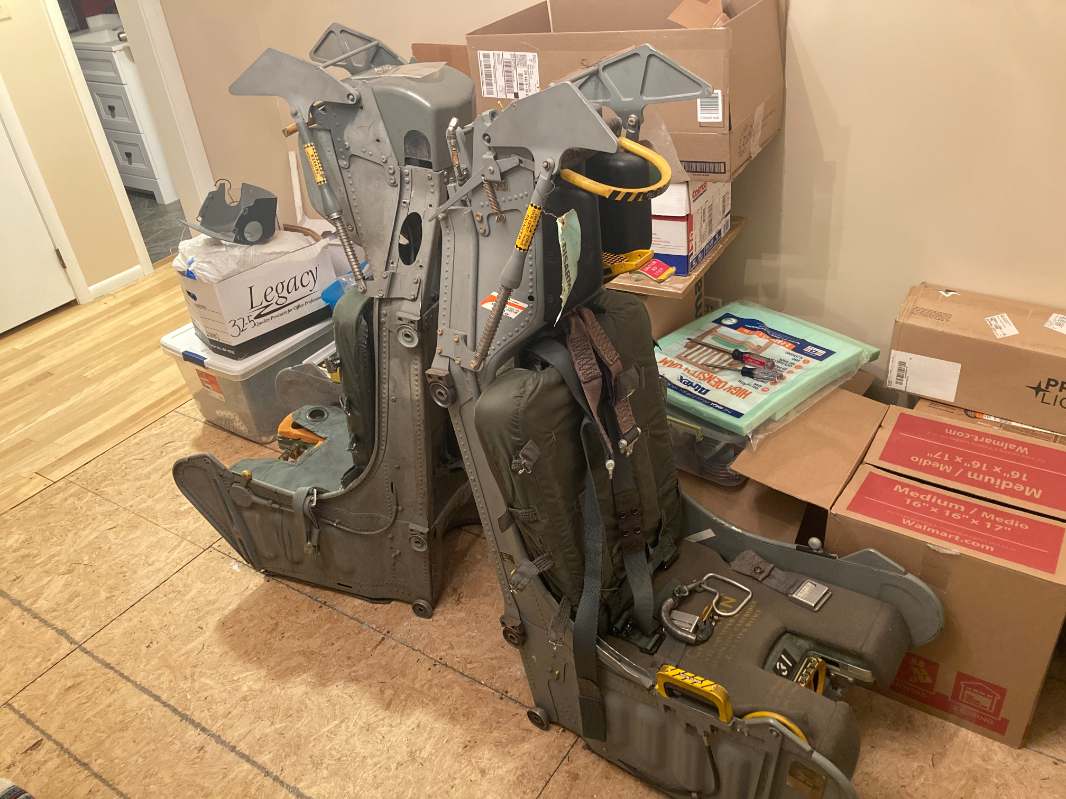

Crow929 Posted November 3, 2020 #52 Posted November 3, 2020 1 hour ago, hink441 said: Could be as you say. I really don’t know the reason the upper handle has two positions. I am learning as I go and it really has been fun. Really need to find the NAVAIR publication in order to really know the purpose. How is your seat coming along? Would love to see more of your ejection seat. Chris Well Chris, my seat project has definately changed a little... Another seat crossed my path that was MUCH nicer than the first, and I just had to take it home. This seat has decent paint, and all the decals look decent too. This seat came with shoulder straps (though they have AF connectors) and they are connected to the inertial reel. For some reason, the reel was installed upside down when I got it. I flipped it over and connected it to the friction lever on the left thigh. Everything works as it should! The seat is marked A-7E, so it was not an AF model. This seat had what I believe to be an older style survival kit, but I think I'm going to swap in the RSSK-8 that locks in as it should with the right thigh release handle. The canopy breakers have the one-way ratchets removed, so I can reset them back to the ready position. There is an inert training "ear burner" rocket installed (not pictured), which is something I've never seen on a seat for sale. I'd like to fabricate a main rocket, but details on those seem slim. The main rocket's part number is 10407-3 I believe. So, now I need to sell the original seat. Maybe I'll see how the office chair modification goes with the first chair and mod this one too. Might increase its attractivness. I'll post more pictures as I get it cleaned up.
hink441 Posted November 3, 2020 Author #53 Posted November 3, 2020 Wow that is great!! I liked your first one and now you have a great second seat! I really look forward to seeing where you go with this one. I think both of your seats look better than mine LOL.

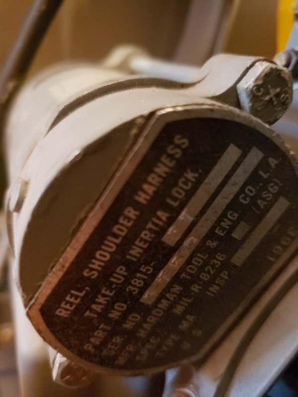

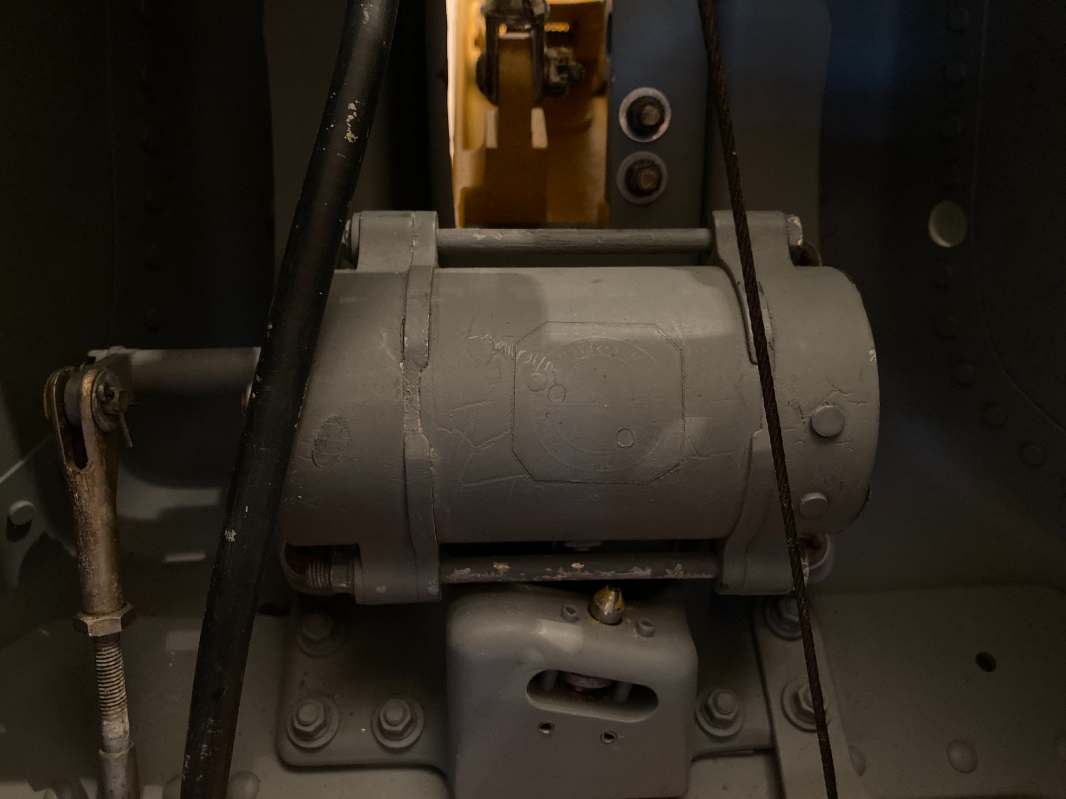

hink441 Posted November 3, 2020 Author #54 Posted November 3, 2020 Can you post a close up picture of your inertial reel? I need to locate one. I would love to see the manufacturer tag on your newer seat. Chris
Crow929 Posted November 3, 2020 #55 Posted November 3, 2020 20 minutes ago, hink441 said: Can you post a close up picture of your inertial reel? I need to locate one. I would love to see the manufacturer tag on your newer seat. Chris https://www.flighthelmet.com/product/EJSP-1522.html I think that might be the same one, but I'll post a close-up of the one on my seat later for you. The one pictured from the flighthelmet link is missing the latches on the end of the straps.
Crow929 Posted November 3, 2020 #56 Posted November 3, 2020 I had a difficult time getting good pics, but here is what is installed in my seat.
hink441 Posted November 3, 2020 Author #57 Posted November 3, 2020 Those are perfect! Thank you for taking those pics they helped out a lot! Chris
mohawkALSE Posted November 4, 2020 #58 Posted November 4, 2020 That new seat of yours looks to have the USAF CNU survival kit. Can see the Air-Lock quick release fittings for the survival kit rings on the USAF torso harnesses.

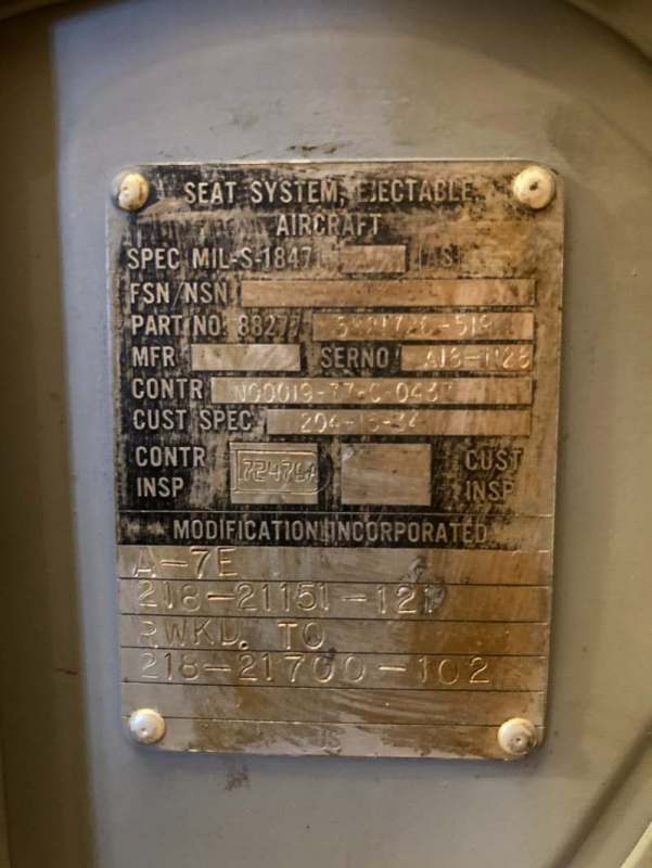

Crow929 Posted November 5, 2020 #63 Posted November 5, 2020 The latest one was in Kentucky, but the parts are quite mis-matched so I can't say with any confidence it could have been an ANG seat. The nameplate on the seat itself is marked A-7E, but like it was discussed I can't say if the D model planes used the exact same seat as the E.
hink441 Posted November 5, 2020 Author #64 Posted November 5, 2020 9 hours ago, Crow929 said: The latest one was in Kentucky, but the parts are quite mis-matched so I can't say with any confidence it could have been an ANG seat. The nameplate on the seat itself is marked A-7E, but like it was discussed I can't say if the D model planes used the exact same seat as the E. Regardless it is still a great looking seat that has great potential!! On your manufacturers tag, does it have a contract number, and are there any rework stickers on the seat? Could you get a picture of the tag? I think that should show which service used your seat. If it is an USAF seat you could restore one to Navy use and the other to USAF use!! Chris
hink441 Posted November 5, 2020 Author #66 Posted November 5, 2020 With my limited knowledge of contract numbers, I believe that is a Navy contract number from 1977. Chris

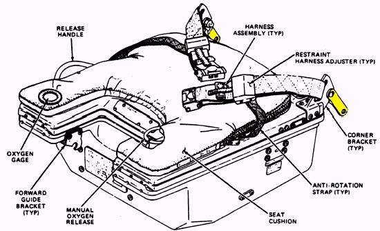

Crow929 Posted November 6, 2020 #67 Posted November 6, 2020 The non RSSK-8 seat doesn't have the rectangle tabs in the back (highlighted in yellow). Any idea how the container would connect to the seat frame? My seat has a set of pins that hold the tabs of the container in place, pulling on the escape lever releases these pins as well as the pin holding the shoulder straps to the inertia reel. It looks like the intention is for the RSSK-8 lid to remain on your butt while the rest hangs off, which makes sense as the oxygen is in the lid. The lap belts on the other container release from the container, so the lid would no longer stay on your butt. I never realized making an office chair ejection seat would make me so educated on how these seats work. This is fun!
hink441 Posted November 7, 2020 Author #68 Posted November 7, 2020 I am unable to offer any ideas about the non RSSK-8 seat kit. I have no idea how it would be secured to the seat. Seems to me it might possibly have been put together by a collector at a later point in time. I have a thought about your two seats. I know these are your seats and you can do what you like with them, but I would take the NES-12 and the RSSK-8 and put them in the seat that is marked for the A-7E. The other unmarked seat would get the USAF seat kit and other gear. You would have two great looking seats one representing both the USAF and the USN. Chris

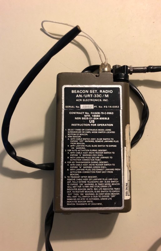

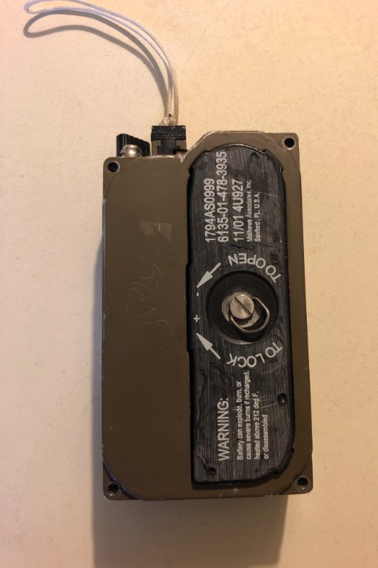

hink441 Posted November 12, 2020 Author #71 Posted November 12, 2020 Just got a beacon for the seat. Pretty cheap on eBay. This one is a URT-33C but it will work well for display purposes. Still need to find the pull lanyard.

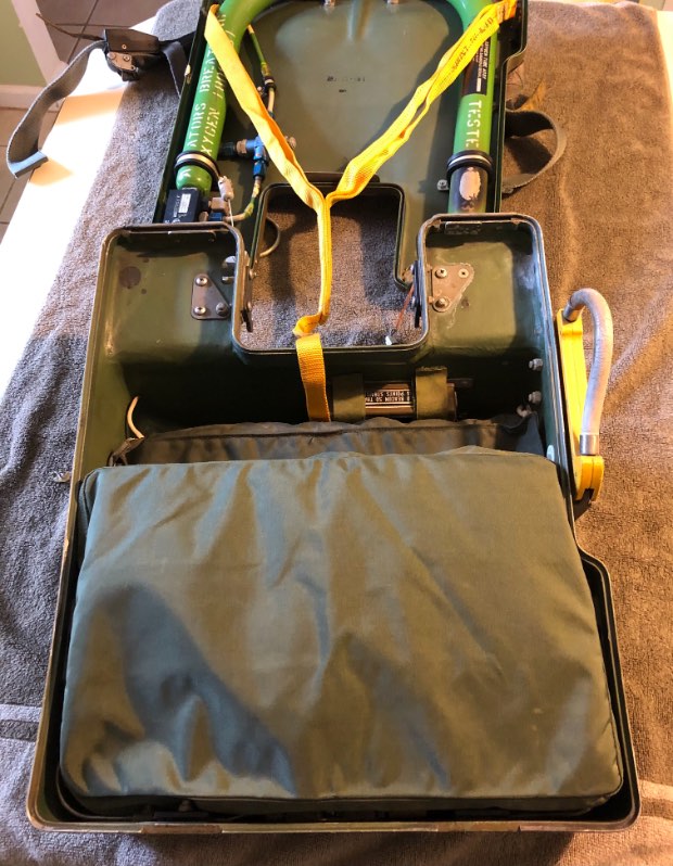

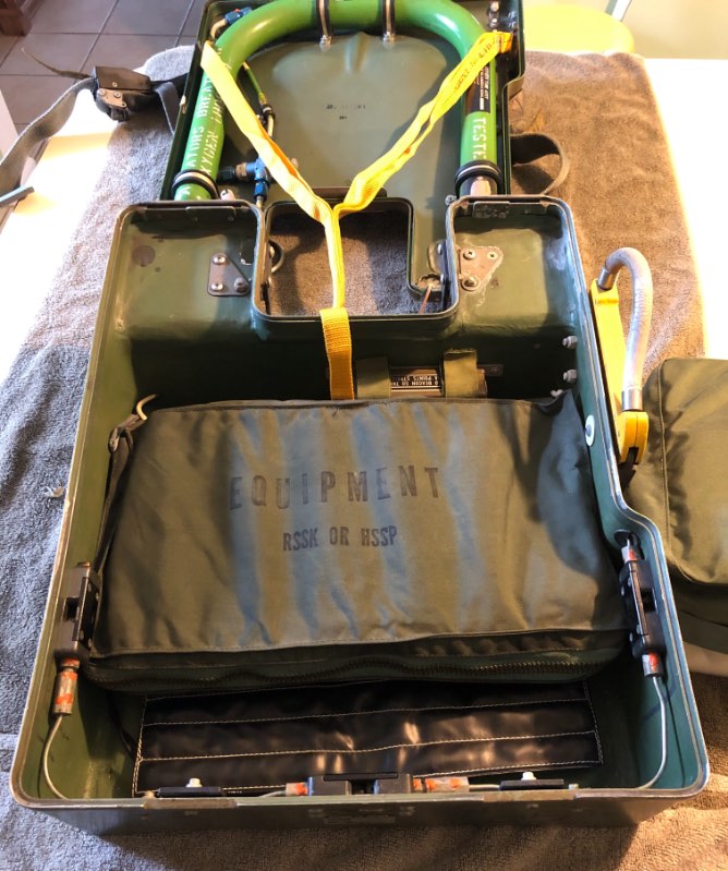

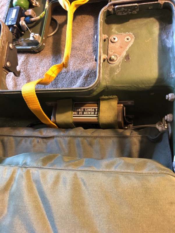

hink441 Posted November 13, 2020 Author #72 Posted November 13, 2020 I now have the beacon partially installed. I still need to get the lanyard assy. I also have the equipment bag and the life raft cover installed. It is a tight fit. The equipment bag and the raft cover are filled with foam. The first picture shows the equipment bag in the bottom of the seat kit. The second picture shows the life raft on top of the equipment bag. The last picture shows the beacon. I am kind of guessing how the bag and cover are situated in the seat kit but it seems to fit.
Crow929 Posted November 13, 2020 #73 Posted November 13, 2020 Wow, that looks great! Is your O2 bottle connected to the lines that run to the back of the seat? Any way of knowing if the beacon still works? (and is it legal to activate?)
hink441 Posted November 13, 2020 Author #74 Posted November 13, 2020 Thanks, the O2 bottle is hooked up and it runs to the rear of the seat. The beacon (URT-33/C) has an outdated battery, so I don’t know if this one still works. I have a PRC-90 radio that has a good battery and it still works. As far as legal to operate the beacon, I live nearby to NAS Oceana and they monitor the “Guard” frequency so I wouldn’t try it. I have turned on the PRC-90 for a momentary operational check but I don’t leave it on for long. The frequency is 243Mhz.
