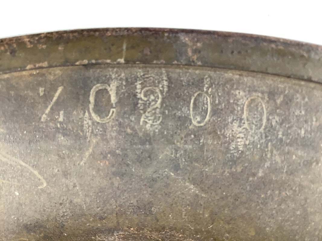

Fiziwater Posted April 26, 2024 #9 Posted April 26, 2024 For posterity, here’s an example I have of a pretty legible ZC. It would be nice if these codes were eventually decoded.
Fiziwater Posted April 26, 2024 #10 Posted April 26, 2024 I was able to find on an .eu forum that this helmet was made by Columbian Enameling and Stamping Company, of Terre Haute, Indiana, and produced 268,850. Don’t know the dates of the production run, though.
aef1917 Posted April 26, 2024 #11 Posted April 26, 2024 C is not Columbian. That's a piece of errant speculation that has spread far and wide over the internet.
Fiziwater Posted April 27, 2024 #12 Posted April 27, 2024 I saw further information claiming that. Back to square one.
