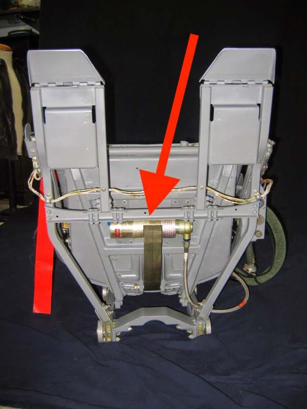

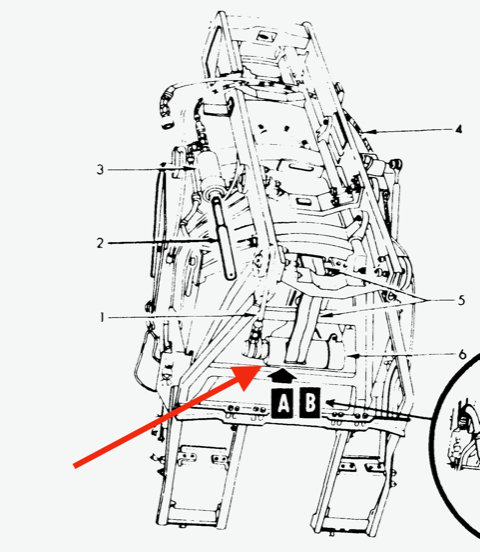

I've posted before - I'm restoring a T-33 ejection seat. For the variants that have a man-seat separator, does anyone know the nomenclature, manufacturer, part number or any other identification for the associated rotary actuator?
I restored a T-33 seat rescued from the AMARC boneyard years ago.  I'm still looking for - and sometimes finding - parts for it to this day.  I cannot help with the nomenclature, but do see a rotary actuator for a bang seat here - https://www.flighthelmet.com/product/EJSP-1501.html.  Unfortunately, I don't think it is of the type you are looking for.  Sorry I couldn't be more help, but good luck with your restoration!

opus5150 -
Thanks so much for your input.  Yeah, I saw that one also but simply based on appearance it doesn't quite seem to be what I'm looking for.  I have a distant friend with a totally complete seat ( a seat used for training rescued from trash when our T-33 unit was being decommissioned) who will be getting me the number eventually.  He has his seat in storage and just needs to find the time to get to it.  Thanks again!

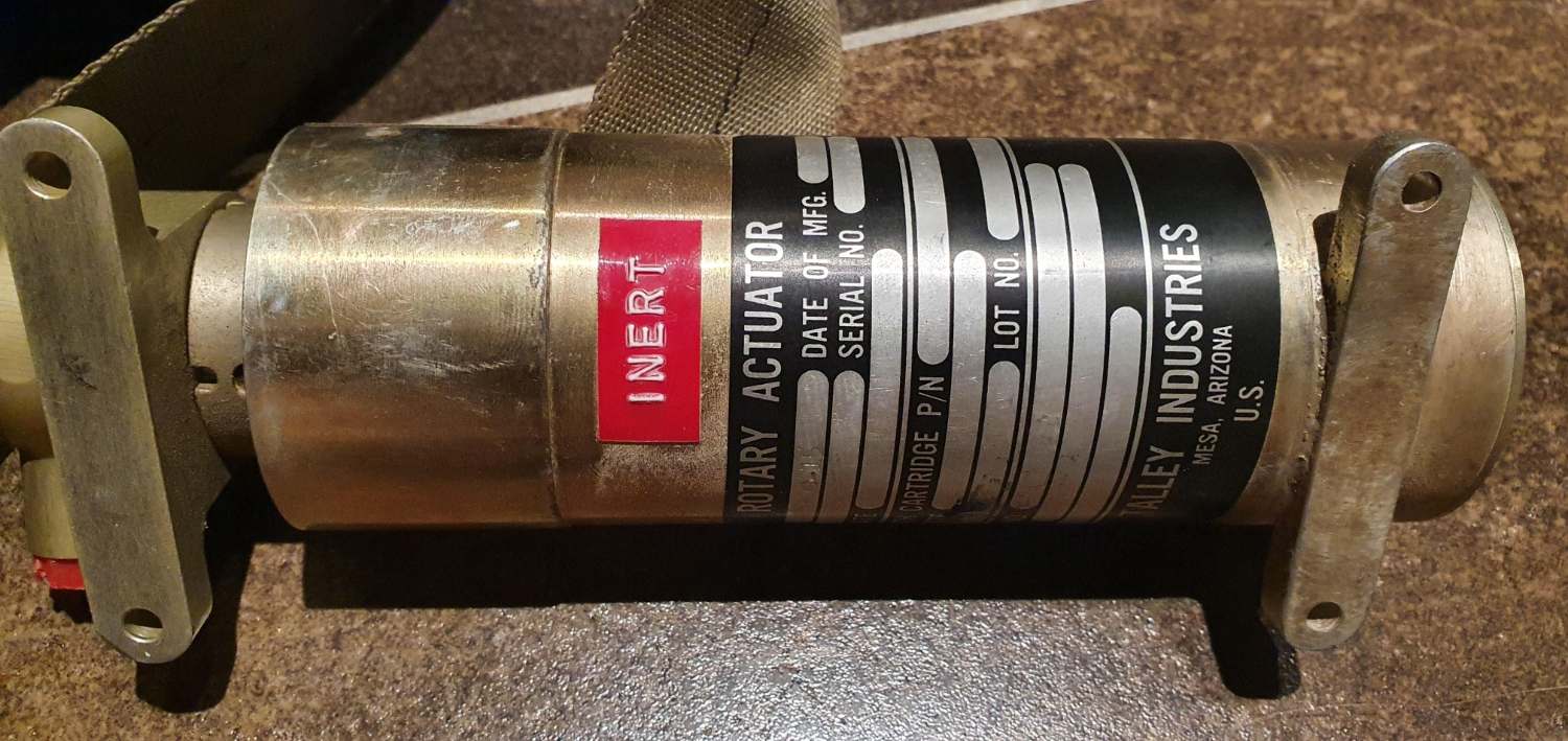

Finally found more info - can anyone help locate one of these?  Nammo Talley Industries P/N 1000-39 rotary actuator, NSN 1377-00-891-6315
the P/N 1000-15 would also be fitting the T-33 seat. It differs from other types in having a longer strap from actuator to the Y split.
20201125_185239.jpg.0320fce969dc348ba9db5f6ca7ea6784.jpg20201125_185423.jpg.417194caed526c19dc9c0efeecc96fc8.jpg
Thanks HUD69.  Yes, I discovered that the 1000 series were apparently all the same with the -xx designator only affecting the attached strap.

Hi Ron -
Didn't get around to it, but just a couple weeks ago a very kind individual donated to me a new inert 1000-39!
Thanks for all the suggestions/help.  I finally (after a decade-long search) have the rotary actuator I need.
Great! Please show us the result!
Still in the final stages of acquiring parts - I anticipate starting actual restoration late this fall.  Nevertheless, here's the actuator:
