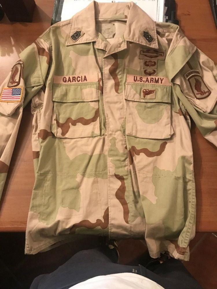

Roby Posted March 16, 2020 #1 Posted March 16, 2020 Hi all, I've just found this DCU but it looks weird to me. It has a combat jump but there's no SGM Garcia on the jump manifest for 2003 jump, just a SPC and a SGT. Moreover I cannot find any info about a SGM Garcia in 173rd airborne. Any opinion?
RedLegGI Posted March 17, 2020 #2 Posted March 17, 2020 Hi all, I've just found this DCU but it looks weird to me. It has a combat jump but there's no SGM Garcia on the jump manifest for 2003 jump, just a SPC and a SGT. Moreover I cannot find any info about a SGM Garcia in 173rd airborne. Any opinion? Step one would be to flip it inside out and see if the stitching on the all the patches match. If they all match with the same stitching, you're probably legit. I get the feeling that Garcia may have a hyphenated name, but just goes by his last of Garcia. There is a Master Sergent Mendoza listed on the jump roster who could have been a SGM by the time 2005 rolled around. But that stretch would mean that his name would have been Mendoza-Garcia or Garcia-Mendoza because the Army may have only used one of his names. Secondly, his name could have been misspelled or omitted from the jump roster. I have a top from the Jump where the guy's name was misspelled on the roster, but I have matching pictures of his uniform top, to his time in northern Iraq. I think it is a legit uniform.

TheMariner Posted March 17, 2020 #5 Posted March 17, 2020 How can you tell they have a combat jump? Star on the paratrooper wing, its hard to make out but I see it in the images!

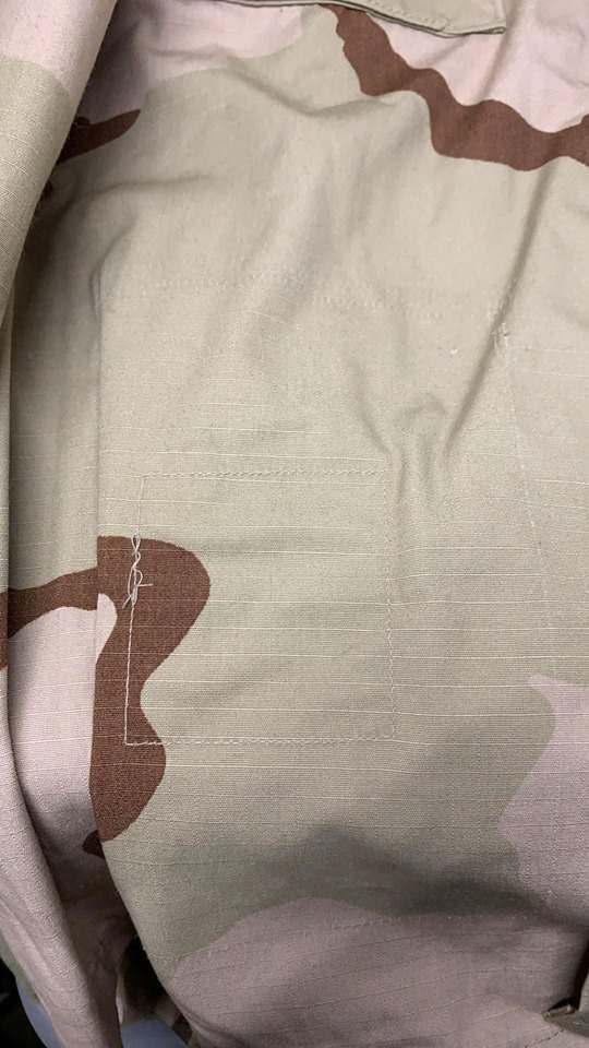

Longbranch Posted March 17, 2020 #7 Posted March 17, 2020 This DCU is configured like the ones used in the 173rd's OEF deployment to Afghanistan in 2005. Consequently, for this to have belonged to a vet that performed the combat jump in Vietnam in 1967, he would have to have at LEAST 38 years of service and be in his late 50s. Just doesn't seem likely. More likely he served in a unit that jumped into Panama, or was in on the 2003 jump with the 173rd. The jacket is kinda odd... it looks to be an older non-ripstop version made from the heavier fabric like used with the DBDUs. It also looks like it still has loose threads from where the lower pockets were removed. If this one is legit, it was likely rarely worn. All of the legit DCUs I've seen from this deployment were the lighter weight ripstop versions, which would have been readily available by 2005. Don't get too hung up on mismatched sewing on the patches/badges, especially in cases where combat badges/patches could have been added. I've seen many examples of 100% legit DCUs with mismatched stitching on the name/branch tapes and badges, and even some different stitching for the FWTS patch and combat-related badges earned while still on deployment. Personally, I'd be skeptical of this one. But if it was cheap and came from a good source (surplus store, garage sale, etc.) it would be worth looking into.
Ewart Posted March 17, 2020 #9 Posted March 17, 2020 If it was legit could it be the Sgt Christopher Garcia seen on the manifest? I have some higher ranking Sgt BDU's/DCU's that I've really struggled to find bar a quick mention on together we served. This one doesn't appear to have been laundered much as you can still see the stitch marks on the lower of the jacket, but from the picture I can not see any discolouration. The stitching on the tapes, ranks and qualification badges seems ok from this angle.
Martinjmpr Posted March 17, 2020 #11 Posted March 17, 2020 If it was legit could it be the Sgt Christopher Garcia seen on the manifest? I have some higher ranking Sgt BDU's/DCU's that I've really struggled to find bar a quick mention on together we served. This one doesn't appear to have been laundered much as you can still see the stitch marks on the lower of the jacket, but from the picture I can not see any discolouration. The stitching on the tapes, ranks and qualification badges seems ok from this angle. SGT as in "buck sergeant" or E-5? Considering that the combat jump was in 2003 and the DCU had been replaced by the ACU by ~ 2006 or so, that doesn't seem possible. E-5 to E-9 in two years isn't possible. Even E-7 to E-9 would be a stretch - he'd have to be a real stud to make E-8 and 9 that fast.
Baron3-6 Posted March 17, 2020 #12 Posted March 17, 2020 One oddity is a SGM in an Airborne unit not being a Master Parachutist or at least senior parachutist....not saying this is a total red flag, but it's very odd. Airborne Infantry are usually a very tight community - very, very odd to see a guy this senior without more jumps, especially this early in the GWOT.

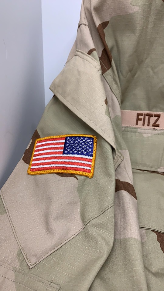

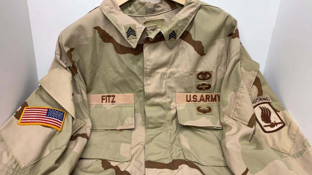

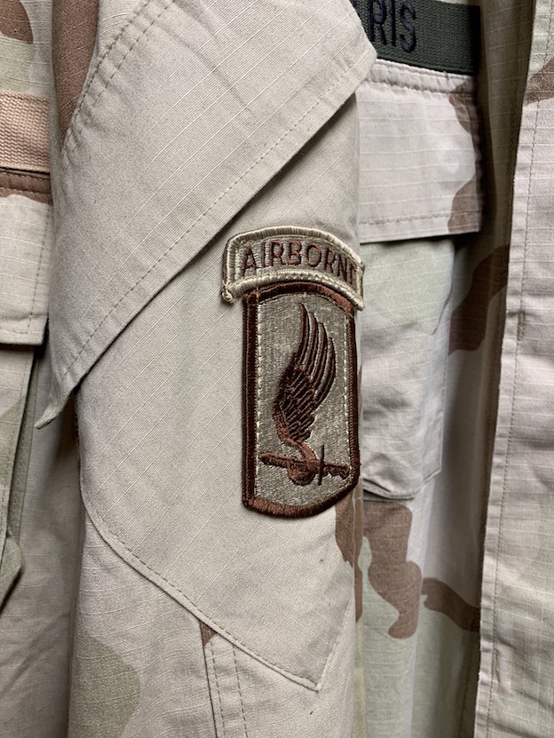

RedLegGI Posted March 18, 2020 #14 Posted March 18, 2020 Here is my top. Baron and I were discussing a few subtleties on the top posted and he asked me to post some of my pics.
Baron3-6 Posted March 18, 2020 #17 Posted March 18, 2020 Here is my top. Baron and I were discussing a few subtleties on the top posted and he asked me to post some of my pics. 90524216_2521098911490055_7971960270656372736_n.jpg 90138004_549819962304569_5697584609919762432_n.jpg Thanks RedLeg! If you notice....the sleeve pockets are sewn flat...and they're like that on every 173rd mod I've seen. I've read these were all done at the same Italian sewing shop off post, so they all should look similar. That being said, the pockets on yours do not look like they are done in the same manner. All factors considered, I would not feel comfortable buying this as a real 173rd 2005 Mod.

Roby Posted March 18, 2020 Author #21 Posted March 18, 2020 Thanks to all for your precious answers. The seller is saying that he exchanged the shirt in Caserma Ederle in Vicenza with some Italian stuff (he was providing some services for the base so he had many contacts with the soldiers). I asked him about the condition and he answered that is almost new. However there are too many red flags on this (no SGM Garcia identified, basic wings for a SGM, odd pocket modification, pretty new condition), I think I'll pass on this. I attach some pics of another 173rd DCU from my collection with the same pocket modification of RedLegGI's DCU
