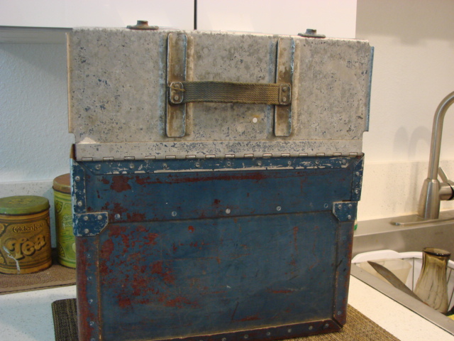

Early WW2 bomber ammo box
I know this is an early WW2 bomber .50 cal ammo box. What is throwing me is the paint. I know this is US Navy medum blue as seen on the tri colored aircraft flying in 42-43. A PB4Y or PBY would of had box's like this, but did the Navy paint them or is this some sort of post war garage job? Note the paint is sprayed and at one time the lid was also painted, but that has worn away. My first thought was to remove the paint, but I think I should wait for opinions.

I would not touch it. From an Ordnance view, a few points. The blue looks like Fed Standard blue, which denotes target practice. Frangible ammo was used in aerial gunnery training. Frangible rounds may have had a different FS color, not sure. More likely, be aware blue tipped ammo denoted incendiary rounds. The assumption it is incendiary rounds has certain problems also, not sure if the Air Corps or Navy linked all incendiary, it usually was a blue, black, red mix ( incendiary, AP, tracer) depending on the mission. The Army rarely issued blue tip ammo to ground troops, it was solely Navy / Air Corp ammo. Finding Navy, Aerial gunnery TMs will lead you to a definitive answer.

That is interesting! I did not know that. Thanks!!

I just started looking, but I think your on to something.

That was along the lines of what I was thinking, but let me cover why this is an early bomber ammo box and why what I really think may be correct. Very early in the war ammo chute feeds didn't cover all areas as seen in this photo. Waist gunners and nose gunners had ammo box's with no adapters for chute feeds because they didn't have chute feeds. Ammo fed directly out of the box to the M-3. In the early days the box's only held 200-250 rounds. If you burned up your ammo you would pull out of another box and reload your main box. That is why the last box I posted has rollers to guide the link ammo out and the other box has nothing. As the war progressed the box's got bigger and bigger and ammo chute feeds were throughout the bomber. Later ammo box's had hook ups to connect the feed chute.

Now back to the early box's. This only held 200 rounds. 200 rounds is gone in a flash. It seems to me during this period of time it would be prudent to have box's that held different types of ammo for different targets. Incendiary rounds as stated do a great job of causing fires. So if you are going to hit a fuel laden target this would be a good round. The line up of what rounds were placed in a belt was developed over time. I think it possible in the early days they may have been experimenting with what worked best and that blue box could be how they knew at a glance what they were shooting. I have no proof of this. I'm just looking for a reason why that box may be blue. If anyone has anything solid, please share.
