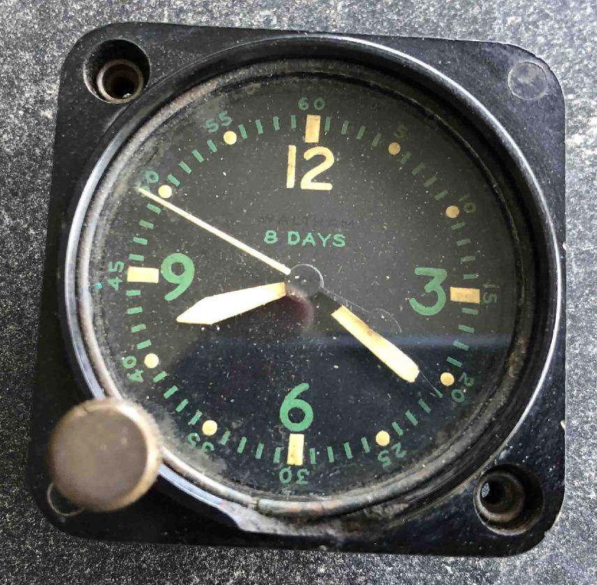

I think this one is WWII vintage. The knob is broken off which really sucks... Also, the numbers and hands glow which I assume means it's got radium paint on it??

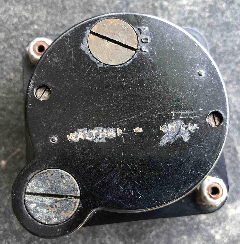

Here is a photo of the back:

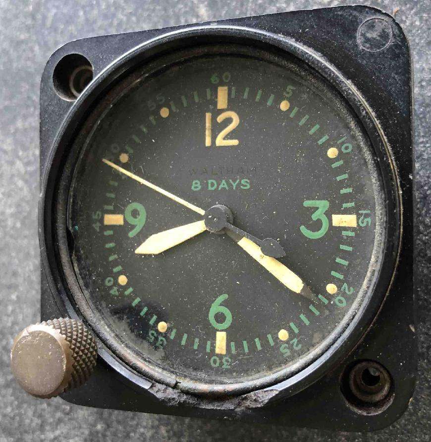

This is the newer one. While the knob is there, it has a chunk broken off the bezel. That's too bad but like I said, at $20 I didn't feel too bad about buying them :)

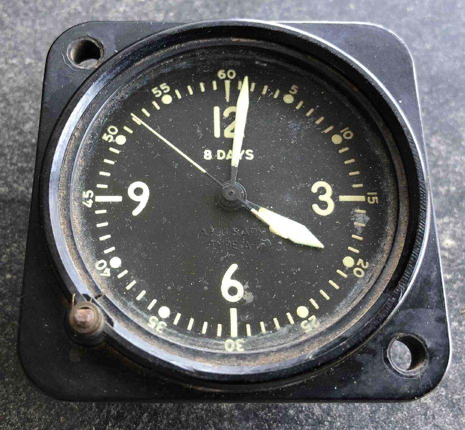

Hey Dave, I Can't speak as to why people collect these, but they do. This is mine. Many people collect watches and clocks, these are cross over items. That tics up the demand for them beyond them only being military collectables. For the military aviation collector these are beyond cool. Different clocks flew in different aircraft and that could be a draw to collect each type or just for one type aircraft. They are old school and need no electricity, odds are they were flown and after 80 years they keep very good time. Tens of thousands of all types were made during the war, but time has taken its toll and only so many survive today. Of all the things one could collect very few of them have the ability to give the kind of satisfaction that a working clock gives every day. If someone could find a case of these and flood the market the price would drop a little bit then climb back up. The demand for these is strong. Supply and demand dictates market price. That's just my two cents
