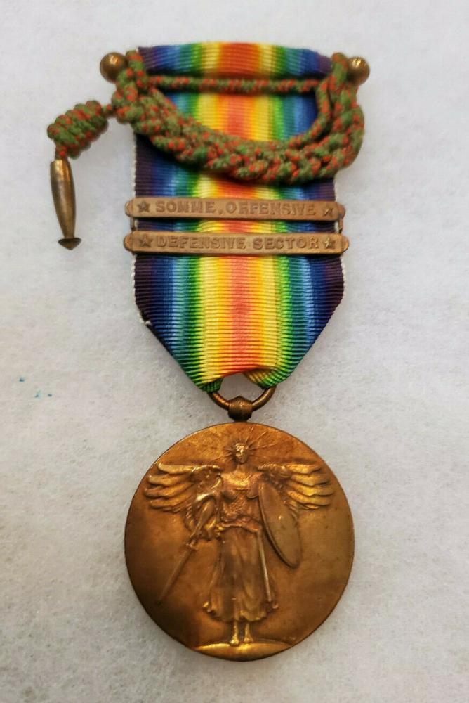

Militiaman Posted November 28, 2019 #1 Posted November 28, 2019 I’ve never run across this before. Were these awarded this way or is this a vet modification? Thanks! Rob
Bruce Linz Posted November 28, 2019 #2 Posted November 28, 2019 Very cool Victory Medal. It is a veterans modification. There are photographs of men wearing just the miniature fourragere by it self.

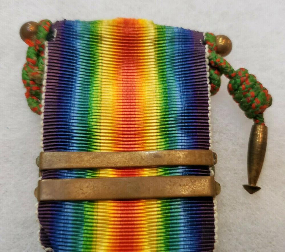

Militiaman Posted November 28, 2019 Author #3 Posted November 28, 2019 Thank you for the info! The reverse, for those with interest. Rob
teufelhund Posted November 28, 2019 #4 Posted November 28, 2019 This is a non regulation way to wear the miniature of the " croix de guerre" fourragère. The CdG is usualy a collective award to a specific unit such as an entire regiment. Sometimes the CdG can be bestowed individualy to a single person and consequently the miniature may be unoficially worn on the Croix de Guerre medal, but not on a Victory medal.

TheMariner Posted November 28, 2019 #6 Posted November 28, 2019 I am going to be the one to make the unpopular opinion here, that ribbon looks oddly fresh to me maybe it is just the lighting but I would not put it past someone putting one of these back together to add that in hopes it adds more value! More images of the stitching and in different light would be needed to say for sure!
teufelhund Posted November 28, 2019 #7 Posted November 28, 2019 Furthermore, there are no WWI Victory medal that only have the 2 battle clasps Somme offensive & defensive sector affixed to it For the 33rd DIUS the MEUSE-ARGONNE clasp is missing in addition to SO & DS. For the 27th & 30th DIUS the battle clasp YPRES LYS is missing in addition to SO & DS But the Ypres LYS clasp is a rey scarce and sought after.
Militiaman Posted November 28, 2019 Author #8 Posted November 28, 2019 Ah, that makes sense. It’s an eBay special. I just ran across the cord and haven’t seen one on a medal before. Great info, as always. Thanks! https://www.ebay.com/itm/293352783885?ViewItem=&item=293352783885 Rob
mortarman Posted November 30, 2019 #9 Posted November 30, 2019 Furthermore, there are no WWI Victory medal that only have the 2 battle clasps Somme offensive & defensive sector affixed to it For the 33rd DIUS the MEUSE-ARGONNE clasp is missing in addition to SO & DS. For the 27th & 30th DIUS the battle clasp YPRES LYS is missing in addition to SO & DS But the Ypres LYS clasp is a rey scarce and sought after. I have a question about the awarding of clasps to the World War One Victory Medal. If the soldier was wounded during the Somme Offensive and was not present at the other battles, wouldn't he have received (and been entitled to) a medal with only Somme Offensive and Defensive Sector? Or were the medals awarded based on the unit in which they served?
mars&thunder Posted November 30, 2019 #10 Posted November 30, 2019 Those two bars are appropriate as the full compliment of the 304th Tank Battalion, so there are several ways (to included wounded as already mentioned) to get to that pair of bars.
teufelhund Posted November 30, 2019 #11 Posted November 30, 2019 To my knowledge, the 304th Tank Battalion of Col Patton had not been engaged in the Flanders ( Northern France & Belgium) The 304th was equipped with light french FT17 Renault Tank and saw action during the Saint Mihiel and Argonne Meuse offensive, and deserved the corresponding battle clasps. To the contrary , the 301st tank Corps ( Heavy tank) was equipped with british MKV tank and were engaged in the battle of Bellicourt-Bony-Le Cattelet on Sept 29, 1918 in support to the 27th & 30th USID and UK & Australian troops. Members were autorized to wear Somme Offensive & Defensive Sector clasps.

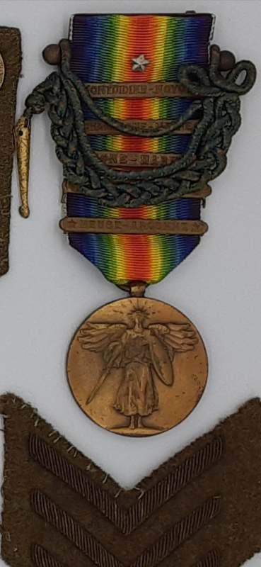

skipusmedals Posted June 2, 2025 #17 Posted June 2, 2025 I have one as well this one was to a cpl Drob in the 26th regiment
