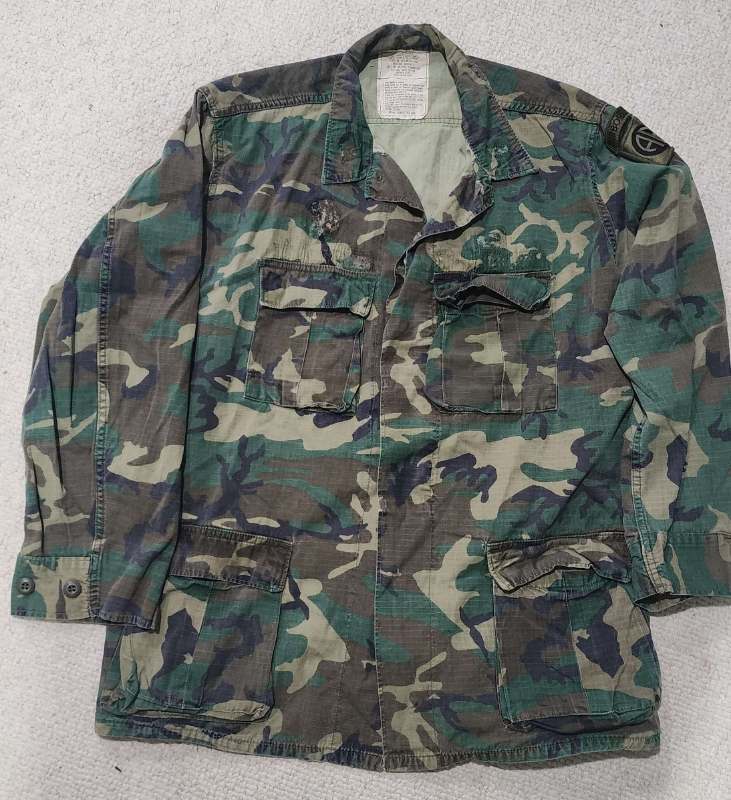

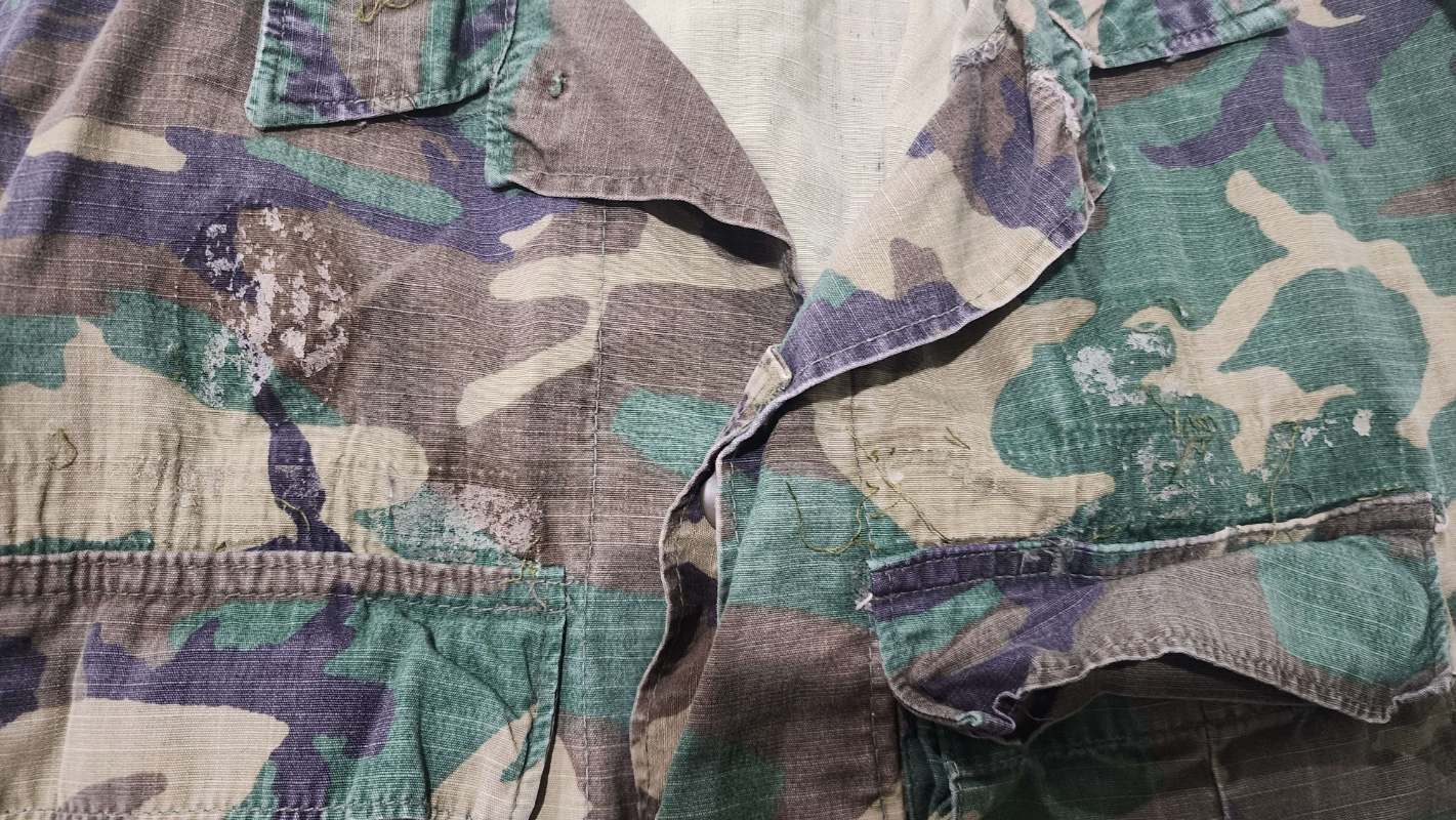

Curious if someone can help me. I got this 82nd Airborne RDF top and there's patch glue and an oval patch shadow over the name tape. Of all the badges I can think of, the German Proficiency Badge seems to be the one that'd be most likely to be there, considering its size and shape. That being said, it's usually a metal badge and I can't say I've ever seen a patch variant of it, let alone it being worn on fatigues. Would anyone be able to chime in and help solve what it may be? Thanks!

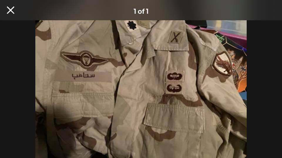

2003 French Commando School qualification badge being worn in iraq. This was posted by a collector on the "desert camo book" fb page.

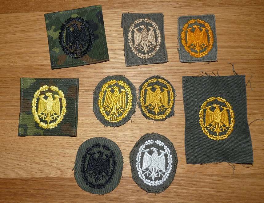

20250505_184135.jpg.17188da92093b42bd4ec546c230eaad8.jpg20250505_184141.jpg.3923c2bfcc3b29be91682992831f438d.jpg
German Proficiency Badge was my first thought as well. Usually these are worn on the left breast pocket but I have seen photos of U.S. soldiers wearing them above the right pocket on their class A uniform. As you can see countless cloth variations for the BDU do exist as well.
When I was in (2010s)  this badge was so common to see. They would throw events in the states and even me being in a regular engineer unit had the opportunity to earn it.
Thank you for the input, glad to finally have the answer, or at least the most likely answer!
