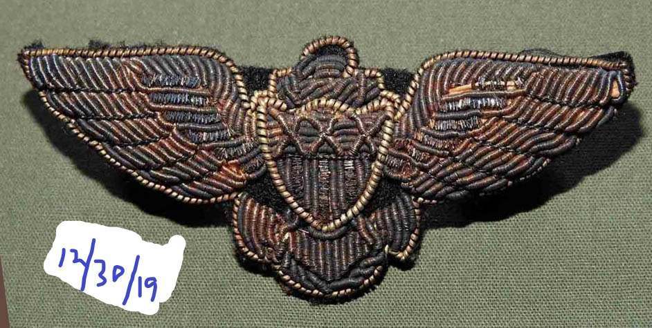

cleaning bullion embroidery, I cracked the mystery!
Maybe rinsing the piece with water that has diluted baking soda in it would nullify any remaining acid?
Then rinse with clear water last step?

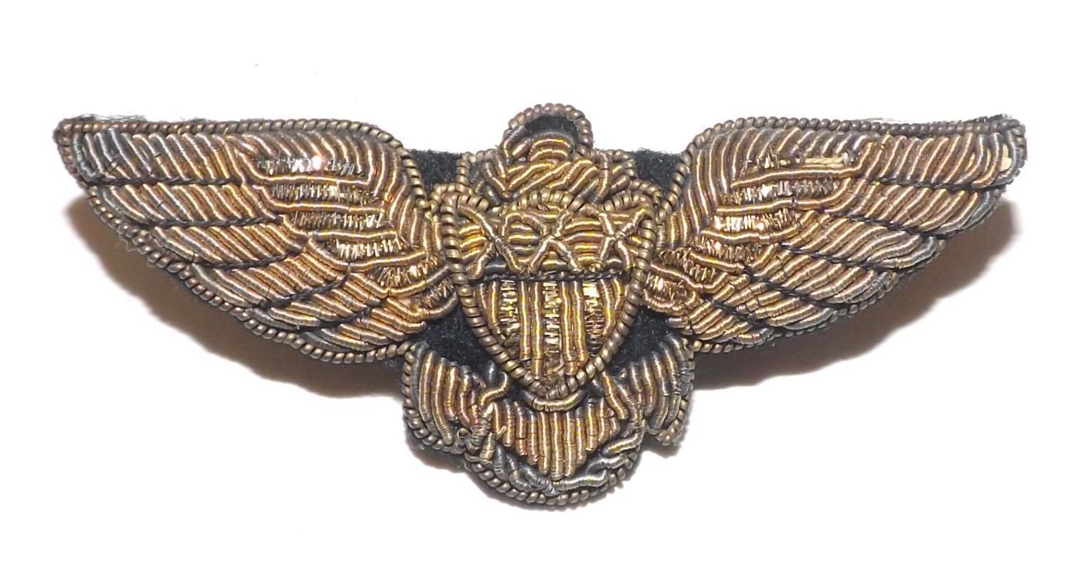

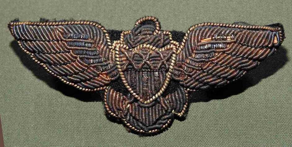

I thought I might as well just clean the entire wing.
Here are the before and after shots.
I rinsed them in water and then water with dissolved baking soda and then clear water to rinse last.
After
I may hit it once more.

Hi Bob. Thats what Im doing with the bullion wing in post #52 and #53.
Its on a shelf in plastic and Il post it next year to see if there is any effect.
Some may think its terrible that I cleaned it but personally Im happy with how it turned out.

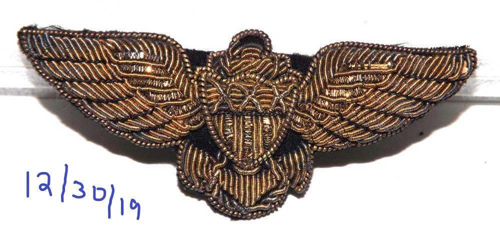

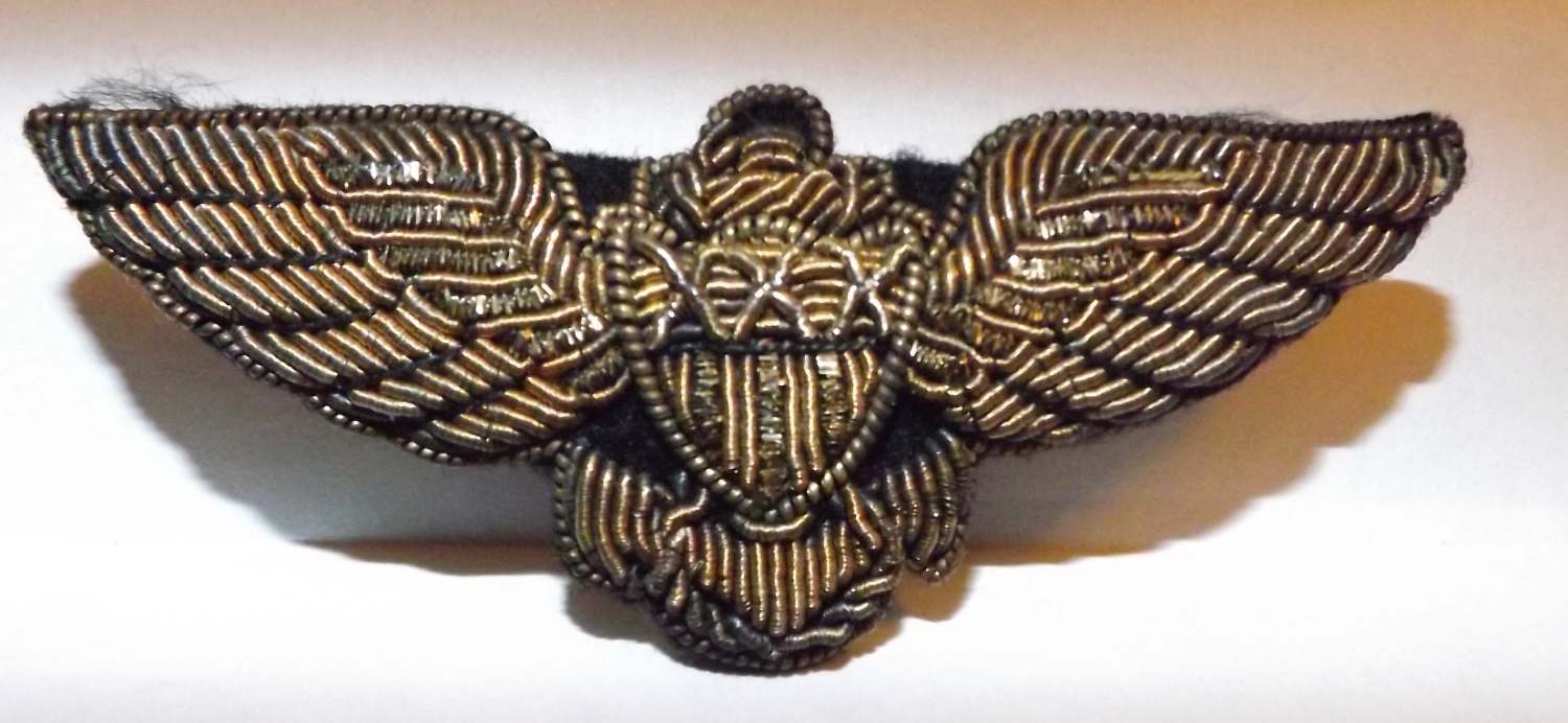

Close enough to a year gone by, so I thought I would update this and show the results after a year of sitting.
The wing has been stored in a plastic cover on a shelf out of the sunlight.
I never did do another coating on it. Its been untouched since the above post. Same camera taken in the same spot.
I took 3 new pics today to compare to last year. And where it started in the last pic.
So... to sum it up after a year, I see no damage from the Cream Tarter application.
And being covered and not exposed to the elements, its shine is still
there. Personally, I'm happy with the process and .......
Many thanks to the Original Poster on how to clean bullion.
In my eyes, my wing has been restored to its former glory. It looks much better than it did.

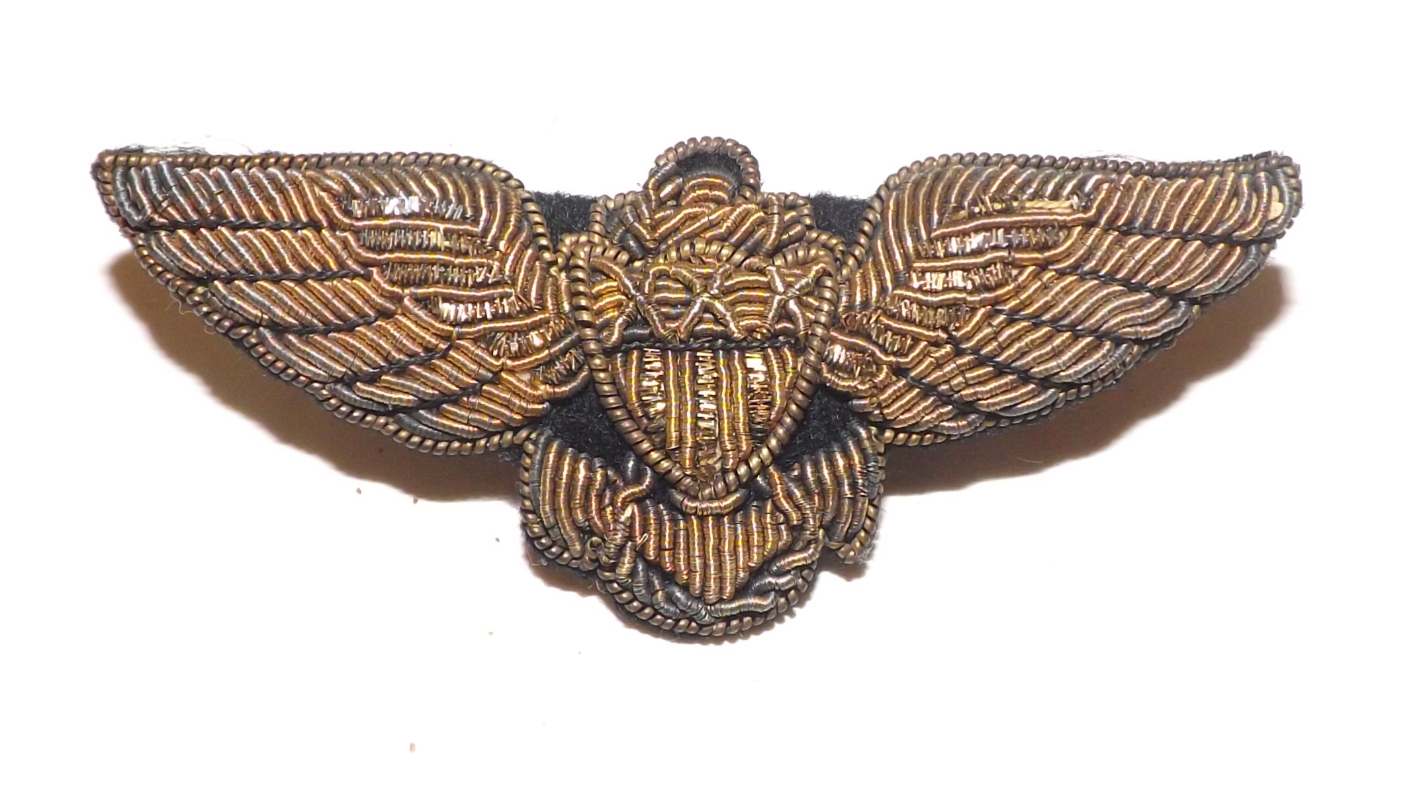

Here is one of the original shots at the top and then two taken tonight with . Looks about the same to me. I kept it in plastic in a cupboard. And the before pic at the bottom. I cleaned it over 2 years ago.

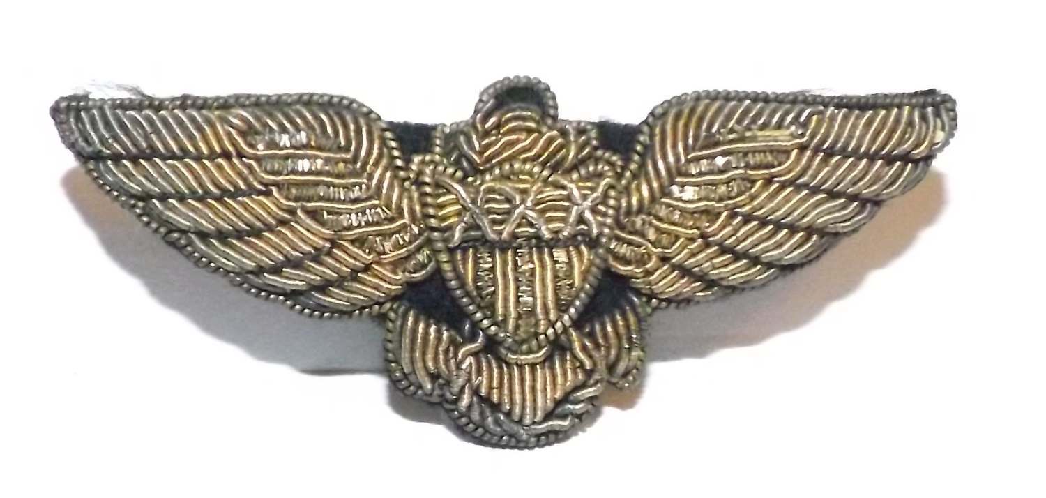

Update: New Pics 4+ years later.
My hats off and much thanks to the original poster
of this thread.......
Kaigun Shosa
The first three pics are dated. The original and then cleaned on the same day in 2019.
12/30/2019.
The third shot is Mayy of 2022
and the last 4 shots are today over four years later from the initial cleaning.
The last 4 were done with all flash first then flash backed off for the last 3.

The Rooster
12/30/19 and today.. Im sorry todays pic is not as sharp but theres not much change.
Seems a bit more tarnished/ slightly. Focus is off and the lighting is hard to match but I notice more tarnish ... Ropes on bottom
the thick cord wire used as outlines seems to have dulled a bit.
