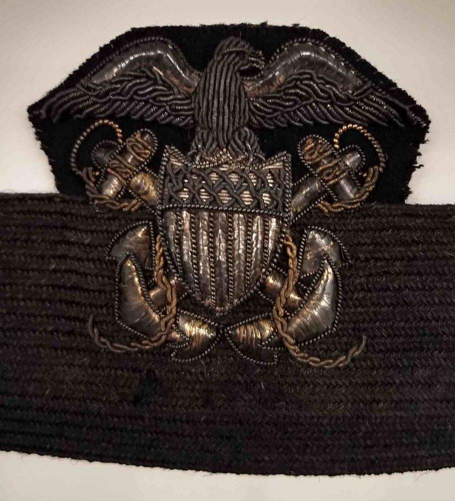

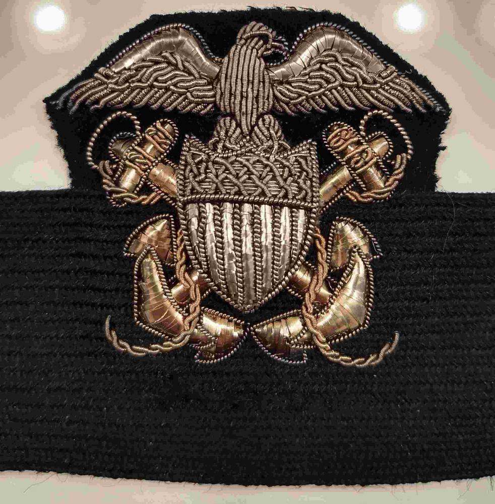

Here is a 1920's US Navy Officers Cap badge. Before cleaning.

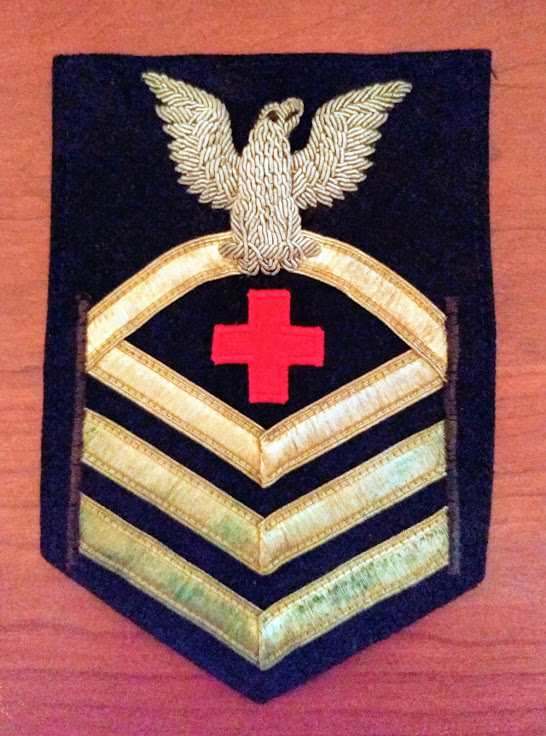

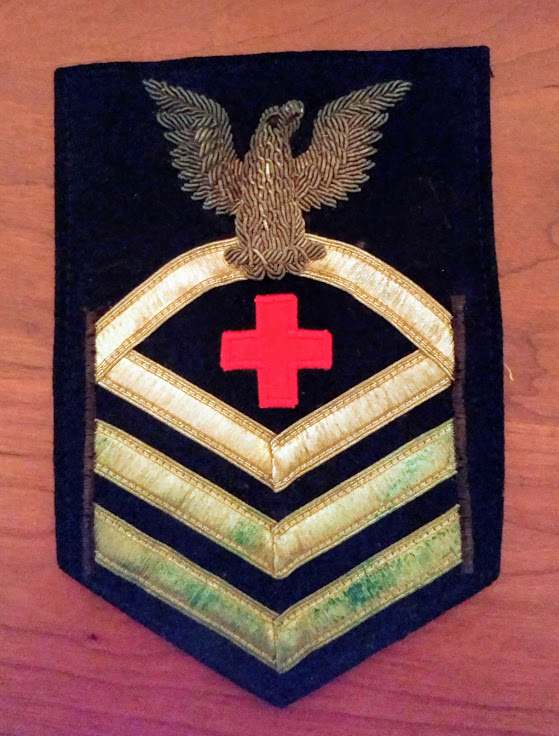

1930's Crow. Before and after. This was just a light cleaning. I did a light cleaning on the verdigris and was able to get some out.

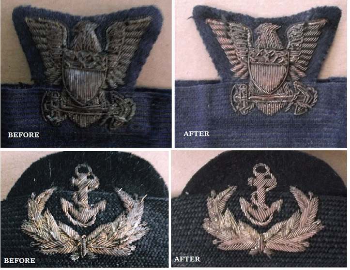

Just did a light onceover and you can see the results. A couple more times on the star and it should pop!

Well, spent some time on a couple of items I'd given up on as lost causes. Te CG cap insignia is from 1980, but I suspect it is a lot older. The band has a lousy dye job and I suspect it is from the 1970s prior to the uniform change. It was worn on my 'steaming cap and got a lot of abuse. It never was "inspection quality. The merchant marine wreath was new and shiny in 1990 but was also a working cap insignia. Again kinda salty when retired..
Both got 3 treatments with the TARTAR and light scrubbing. The MM insignia cleaned up well and I think the 'soup' did a great job. The CG device I had absolutely no hope for but I do believe it cleaned up about a 3 on a 1-10 scale. Very impressed. When dry, I gave them both a VERY gentle brushing with a very fine brass bristle brush. Brought a bit of lustre back to them..
