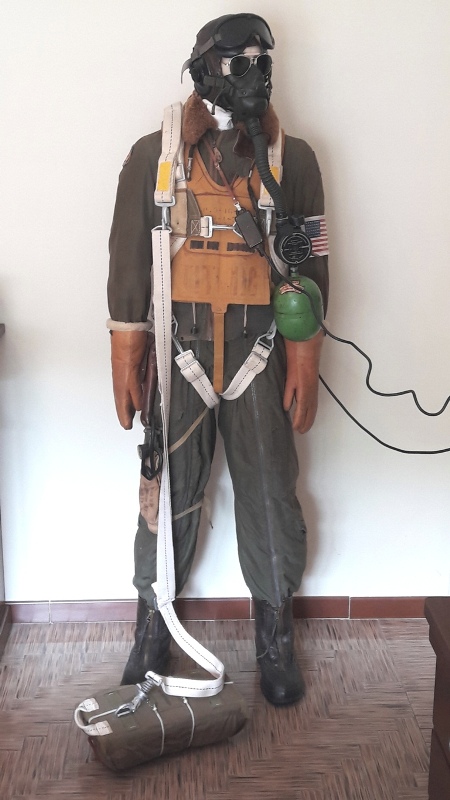

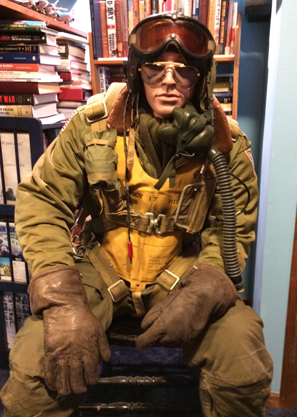

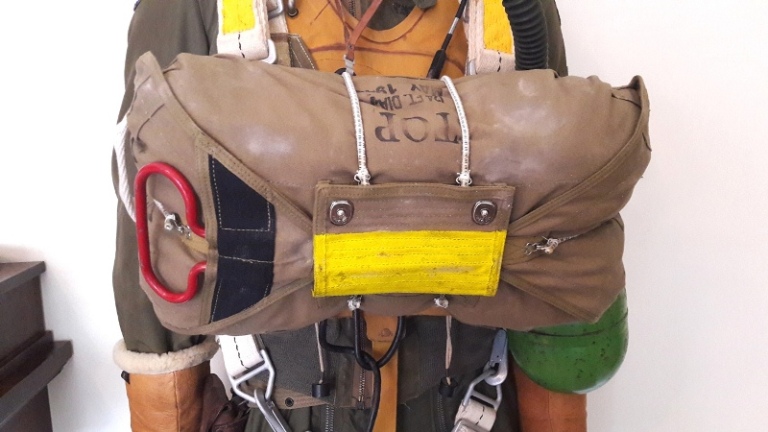

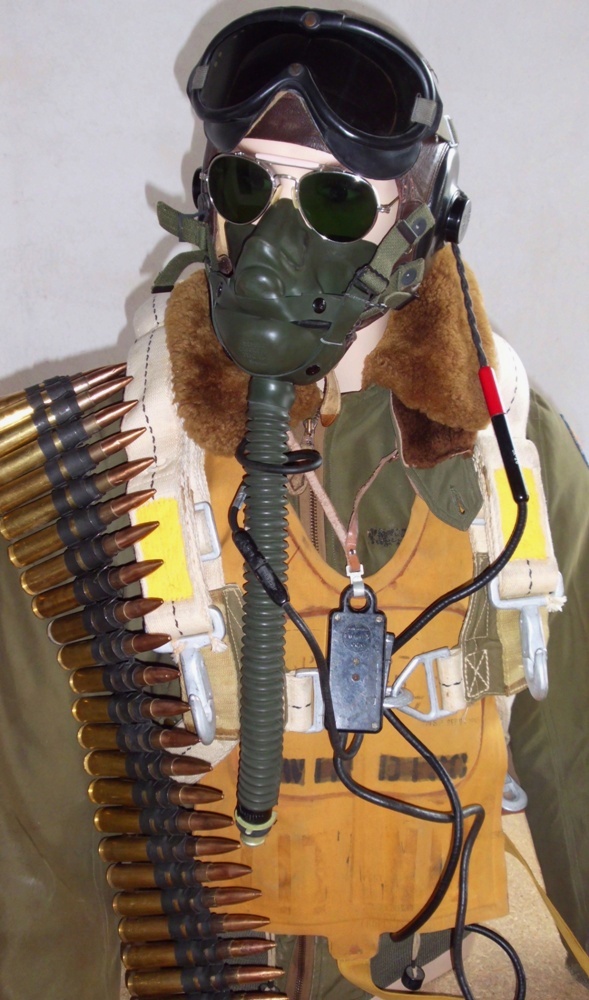

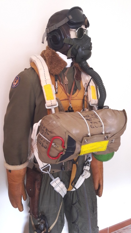

BlueBookGuy Posted September 21, 2019 Share #5 Posted September 21, 2019 Hello , I'm accluding some shots of a waist gunner mannequinn as re-created by my brother last year. Hope they might be useful to you. Impression is after May/June 1944, when the color (red or yellow) applied on the 'chute harness became standard. Link to post Share on other sites

BlueBookGuy Posted September 21, 2019 Share #11 Posted September 21, 2019 A brief list of the items in addition to the photos: A-11 helmet, A-14 oxy. mask, M-1065 goggles, civilian sunglasses patterned after the AN-6531, A-9A gloves, B-15 jacket + A-11 trousers, A-6A boots, B-4 Life Vest, A-3 'yellow group' harness + 'chute pack, proper extensions for comm. wires, A-4 oxy. portable bottle, H-1 bailout bottle, M-1936 waist belt + pistol holster. Link to post Share on other sites

38Driver Posted September 24, 2019 Share #19 Posted September 24, 2019 Here is my bomber crewman. B-10 and A-9 jacket and pants over an F-3 heated suit etc Link to post Share on other sites
