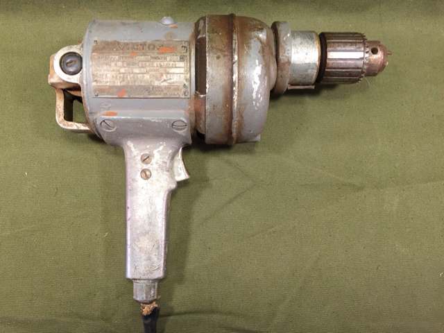

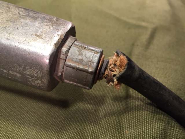

McDermut99 Posted June 14, 2019 #1 Posted June 14, 2019 This beast was a garage sale pickup recently. The guy I bought it from said his dad worked as a civilian on an A.F. base for a while and this was part of some surplus equipment he bought. It was made by Victor for the Army Air Corps, and looks to be a 1942 production. "Beast" is certainly an appropriate description for this drill, as it weighs north of 10 lbs and is very solidly built. It’s definitely seen better days, missing a chunk off the back and a frayed power cord at the base. I did take a risk and plug it in when I first bought it and everything seemed to work, but I didn’t push it. I’m seriously considering taking it on as a restoration project.I’m still finding out more about this type of equipment but any input is always appreciated!

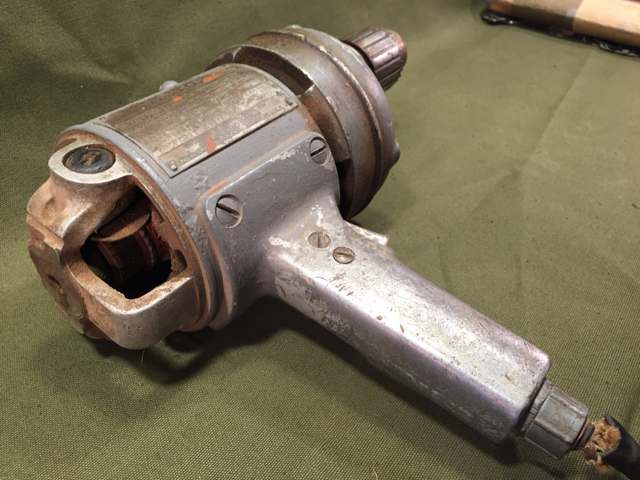

USARV72 Posted June 14, 2019 #2 Posted June 14, 2019 Chuck is broken, missing one of 3 jaw pieces, rear cover is also MIA, IIRC had a “D” shaped handle/ grip that covered rear of armature. Chuck can be replaced, open it , look inside, should be a screw holding it in. May have to use kroil or similar to loosen it, remove screw and old chick will unscrew. May have to check flea markets ect for same size chuck? Few cans of “ canned air” should clean out all the crud in rear around armature. Cord is easy to replace. Unsure how to replace rear cover/ grip. Nice find.

phantomfixer Posted June 14, 2019 #4 Posted June 14, 2019 http://www.usmilitariaforum.com/forums/index.php?/topic/272916-my-new-find-aaf-drill/ Very cool to have an AAF drill...Hope you get that one going again...might need some brushes too...maybe not...
