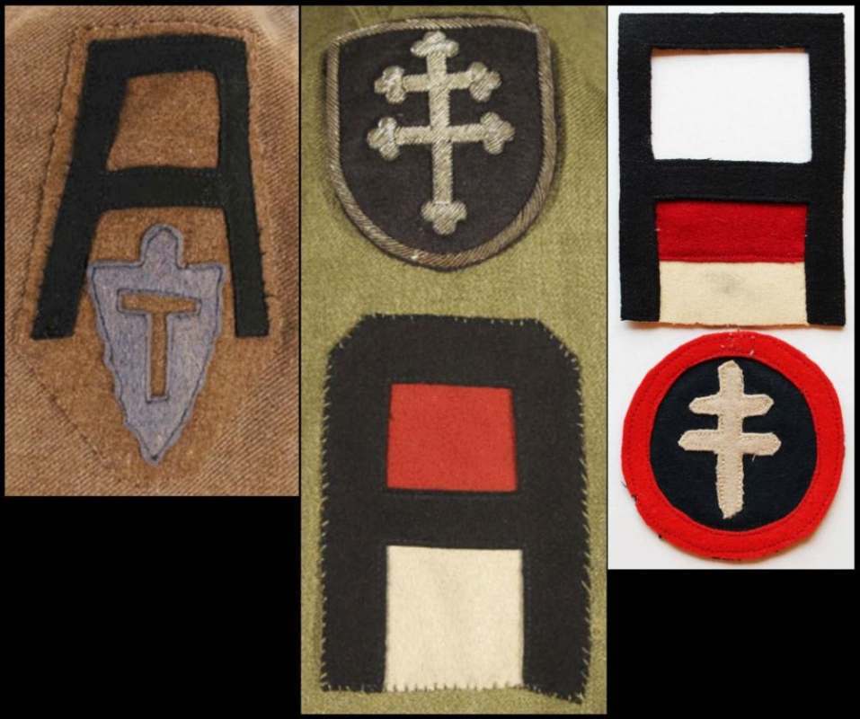

There is no 'right' answer to that question.  I've only seen one Coast Artillery Brigade SSI adopted during WWI (39th CAC Bde, composed of the 44th, 51st, and 55th CAC Regts, and subordinate to both the First and Second Armies during the war). During WWI, there were SSIs worn by Army-level and Corps-level artillery headquarters (often with a red quadrant or red ring or red square or red background on the regular Corps or Army SSI). I have one SSI worn by 1LT Longyear, CAC, which has the CAC crossed cannon with shell superimposed on a regular First Army SSI.  Anti-aircraft artillery battalions (which belonged to the CAC) sometimes had a red AA on the First Army SSI. SSI was a very new idea, and there were lots of variations worn by different units.

Great stuff thank you Ranger!  The Lt.'s CAC 1st Army SSI is a terrific find for you, I never saw that version before, was it custom made for him, or have you seen others?

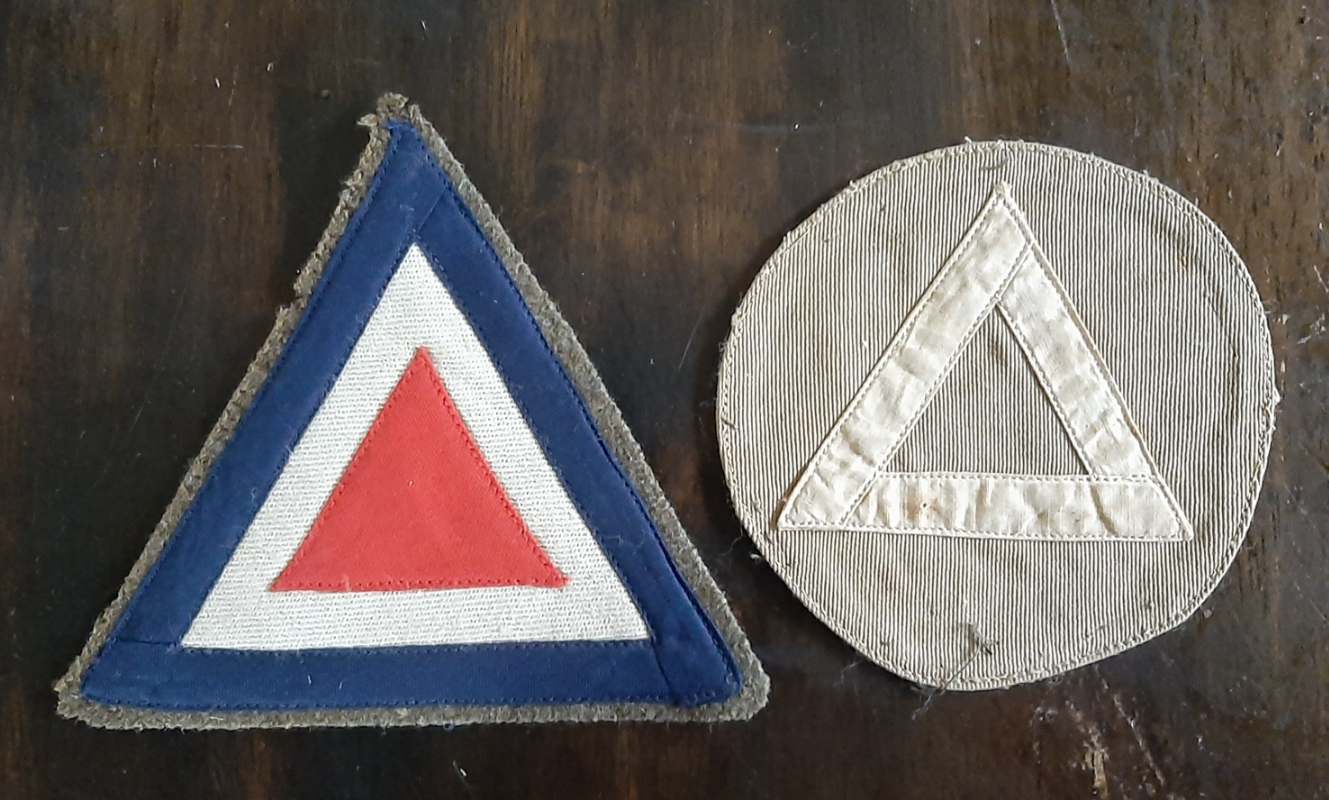

Here's another Coast Artillery Brigade patch worn during WWI.  To the right is the 57th Coast Artillery Regiment patch and to its left is the 31st Coast Artillery Brigade Shoulder Insignia of which the 55th, 56th and 57th were subordinate to.

The 31st Coast Artillery Brigade was originally organized in January 1918 at Key West, FL, and consisted of the 55th Regt (155mm Grande Puissance Filloux (G.P.F.) gun), 56th Regt (155mm GPF), and 57th Regt (155mm GPF), CAC). The Brigade HQ moved overseas in March 1918 and was assigned to III Army Corps in August 1918. It was reassigned to First Army from Oct-Nov 1918, and returned to the US in February 1919, being stationed at Camp Lewis, WA.  Eventually, the Brigade HQ moved to Ft Winfield Scott, CA and it was deactivated in April 1921.  It is my understanding this is a post-WWI shoulder patch.  In the 1920s, the subordinate CAC Regiments had shoulder patches that were a white triangle (55th CA Regt), red triangle (56th CA Regt), and blue triangle (59th CA Regt).

kiaiokalewa
Mega Mahalos (thanks) for providing the Brigades CONUS movements after it returned back from the AEF.  I was unaware of its assignment in CA and remained active well into 1921.  I had a feeling that this 31st CA patch was a product of the mainland due to its construction.  The patch is massive in size measuring 4 1/2" in height and width.  What's interesting the white materials used in both of these insignia are one and the same.  This leads me to believe that both were stateside made SSI.  I wonder if there are similar examples for the (56th & 59th CA) too?  I hadn't seen any in the 40 years of collecting yet.  Now I'm talking about the Multi-applique cotton types like the ones above.

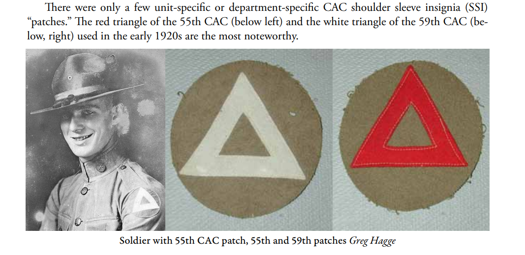

Extract from:  Coast Defense Study Group Reprint Page 1 Insignia of the Coast Artillery Corps Mark Berhow
