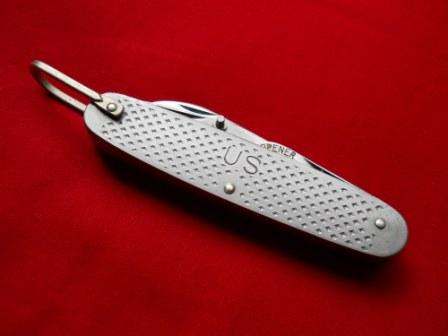

bobcat87 Posted February 24, 2018 #27 Posted February 24, 2018 Here is my newly discovered US Army Specification 17-170A 1949 Camillus stainless utility prototype knife. I have read in other discussions on this board that a very small number of these were produced and less than 10 are known to exist. I have searched daily for more than 15 years to find one of these. It was worth every minute of the search. This is my find...

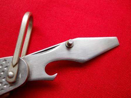

bobcat87 Posted February 24, 2018 #31 Posted February 24, 2018 I really lucked out on this one. I guess now there is one more to add to the count of existing examples. The condition on this one is what really grabbed me. The only imperfection is a very, very tiny piece of the tip was lost and reshaped. Other than that it snaps like a bear trap on all tools, has a straight bail, full pin heads, minimal pocket wear, and lots of factory shine left.

bobcat87 Posted February 24, 2018 #35 Posted February 24, 2018 Something new that I just noticed about the 1949 Camillus. It appears that the bail is a different colored metal than the scales. Different batches of steel? Maybe a harder or softer steel? Starting in 1957, the bails appear to be the same type of stainless steel.

bobcat87 Posted February 24, 2018 #37 Posted February 24, 2018 Sactroop and Thorin6. Do either of your knives have a bail that appears to be of a different alloy or metal?
sactroop Posted February 24, 2018 #38 Posted February 24, 2018 I took a look at it and I'd like to look at it again under natural light. I'll compare it to some of the WW2 and later examples I have too. Get back to you.

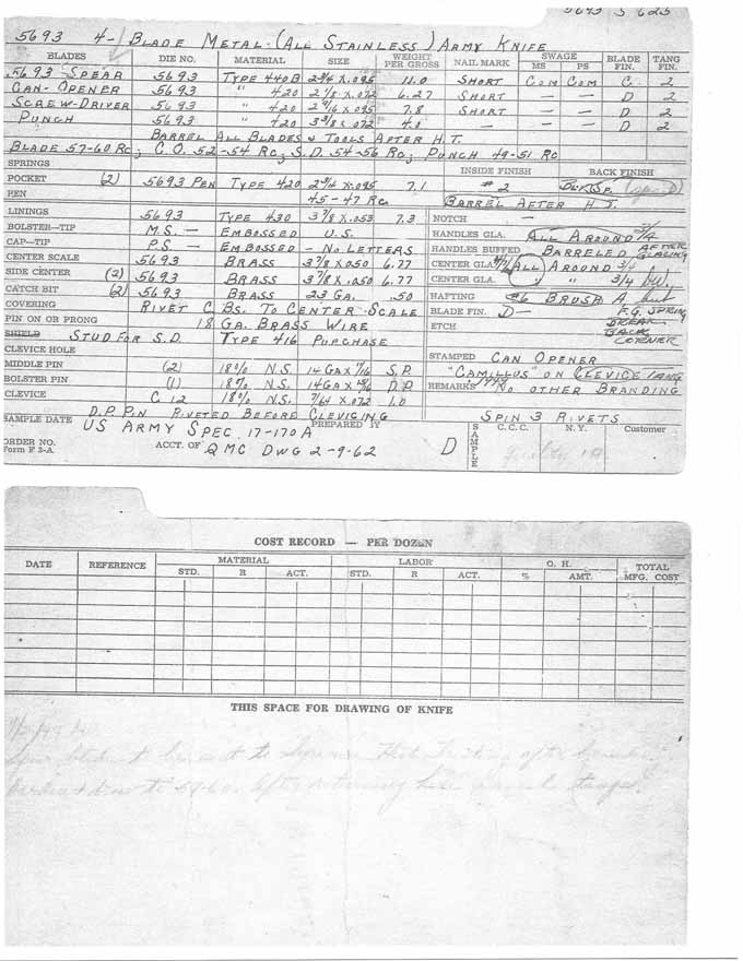

Frank Trzaska Posted February 24, 2018 #39 Posted February 24, 2018 Actually many different materials are used in the 1949 example. Spear blade is 440B Stainless Steel Can Opener 420 SS Screwdriver 420 SS Punch 420 SS Grip Liners 430 SS Center and side scales Brass Pins (exposed) and Clevice (Bail) 18% Nickel Silver Pins (internal) Brass Stud for Screwdriver 416 SS In any case great find in super condition! All the best Frank Trzaska
Misfit 45 Posted February 24, 2018 #40 Posted February 24, 2018 See if the clevis is magnetic or not. The Ulster 48 I have, has a nickle alloy clevis. Marv
bobcat87 Posted February 24, 2018 #41 Posted February 24, 2018 I just noticed that my Ulster 48 is the same exact way. This knife is one year off from the 1949 Camillus. It has a bail that the color varies slightly too suggesting the use of a different metal or alloy for the bail. It makes sense on the bail for strength and or non-conductance of spark maybe. Kind of like copper or brass bails on rope knives. Just some ideas.
bobcat87 Posted February 24, 2018 #42 Posted February 24, 2018 It is always great when Frank adds to the discussion. He always seems to have the facts and figures to answer our questions. It is really amazing the attention to detail and R&D that was put into the development of these amazing little knives. Frank, did Tom Williams ever retrieve or post the original drawings or S-Card for the 1949 Camillus? I would love to see that if it still exists...
sactroop Posted February 24, 2018 #43 Posted February 24, 2018 Last night I was suspecting nickel/silver from what I thought I was seeing. Agree that looking at different knives the clevis most closely resembles the Ulster 48 and some of the WW2 Kingston's although the Kingstons don't show much if any of a yellow tinge to the overall grey color.
bobcat87 Posted February 24, 2018 #44 Posted February 24, 2018 According to the info that Frank posted it is 18% Nickel Silver.

Frank Trzaska Posted February 27, 2018 #47 Posted February 27, 2018 Here are copies of the production cards on the 1949 where I got the info from. I have not found how many they made yet.All the bestFrank Trzaska
bobcat87 Posted February 27, 2018 #48 Posted February 27, 2018 Frank, That is just way too cool. Amazing the info that you have. Thanks a million for posting that!
