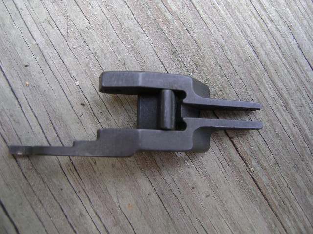

Op rod catch identified by the round cuts by the accelerator

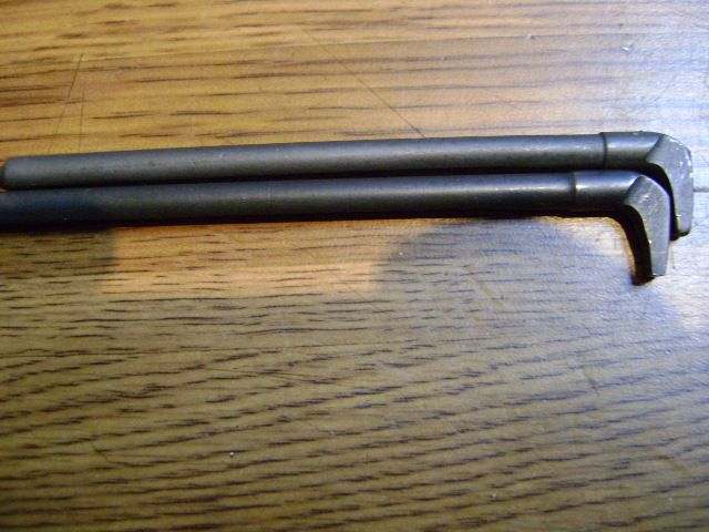

WRA firing pins identified by the cut by the end of pin

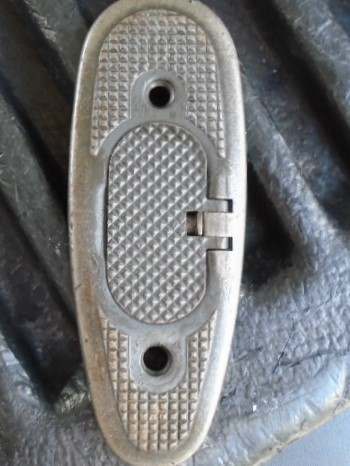

WRA buttplate identified by the checkering and offset hole

Again, these are just a very few of the many unmarked parts found on a WRA garand, you have to know what to look for and be able to identify the manufacture. There are also different variations of these parts for different serial ranges
These parts are not covered in books. Books generally just reference parts with drawing numbers. Even if you are able to identify all the parts as WRA you have o be able to make sure they all belong on the rifle for the serial range
