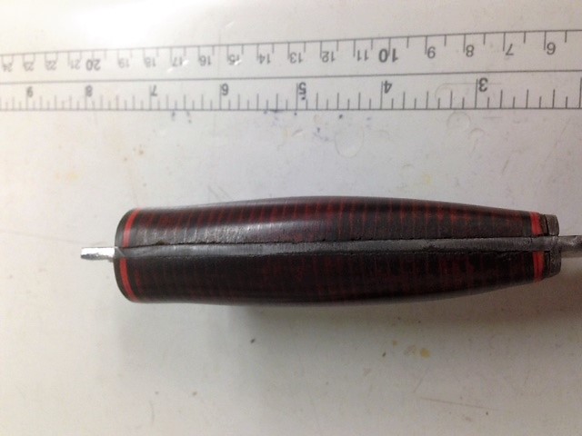

Steve S. Posted February 20, 2017 Author Share #28 Posted February 20, 2017 Been working on something a little different today, a Western L-71 "SeaBee" knife. The pommel had broken off & was missing so had to add metal to the dual tang. The original handles on these were made from thinner leather & had the fiber washers on both ends in red & black. I think the handle turned out well & just need to finish up making the pommel & attaching it. Link to post Share on other sites

Steve S. Posted February 21, 2017 Author Share #33 Posted February 21, 2017 If you only need to replace or add a missing washer, you can split a washer & work it in place. Just make sure you get a good amount of glue on it & wipe off the excess after you get it in place. & tape it tightly to close the split gap until the glue dries & its pretty much invisible unless someone is really looking close. I have this postwar unmarked M3 type knife that was missing a couple washers up front next to the guard. I split a couple washers, added some glue & worked them in place. Just split one end & work it in so the split is on the bottom side (Kinda like a horseshoe) before & after; Link to post Share on other sites

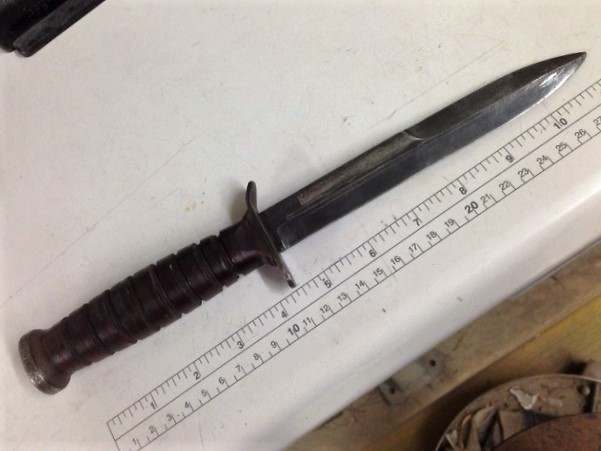

Steve S. Posted February 21, 2017 Author Share #34 Posted February 21, 2017 Made the pommel & finished the Western. Those double tang pommels are a pain to make! Broke 3 end mill bits making the holes... Link to post Share on other sites

Steve S. Posted February 22, 2017 Author Share #39 Posted February 22, 2017 Finished up the guard marked Boker M3 today. Link to post Share on other sites

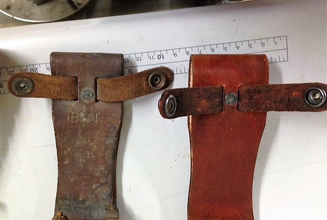

sactroop Posted February 24, 2017 Share #49 Posted February 24, 2017 So Steve did you make your own staples for that sheath? I like the color you picked for the sheath. How light a shade do you start with and do you prefer a specific type, like alcohol, water, or oil for the dye? Link to post Share on other sites
Steve S. Posted February 25, 2017 Author Share #50 Posted February 25, 2017 Ha! The staples were some I found in some old construction materials I had here. Still searching for a more "exact" staple but all I've found so far are some NOS originals that aren't very cost effective. As far as dye, I've just been using the Fiebings brand As I can get it locally. The new "pro dye" they have out is really nice, although I've only used the black so far. I think it's oil based IIRC. I kinda go "willy nilly" with the dyes. I always start light usually with a british tan, which gives it a russet base & go from there. I mix dyes, change application techniques & do all sorts of other things to age/distress it. The dark spots that look like water/oil stains on this one are made using wood glue before any stain is applied. I put a few drops here & there, let it sit until dry & peel off. Something in the glue soaks into the leather & leaves a dark spot when you stain over it. I found that out once by "accident" & started using it in a controlled way! I've seen some really poor aging jobs done on things & the trick is go easy. I had a reproduction leather flight jacket in a yr or so ago that I had to completely disassemble & restitch. Somewhere along the way, a previous owner had taken 80 grit sandpaper to it to age it & sanded all the thread away. The guy I did the job for bought it & it started falling apart on him. I do some sanding to age the sheaths, but always wetsand usually no courser than 600 grit & always before sewing! Link to post Share on other sites
