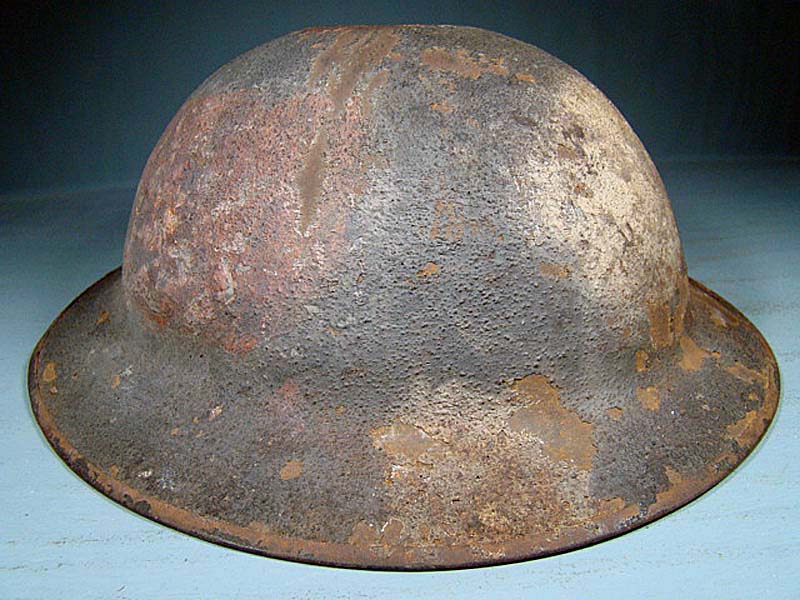

AustinO Posted January 25, 2017 #101 Posted January 25, 2017 Wanted to add this one to the topic, which I recently picked up. It's quite similar to the helmet in the first post. No provenance unfortunately, but you can see where a couple of the colored sections were scraped down to the bare metal (the red one towards the front, and a yellow one on the top).

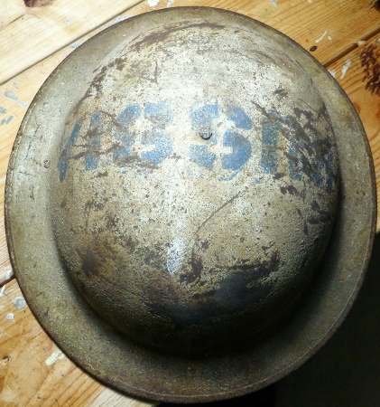

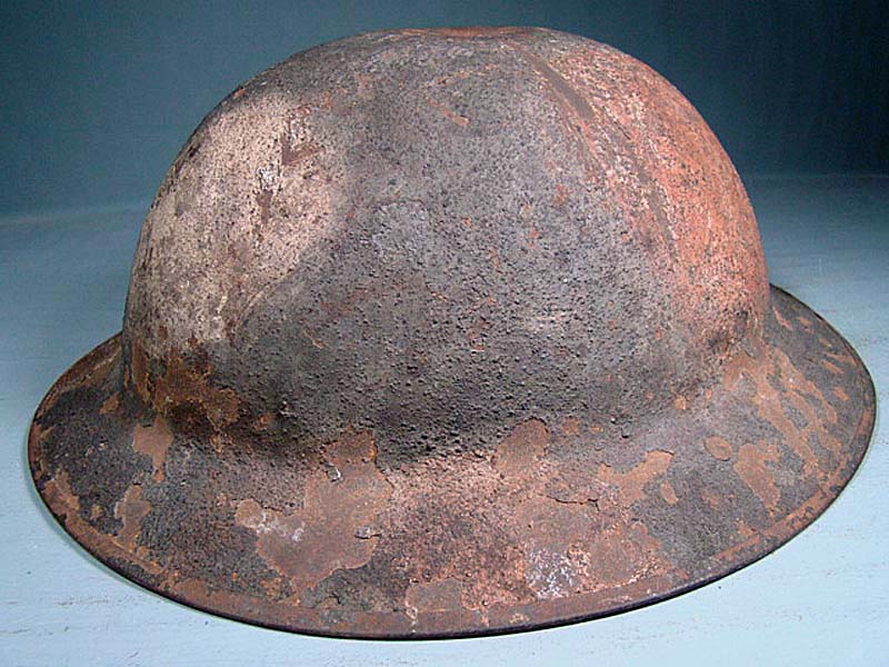

mccooper Posted January 26, 2017 #102 Posted January 26, 2017 Great thread - thanks! Regarding the white helmets, here is a pic of mine, somewhat the worse for the wear, but seemingly authentic. The "Russia" stencil was painted while on the von Steuben going home, per the Bozich Bros. However, can I assume that the white was part of the war-time camo? southridge

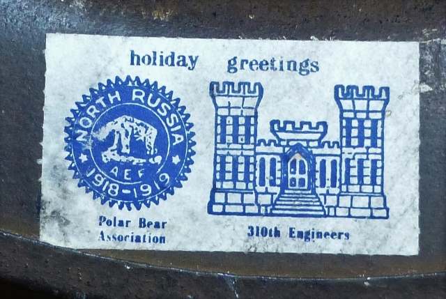

mccooper Posted January 26, 2017 #103 Posted January 26, 2017 And this label is attached to the inside rim. southridge

world war I nerd Posted January 26, 2017 Author #105 Posted January 26, 2017 Mccooper, Austin O & Suwanneetrader thanks for adding your camouflage helmets. Coop, my understanding has always been that the Russian helmets were originally white and that the word "Russia" in blue was later stenciled on, but I don't recall the source of that information. The story regarding your helmet seems to somewhat confirm it though. It would make sense that helmets were painted white for the Russian winter, but so far there is no photographic evidence showing white helmets worn in action in either North Russia or Siberia. Suwanneetrader, the yellow dot on your helmet is certainly an interesting feature that must have some significance ... yellow was the hatcord color for the cavalry ... a narrow yellow armband was worn by AEF carrying parties in combat ... it could also be related to British style shoulder flashes & battle insignia which the AEF experimented with during the St. Mihiel offensive and beyond. Unclegrumpy, in respect to your question, I don't have a list of AEF unit insignia that was in use prior to the signing of the Armistice. I suspect that by November of 1918, most if not all AEF organizations had adopted an insignia to identify it transport and baggage. That practice may have even been mandated by GHQ. Not all, but many AEF unit histories devote a paragraph or two to their unit insignia and sometimes explain when and why it was adopted. Off the top of my head, the 2nd, 5th, 26th, 42nd, 81st and 89th Divisions had all adopted their insignia between the spring and summer of 1918. I suspect others did as well, but these are the only organizations that I've been able to confirm so far, but I haven't really been looking very hard for that information.

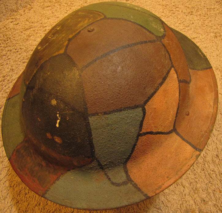

Don L. Posted January 30, 2017 #110 Posted January 30, 2017 This is an interesting thread and thank you for presenting it. Just wanted to add another helmet from my collection. The helmet received a total camouflaged painted finish across the external shell surface in gray-green with white and brick-orange/brown non-bordered irregular patches. I have no background on this one so anything is possible, but it does stand a chance pattern-wise (at least) of being used in the field.
world war I nerd Posted February 1, 2017 Author #111 Posted February 1, 2017 Don L. thanks for adding one of your camouflage helmets. One of the things I always liked about the cammo helmets that show some age, is that (to me) those are the ones that just might have seen service in the trenches 100 years ago. Most however, probably received their weathered appearance from spending the last century in a damp basement or partially exposed to the elements in a barn or garage. But, unless you know the helmet's actual story, there's always hope that it too was a veteran of combat.

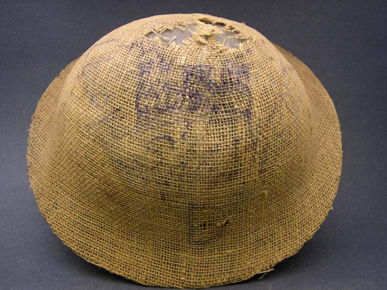

aef1917 Posted February 12, 2017 #124 Posted February 12, 2017 Here is one of mine with a hessian cover. It's also decorated with an Engineer castle and the doughboy's name.

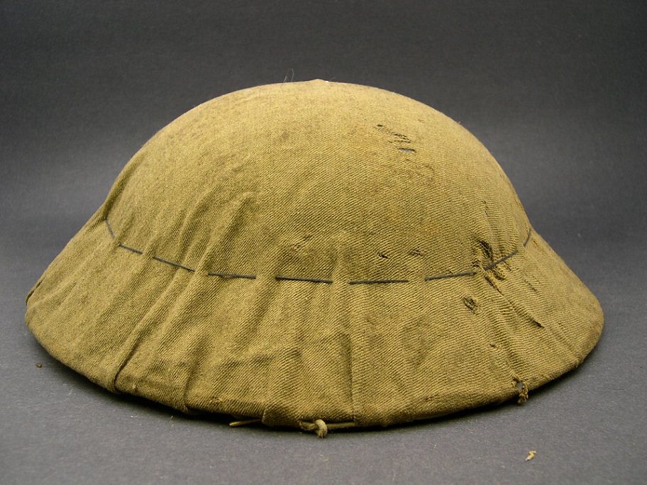

aef1917 Posted February 12, 2017 #125 Posted February 12, 2017 And another, with a cotton or linen cover, belonging to a 7th Division doughboy.
