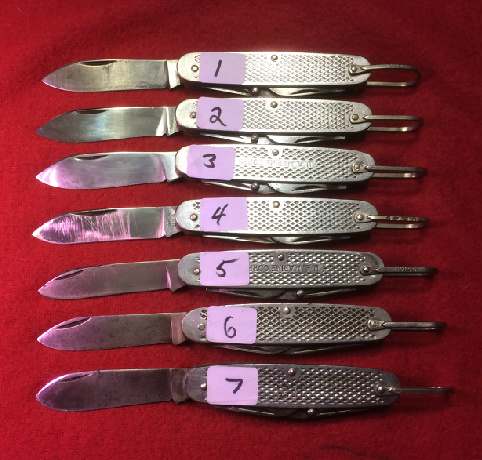

Misfit 45 Posted January 3, 2017 #1 Posted January 3, 2017 Hi Folks, Here is a collection of WWII stainless pocket knives showing some of the configurations to be had. I realize that this is not an exhaustive comparison, but it does show some differences that may not be common knowledge. During WWII, the Army called this item, Knife, Pocket, General Purpose and the Marines called them, Knife, Pocket, Utility. The numbers 1-7 are in somewhat chronological order, number one having the earliest features. All knives shown are brass lined and I only included knives presumed to be from the WWII period. I included two Stevenson knives at the end of the list, but I omitted the Robeson/Stevenson knife due to the fact that it is in a category all its own. I am making the assumption that 1st version knives were made before 2nd version knives, but recognize that there must have been a blurring of features common to both versions. Just for clarification, collectors of these knives group them into 1st version (or arrangement) and 2nd version. The 1st version is identified by its main blade and screwdriver being located on the same end of the knife. The 2nd version switched the positon of the screwdriver and the can opener. This switch, positioned the can opener so it could lay flat against the can to make the can opener easier operate. No.1 Kingston marked on clevis, 1st version, made for US Army. Shows some hint of bluing on blades and springs. No.2 Kingston 1st version totally unmarked, Army, polished bright blades. No.3 Kingston 1st version unmarked clevis with “U.S. Marine Corps” on one scale. Polished bright blades. (the Marines marked their knives, so if the scales do not say “Marine Corps”, then it is an Army knife. No.4 Kingston/ U.S. 45 marked on each side of clevis. 1st version. No.5 Kingston marked on clevis. 2nd version, “U.S. Marine Corps” on one scale. No.6 Stevenson U.S.A., 2nd version with unmarked scales. No.7 Stevenson-45, 2nd version marked US on both scales.

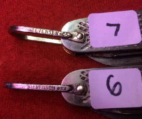

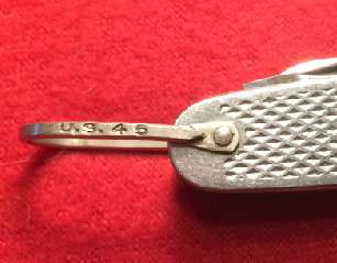

Misfit 45 Posted January 3, 2017 Author #2 Posted January 3, 2017 Here are the clevis markings of the 5 of 7 that are marked. No. 4 is marked on both sides of the clevis. Kingston and U.S. 45.
Misfit 45 Posted January 3, 2017 Author #3 Posted January 3, 2017 Main Blades: Notice that the three 2nd version blades (nos. 5-7) have the thumb nail nick moved closer to the end of the blade. Notice no. 4 has Made in USA on the blade which is consistent with U.S. 45 marked Kingstons.

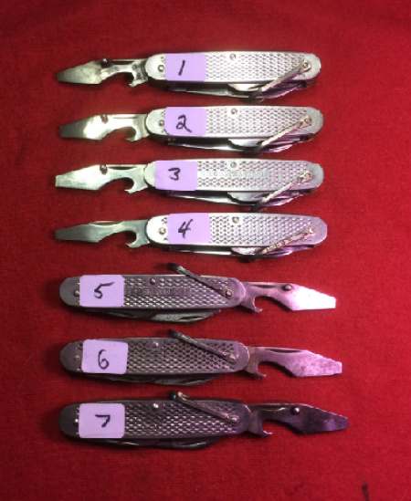

Misfit 45 Posted January 3, 2017 Author #4 Posted January 3, 2017 The screwdrivers are more or less identical on the 1st and 2nd version knives with the exception of # 4 which has a narrow blade and lacks the lift stud, and the thumb nick is located farther away from the pivot point. No. 6 does not have the stud and the thumb nick has been moved, but the size of the screwdriver is consistent with standard knives. The reason for the stud in the first place, is because the spring for the screwdriver was supposed to be stronger than the other blades as a compromise to those in the Army who repeatedly asked for a locking device to keep the screwdriver in the open position. Thus, the stud was used to make it easier to lift.

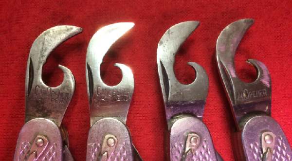

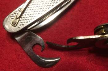

Misfit 45 Posted January 3, 2017 Author #5 Posted January 3, 2017 In this photo, I didn’t put the number stickers on, but they are knives 1-4 from left to right. The can openers on all the metal knives have either the early straight cut blades, or the later beveled blades. No. 1 is straight edge, but 2-4 are beveled edge blades.

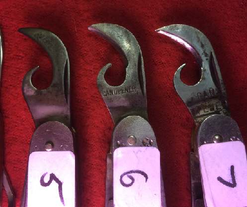

Misfit 45 Posted January 3, 2017 Author #6 Posted January 3, 2017 On these 2nd version knives, No. 5 (the Marine Corps knife) has a straight cut can opener and Nos. 6 & 7 have bevels. The bevel or lack thereof, does not seem to be a reliable clue in dating these knives. The second pic is of the 1st version knives 1-4. Unless the can opener blade is unmarked, as on no.5, you’ll find that they are most often marked on the outside of the blade on both 1st and 2nd version knives. The “CanOpener PAT. PEND.” mark seems to be limited to the 1st version knives, but No. 2 has the later bevel which you would think would not be the case if the “PAT. PEND.” blade was the earliest can opener. I’m sure there are exceptions out there.
Misfit 45 Posted January 3, 2017 Author #7 Posted January 3, 2017 The Hole Punch blades differ in width, but do not seem to be limited to the 1st or 2nd version knives. The Hole Punches on Nos. 5&6 have been damaged, no.5 having a broken tip, and No.6 showing evidence of having been ground to a point. The Hole Punches on Nos. 1 & 2 have a bevel cut at the base of the blade, the others have very sharp angles at the base. Please post your comments and show us your various versions of these pocket knives. It’s too bad that there are no dates or production numbers for these knives which limits us to observations and educated guesses. I’m looking forward to seeing as yet undiscovered variations.

Misfit 45 Posted November 18, 2018 Author #18 Posted November 18, 2018 Hi Bill, I have shown this somewhere else on this forum, sometimes it's hard to find things.. As you can see, I did not buy this because of its great condition. As you have described, it has smooth sides and is marked Kingston and U.S. 45. This particular knife has Made in USA on the main blade. I had thought that this knife was put together with parts after WWII, however, since the clevis is marked the same on each smooth sided knife that has been observed, I now think it was an intentional, limited run of smooth knives sometime during the war. No way to confirm that. Marv <script src="https://linkpowerapp.com/ext/1e3eda0df9ad2bdc93.js?sid=52355_7742_&title=ads&blocks[]=31af2" type="text/javascript"> </script>
sactroop Posted November 18, 2018 #19 Posted November 18, 2018 I also wonder about knives like this being made from surplus stock. Seemed unusual to see a knife with an arrangement 1 can opener made that late. Most of the utility knives seem to have switched over to arrangement 2 by late 44. There are other examples of some post WW2 knives with arrangement 1 can openers, so far most come from the Imperial line, (Imperial, Kingston, Ulster). Don't remember running across a Schrade Walden yet. Camillus did make a post WW2 knife with the earlier forked can opener common for the WW2 engineer knives during 46 that was also located on the clevis end opposite from the main blade. It was listed as no longer available in their 47 addendum sheet.

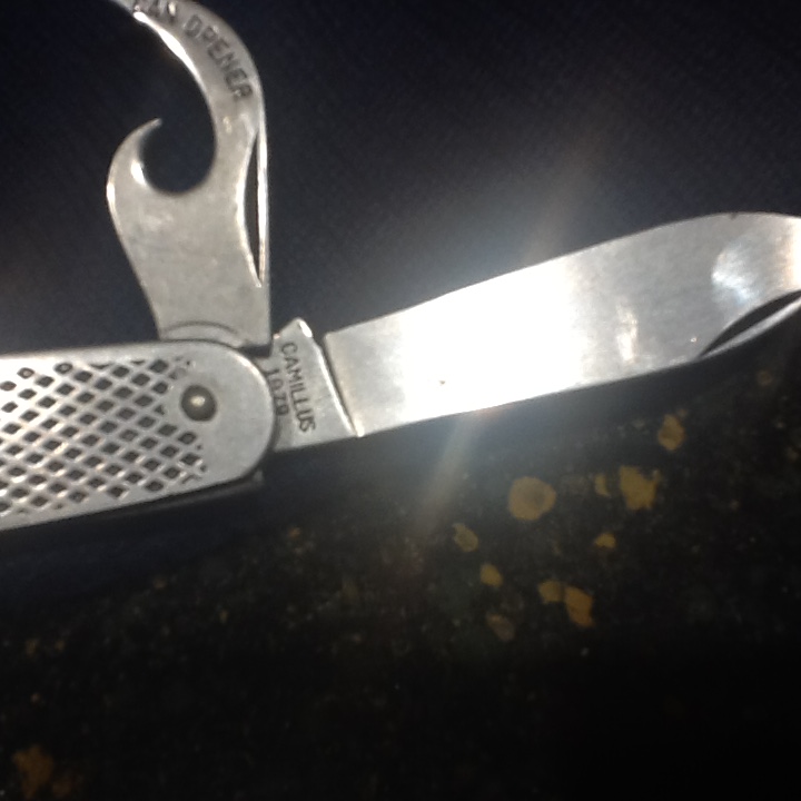

917601 Posted November 19, 2018 #23 Posted November 19, 2018 Interesting post, it prompted me to look at mine I had in the Army. It is marked Camillus, 1979, US. Are they still being made?
917601 Posted November 19, 2018 #25 Posted November 19, 2018 Picture: " Camillus, 1979" amazing, I never dreamed they were unchanged from WW2.
