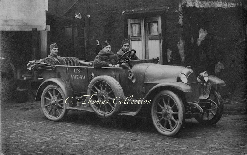

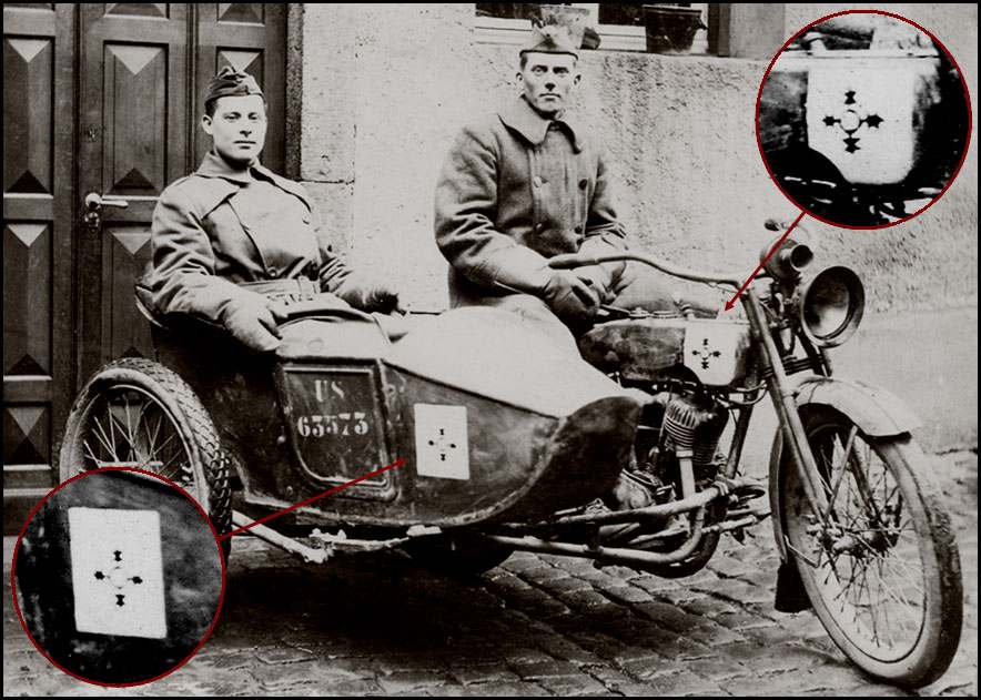

world war I nerd
Another 4th Division motorcycle & sidecar with someone by the name of "Lt. Greene" within the sidecar. The location & date of are unknown.
Photo courtesy of the Rogier Van de Hoeff collection

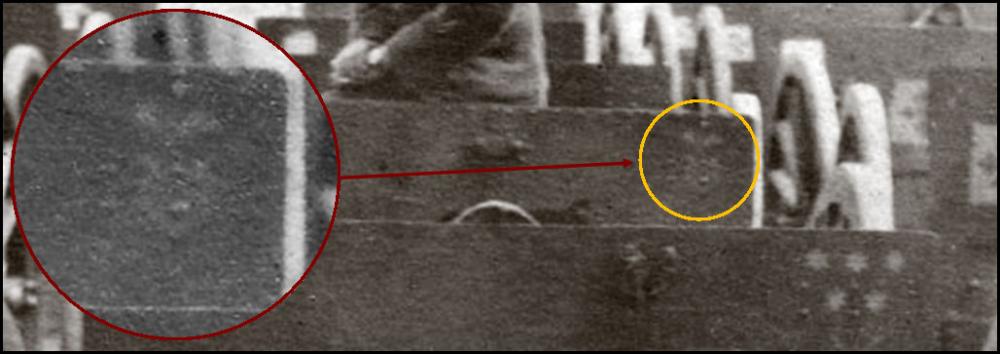

world war I nerd

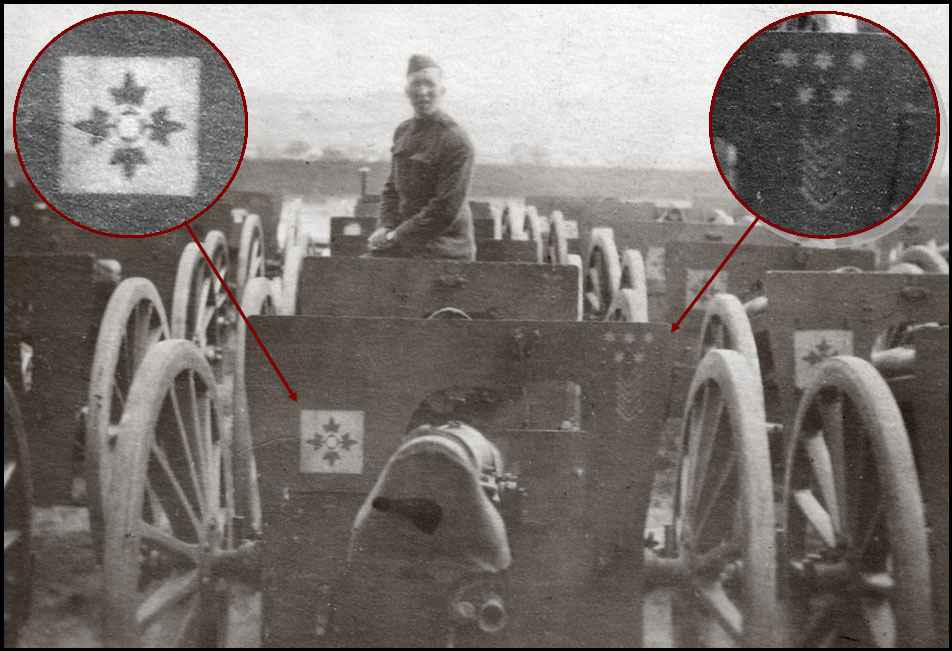

This one of a 4th Division Artillery park is pretty interesting. On the right hand side of the French 75mm gun shield is the insignia of the 4th Division. On the opposite side is a series of stars and chevrons whose purpose are unknown.
So far there are two theories as to what those symbols represent:
1. One thought is that they represent some sort of score or tally, i.e. stars for destroyed targets and chevrons for damaged targets.
2. Another is that the stars are "gold stars" representing members of that battery killed in action & the chevrons are a tally of "wound chevrons" earned by members of that battery.
Any thought as to what the stars & chevrons on the gun shield signify?

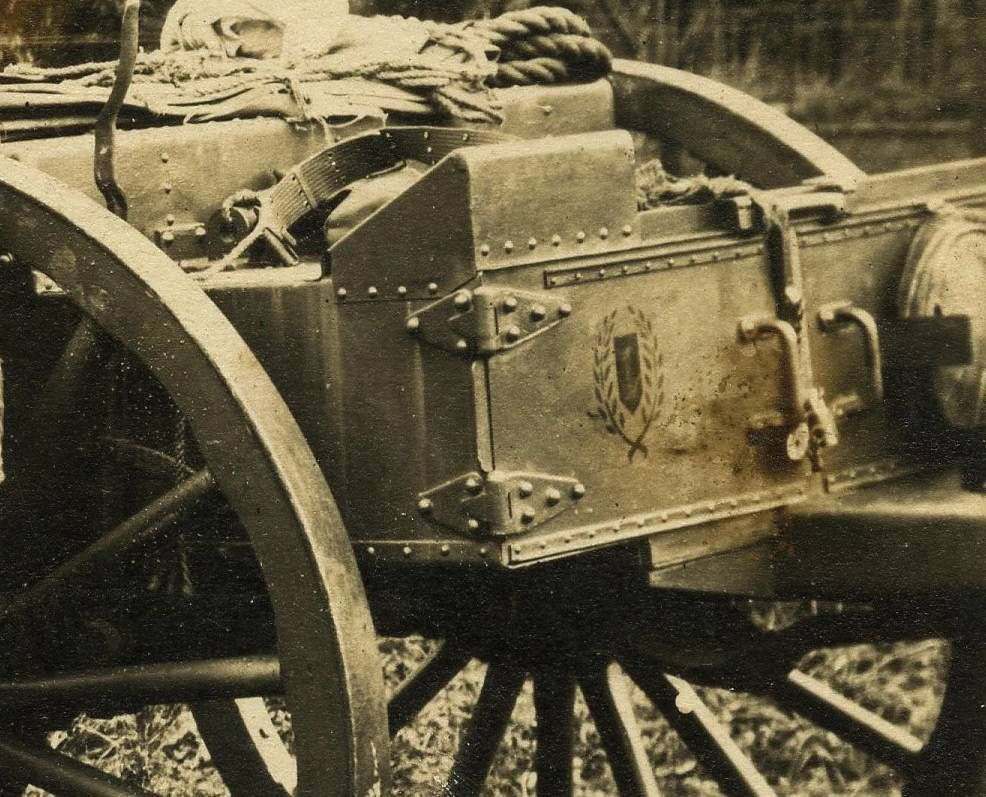

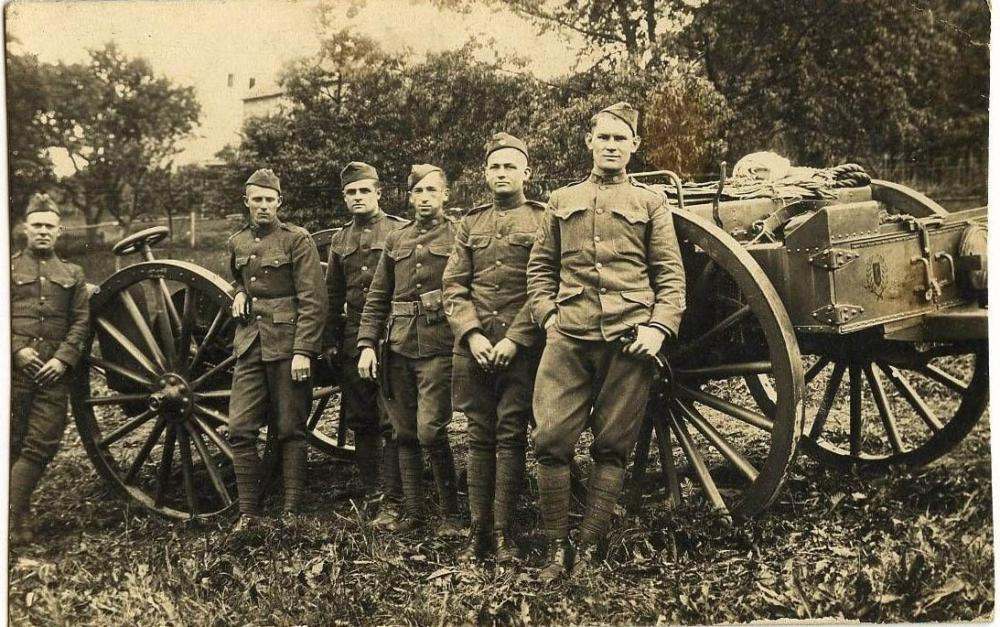

world war I nerd
Not sure if I'm seeing things, but it looks like there is some sort of insignia on the left hand side of the gun shield on the artillery piece directly behind the gun with the 4th Division insignia. It almost looks like a bird or some other winged creature hovering over a circular object?
Any thoughts?

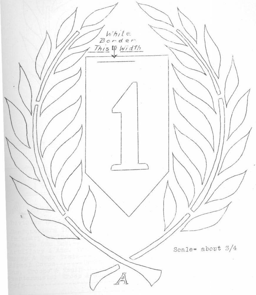

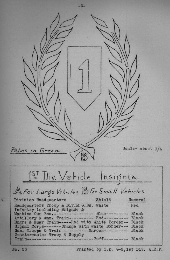

Greetings all,
While technically these (attached) 1st ID Vehicle Markings' Designs are dated Post Armistice, I thought they might be of interest. This 1st post is the first two pages of the memo, and the last page will be on my next post as it was too large to add.

Lance, thanks for adding the info regarding the 1st Division insignia. It's very interesting that the 1st also decided to use color coded backgrounds. I wonder if they did the same during the war or if that decision was inspired by what the 2nd Division had done.

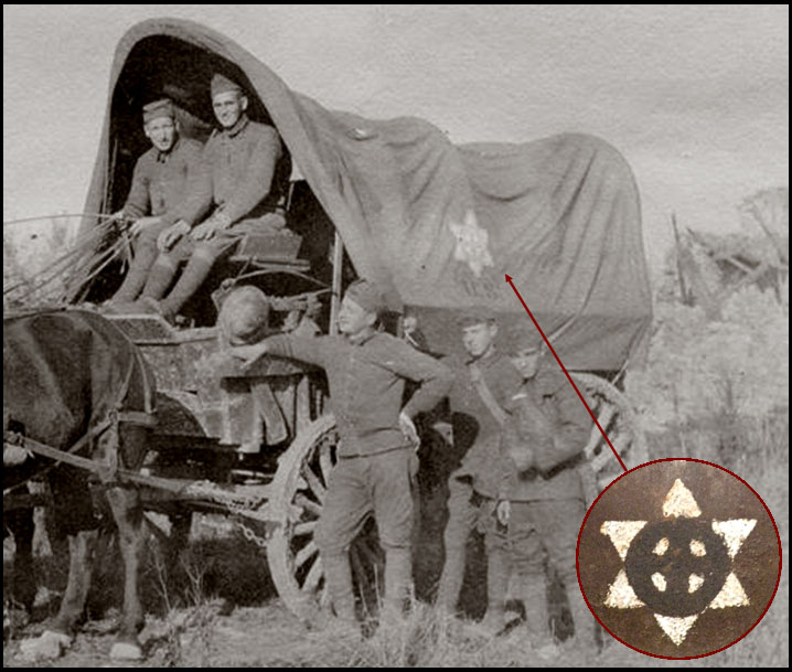

Here's another heavy truck with an unidentified insignia that looks a lot (to me) like a profile of Abraham Lincoln. The soldier partially hidden by the inset appears to be wearing an Adrian helmet. Not sure if this is an AEF truck hauling French tanks or French trucks hauling French tanks, but It's hard to imagine the French Army using an image of Abraham Lincoln (if that's who it is) as a unit insignia. Can anybody ID this insignia?
Photo courtesy of the John Adams-Graf collection

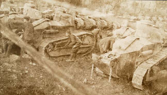

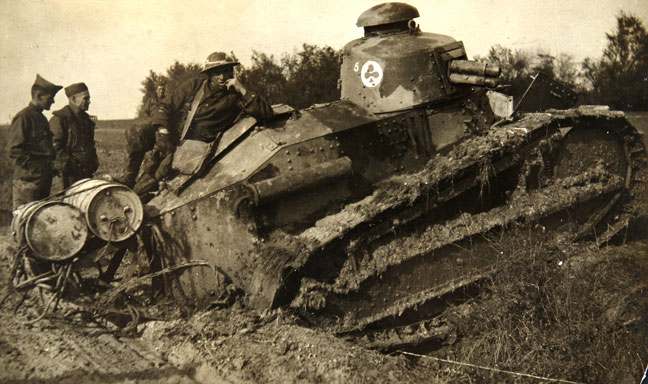

The tank markings are a mysterious, but appealing, facet of the Tank Corps. While it is true that Colonel Patton used playing card symbols as part of an identification system, the idea has been grossly over-inflated by collectors that have allowed a flood of erroneous information and out-right fake insignia to enter the hobby. Fake patches and painted helmets have seen the largest proliferation of supposed Tank Corps insignia.
Basically, in early September after the 1st Tank Brigade combat units, the 326th and 327th Tank Battalions, received some FT tanks, Colonel Patton directed that each tank be marked on the turret so that communication and unit integrity could be maintained on the battlefield. He chose the four symbols of playing cards: hearts, spades, diamonds, and clubs. This denoted the PLATOON. Charles Lemons, former curator at the Patton Museum surmised that these were done in two different colors to denote 326th Battalion vehicles from 327th Battalion vehicles, but no documentation other than photo-interpretation has emerged to confirm that. Dale Wilson, author of "TREAT 'EM ROUGH" states that Patton indicated that the card symbols be painted in BLACK.
These symbols were stenciled on a white background shape, approximately 10" across: Square, circle and diamond. This shape denoted the COMPANY (A, B, and C, respectively).
A small number, 1-5, was painted in white to the side (photos make it appear inconsistent as to which side) of the background shape. This denoted the vehicle within the PLATOON. Furthermore, photographic evidence indicates that this was not universally applied. Photos show many FTs with just the card suit on the white background with NO number painted next to it (as seen on this photo of the destroyed FT 73345 made by Berliet)
This is a Signal Corps photo with a caption that identifies it as a "Company C" tank. It has the number 1 painted to the upper left of the symbol:
These symbols were hand-painted on the TURRETS of FTs prior to loading the tanks on flatcars on September 7, 1918, to proceed to the front. FTs that have similar markings on the rear of the hull are French-operated vehicles. The US system called for markings on the TURRETS as another step for easy identification on the battlefield. Patton basically adopted the French system for marking tanks which was prescribed in a circular from General Headquarters of the Army of Northern and North-East/GQGArtillerie Assault No. 6841 dated June 29, 1918. The circular instructed:

The earliest PERIOD reference to vehicles being referred to as the "Five of Hearts" or the "Ace of Spades" comes only around 1927 in a speech. In Patton correspondence from 1940, reference is made to the “Five of Hearts” in an attempt to identify an FT at Fort Meade. In 1957, an old veteran visiting Fort Meade claimed to have “served in the Five of Hearts.” The particular tank to which all of these sources referred was an FT, no. 1516 and it had a heart on a diamond background with the number 5 painted on the upper left side.
I have found no period references that used playing card reference to a particular vehicle, nor any sort of unit adoption of the symbols as an insignia. The important thing to understand is that a crew of two was NOT assigned to a particular tank. In fact, during the Meuse-Argonne offensive, crews served in whatever tank was available, often serving in up to three vehicles per day. The two crew-members were considered a "team" but the vehicle they drove was parceled out as needed. So, a crew serving in the Five of Hearts one day might be serving in the 3 of Diamonds the next.
These insignia remained on the 1st Brigade combat vehicles ( 326/327 Battalion through the St. Mihiel campaign and then, renumbered the 344/345th Battalions) through the Meuse Argonne up to the end of the war. The symbols were NOT used by other battalions of other Brigades (light or heavy).
In his report on of Tank Corps activities with the 1st American Army at St. Mihiel and in the Argonne, Brigadier General S.D. Rochebach, C.T.C., commented, “…The necessity for a distinctive guidon for Tank Corps units and trucks and a marker for the men was demonstrated and adopted.”

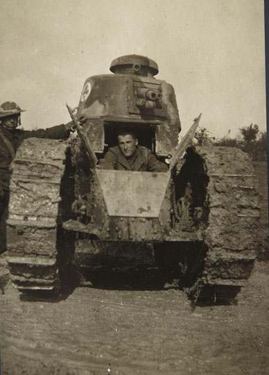

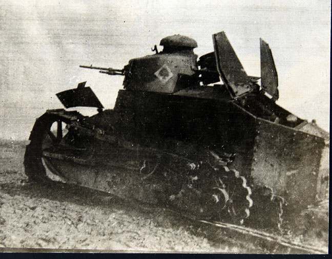

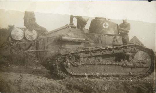

An American-operated FT of B Company (white disc). The club insignia has been inferred to represent Headquarters, though the number 5 would be too high--Company HQ only had 2 tanks). Still a mystery as to what the Club denotes.

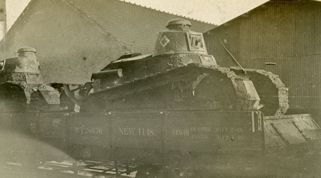

Add to the Club mystery, an FT on a French rail car of C Company (white diamond background) with a CLUB symbol and the number 5.

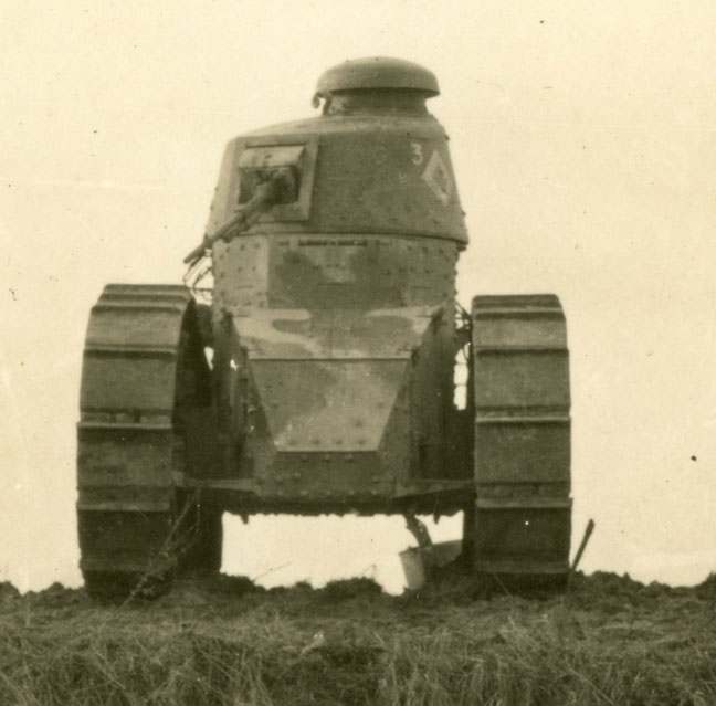

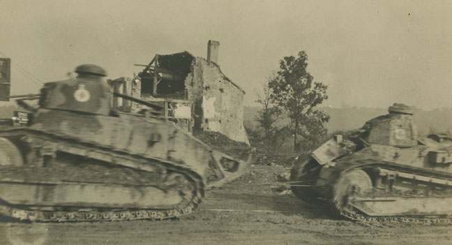

A variation on the theme seen in this photo of an FT pulling another one. The vehicle on the left is marked with a DIAMOND on a white circle background (3rd platoon, B COMPANY) with the number "2" painted ABOVE the disc. It is pulling an FT that appears to be marked with a spade or club on a SQUARE background (Company A) with NO number painted next tot he symbol.
A Hotchkiss-armed FT with a diamond in a diamond background (3rd Platoon COMPANY C), with the number "3" painted in the upper left.

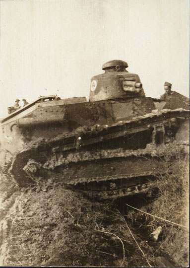

I have a series of tiny snapshots of this tank, though no provenance attached. It is one of my favorite shots of American-operated FTs. I don't know, but I feel it was taken immediately after the Meause-Argonne action. Following the St. Mihiel offensive during which many US-driven FTs ran out of fuel, Patton ordered that those drums of fuel be carried into action. This proved to be a mistake for at least one tank whose commander said, he felt a great heat rising as he rode with his legs dangling through the turret back doors. Apparently, hostile fire had punctured the drum and ignited the fuel!
Here are the others of the tank with the club insignia (NOT the one that caught fire!):

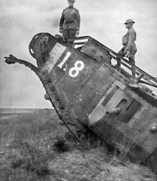

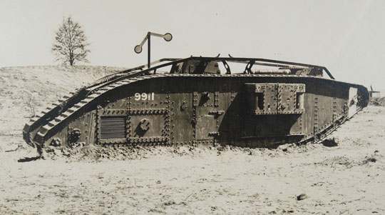

Heavy Tanks are even tougher to sort out! As you and most know, the Heavy Tank Battalions were US units assigned to British formations. The US provided the men, uniforms, and pay, but the British provided the command structure and the tanks.
Only one battalion, the 301st, was used in combat, assigned to the 4th British Tank Brigade and then to the 1st Tank Brigade. The battalion did not receive any tanks for its own use until August 30, 1918, after it embarked from Southampton for Le Havre and finally arrived at Erin. In mid-September, the Batttalion learned it would be joining the British Fourth Army in an attempt to breach the Hindenburg Line. On September 19, the 301st learned it would be part of the British 4th Tank Brigade's, and in particular, would be supporting the the US 27th Infantry Division's attack.
On September 20-21, the Battalion loaded its 47 tanks, a mix of Mark Vs and Mark V*s ("mark five-star"). By this point the 301st had had its tanks for a total of 21 days--3 weeks.
The 301st tanks were all previously British-operated tanks that had been redistributed to the Americans. Many came from the 10th and 14th British Tank Battalions. As such, many of the US-driven tanks that went into action on September 29, still bore the markings of the their previous British operators.
The basic markings on all Mark V and V*s were thus:
*The left and right horns (front of the each side of the tank) had three hand-painted stripes, each about 12" wide: White-Red-White (sorry, the above photo is post-Armistice and shows a 301st tank with just White-Red). The pattern was repeated on the top and back of the "cabs" on top of the tanks. These were battlefield and air recognition markings, deemed necessary after the Germans fielded many captured Mark IV rhomboid tanks after the Battle of Cambrai. AFTER the 301st returned to the US, this practice was modified to use the stripes in different combinations to denote a tank of a particular company.
*Census number (also known as registration number). The four-digit number was painted in white on the rear of each hull side above the ventilator grille.
That's it for markings. SOME tanks, however, bore "personalized" markings, the most obvious were the tanks reassigned from the 10th British Tank Battalion. These were marked with a large, white, hand-painted vehicle number preceded by the letter "J" (designating the 10th Company.). So far, I know that the 301st operated tanks that were marked with J4, J7, J19, J21, J22, and J41.
Other tanks, transferred to the 301st from the 14th British Tank Battalion, bore the number and name combinations: "N8 Neptune," "N11 Natal, " and N02 Newmarket." Other recorded markings I have of 301st-operated tanks include "BISON III", "Baby Doll" (probably painted post-Armistice), "H01," and "I.2."
One soldier wrote home that their tank was named the "ANGLIN" (no 9111) in honor of an English girlfriend. He didn't say, however, if they painted the name on the tank, but rather, simply said they named their tank after the girl.
The most unusual, however, appears in the history of Company A, 301st Tank Battalion: No 9604 has a large yin-yang symbol painted on both horns. Groups of Company A tankers posed for their portraits in front of this tank, and yet, I can't find record that any group 301st tankers actually drove this tank! It was likely a 301st Tank, however, because it ended up in the United States after the war. An important aside: All marking conventions identified pre-armistice are out the door in the post November 11 world. The 301st, when it returned to the United States with its tanks, now knew they were "THEIR" tanks. Therefore, new marking conventions were established to identify tanks within the battalion.
