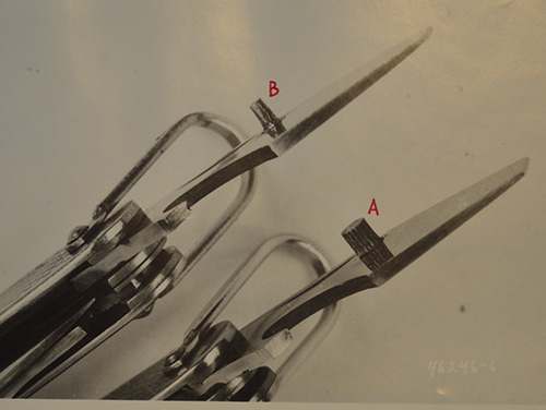

dustin Posted December 11, 2016 #1 Posted December 11, 2016 I recently obtained a series of board reports on the all metal utility knife from 1944 thru 1945. It has been my understanding that there has been some deliberation on the purposed of the stud on the screw driver blade. In one of the infantry board reports, September 1945, it is fairly specific on this detail. attached is figure. 5.

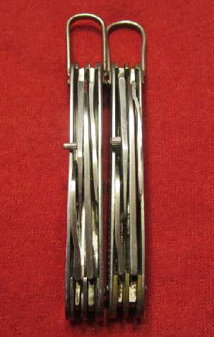

Misfit 45 Posted December 11, 2016 #3 Posted December 11, 2016 That is great information. I have about 7 or 8 brass liner Utility knives from WWII and all of them have the wider stud. I would suspect that it took a few years to implement the narrow stud on the screw driver. In this picture, the left pocket knife is a post war Ulster blade marked with steel liners. On the right is an Ulster 48 with brass liners. Thanks for showing this document. It's going into my files. Marv

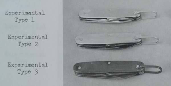

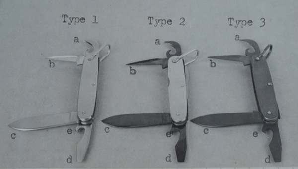

dustin Posted December 11, 2016 Author #9 Posted December 11, 2016 Here are the experimental types from 1944 tested by the Infantry Board as detailed in the a record of test of December 1944
Misfit 45 Posted December 11, 2016 #10 Posted December 11, 2016 That is amazing. Can we assume from this that full production actually did not occur until 1945, rather than November 44 as I have heard and read? Also, Even though I have seen well used utility knives that have somewhat darkened blades, would it be correct to conclude that the Type 1 polished bright knives were the final version selected? (there is no mention of brass liners). Wow, this is quite a paradigm shift! The progression might be that the little knives were indeed made in November 1944 and it was then assumed by collectors that they were ISSUED in November 44. It could have been December 44 or January 1945 or later before the knives reached the troops. Thanks again, dustin. Great work! Marv
dustin Posted December 11, 2016 Author #11 Posted December 11, 2016 I havent fully dissinemated the information yet a few hundred pages but the field tests concluded at the end of 1944 utilizing the three knives in Post#9. So from my limited preliminary cursory overview they were only experimental at the close of 1944. The doc in Post#7 is quite clear that issuance is projected in late 1945. The way it looks right now is the collector understanding is one year off base. The documentation I have starts in the spring of 1944 with indorsements for the knife's development followed by infantry board reports from late 1944 and several from 1945 each incorporating new design changes and testing. I remember having some USMC knives with blackened or oxide blades and it appears this is the first type as noted in Post#8. I cannot really comment too much on this as I don't know a lot about these knives nor do I have any examples anymore for observation. Maybe next week I'll take the time to read it all and make an outline of the development progression. As far as I know the best article on these knives is titled The MIL-K Knife by Dennis Ellingsen and am not sure if anyone has done a follow up yet.

Misfit 45 Posted December 11, 2016 #14 Posted December 11, 2016 In post #7 the availability is projected as December 1945, but it also shows the photo of a SECOND version knife (screw driver opposite main blade) which also includes blackened blades. Do you think that the article might be referring to the availability of the second version knife, and the first version was already issued; awaiting full standardization? Marv Also, there are no studs on the screw drivers on the knives in post #9

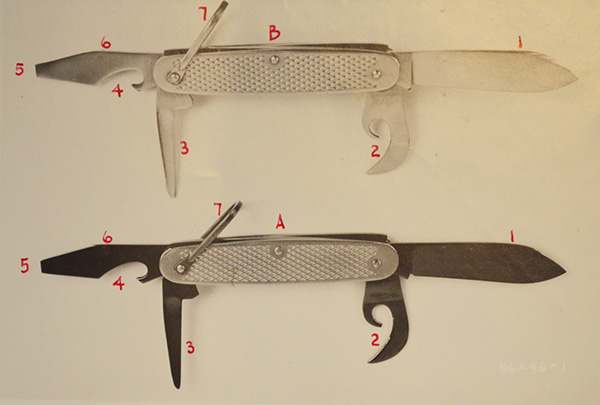

dustin Posted December 11, 2016 Author #15 Posted December 11, 2016 here is a series of interest I think.
