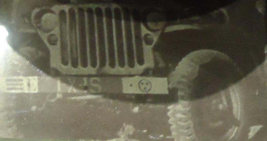

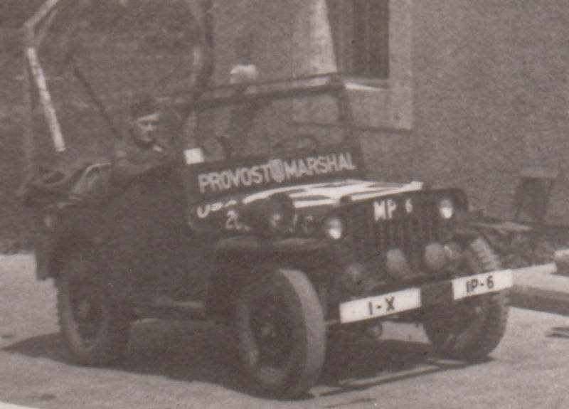

Johan Willaert Posted October 11, 2016 #12 Posted October 11, 2016 Here are a few I found in my old files

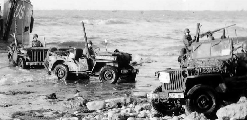

Johan Willaert Posted October 11, 2016 #20 Posted October 11, 2016 Omaha Beach, tacsign on left rear side of Dodge, just forward of star

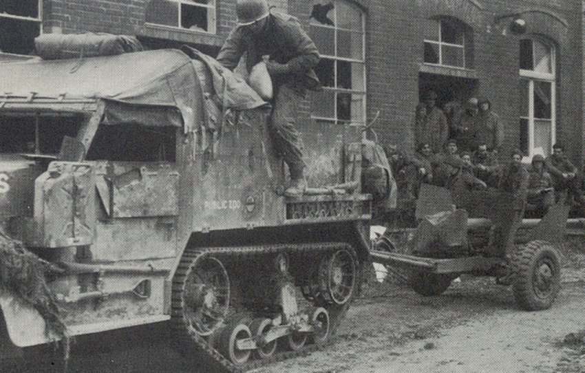

Johan Willaert Posted October 11, 2016 #22 Posted October 11, 2016 16th Infantry, Anti Tank Company Half Track
Johan Willaert Posted October 11, 2016 #23 Posted October 11, 2016 Ooops wrong picture above... 16th Infantry, Anti Tank Company Half Track
