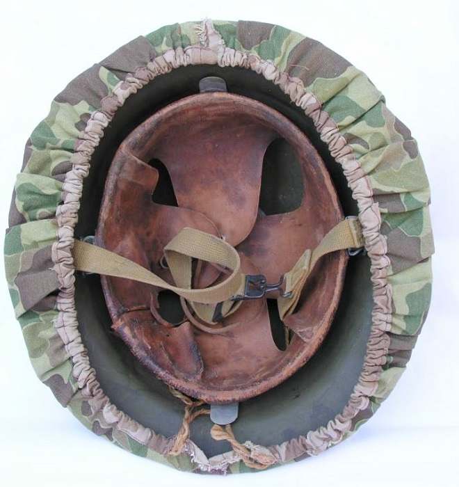

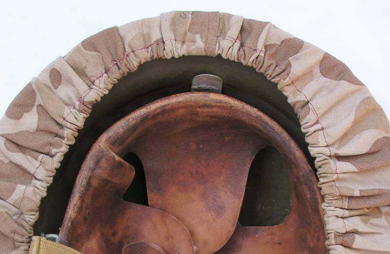

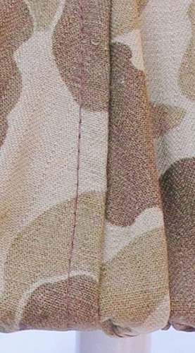

The construction of my cover does differ than the other two seen in that it does not have a true "USMC Cover chain stitch center seam". It is simply two pieces of HBT sewn together using a similar type thread as used on the rolled edge, however the overall construction method, material, edge roll, and drawstring does include it with the others.
If those are judged to be fakes that's fine, then mine must be a cheap knock off of a repro'ed fake. :D If mine helps in some way to determine one way or the other that's great too as it was the first one to surface two years ago. Here are a few photos -

All I can say is that I'm quite sure that Private Joe over in the depot had a supervisor, and that supervisor would have never let anything of this poor quality out of his shop. I have been collecting and selling WWII militaria for almost 40 years and I have never seen depot or field repair using that type of thread. And why wouldn't dead stock mint material(shirts) be available post war? I personally found a huge piece of Vietnam tiger stripe material last year at an estate sale and dead stock USMC camo uniforms are not that uncommon. US items were really not that much in demand until the early to mid 1990's. All I know is my 40 years of collecting this stuff and the 30 years I spent in the military as a parachute rigger, this would not have held up in the filed for more than a couple days and how can we explain the two different thread type and remnants of a pocket sticking out of the seam? I am appalled at the so called helmet collectors even entertaining the idea that this is real. Maybe a re-enactor or faker lives near Camp Pendleton? And that is also just a story, you really have no idea where these came from.

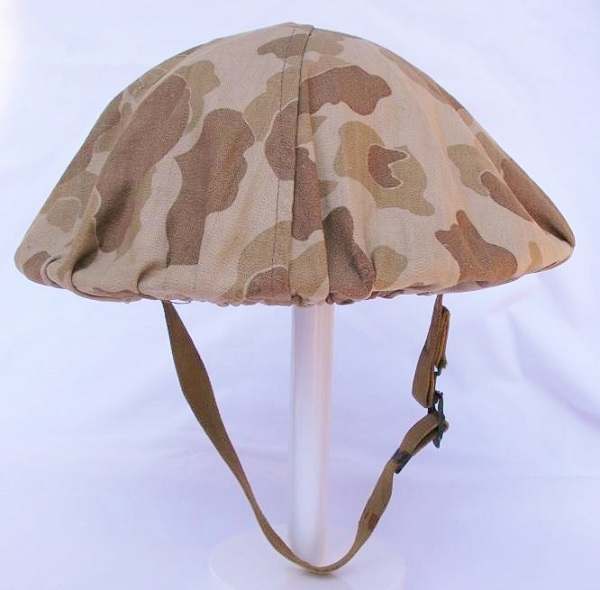

CG, here is a pic of the number at top. As I said I am not sure what it represents and I'm glad some uniform guys chimed in as well with their knowledge here, that one is a nice example of how they may be found marked, (thanks airborne53).
I left it on the helmet for now so a good size representation can be made making it not fully visible. It is the same size as the other cover I showed with the stamped "71".

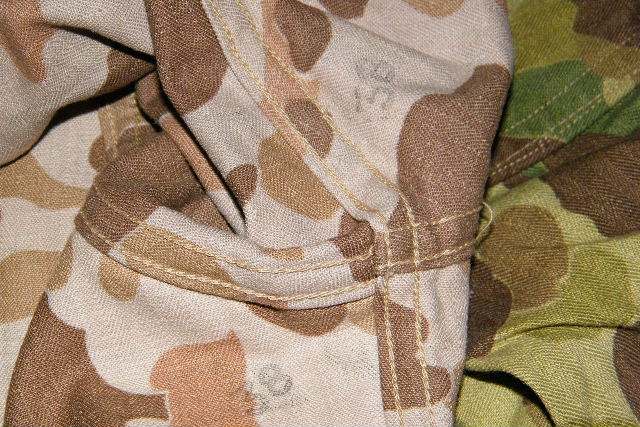

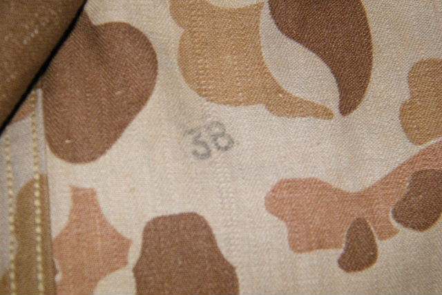

Just for intrest in discussion,here is a P44 shirt from my collection.I took the first one on the pile and reversed it to the tan / beach side.This shirt is maked 38.It is marked in 4 places.The numbers all are of the same consistant font and size.They measure almost 10mm or right at 1/2 inch in height.(photos posted below)
This is just discussing the theory of it being from a P44 shirt and there isnt any arguement about 17a1s not being used in testing.(by myself).The other thing that would be intresting is to examine the covers on the 17a1s and ask is there any noticible seam in the construction of the camo test examples or cloth covers that are consitant with a shirt or coveralls.
Right sleeve and chest near armpit where sleeve and shirt body join
Left sleeve and chest area by the armpit where body and sleeve join
Photo of the number on the main body panel
Here you can see the full body panels of the front and the numbers(38) are seen near the armpit on righ and left side.

I see what you are saying now. It doesn't make much sense why an early/pre war experimental cover would be made out of a jacket produced almost 3 years later...
Is this piece still neat, yes. Do I believe that it was produced for the tests in 1941/42, no.

There are some serious jump suit repros done in the 1980s that are accepted as originals.Real jackets and trousers were used.Period thread and canvas.Aged or worn and now its a DDay set.But the sewing details(or lack of) are the things that give these away in the end.With the jump suits one of the biggest traits is the sewing pattern and thread used.I can say I still have a hard time with reinforced suits.
Vintage cotton thread isnt hard to find.Finding the same type or cord-fiber thread isnt easy.Pretty much any auction here in the area on any given weekend you may find old sewing baskets with cotton thread or antiques shops as well.I even know a guy whos cousin runs an uhpostery shop and he has and still uses two of the industrial sewing machines that came out of one of BOYTs WW2 factories in Iowa Falls Iowa after the war.The machines are great for sewing as they can handle thick leather or canvas.he will use the doindg boat,car or truck seat covers and will even repair web gear but getting him to use vintage thread isnt always workable.
