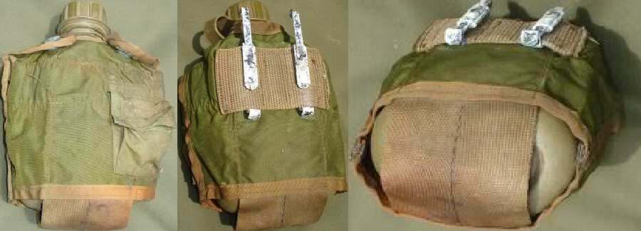

15 APRIL 1970 - the initial trials of the LINCLOE LCE were less than stellar and some components were redesigned for the future “second generation” trials. The nylon water canteen cover was completely redesigned (in an attempt to reduce its overall weight) with the bottom removed and replaced with nylon webbing. The acrylic pile inner lining was removed and the plastic snap fasteners were replaced with metal ones. Further, the plastic belt-strap keepers were also complete failure and thus were replaced with standard metal belt-strap keepers.
BELOW: the “second generation” trial LINCLOE LCE nylon COVER, WATER CANTEEN:
The “second generation” trial nylon water canteen cover continued to be utilized throughout the remainder of the LINCLOE LCE trials (lasting through 1972). When the LINCLOE LCE system was being considered for adoption the “second generation” trial nylon water canteen cover was type classified and assigned the nomenclature COVER, WATER CANTEEN and the Federal Stock Number 8465-001-6472. On 31 October 1972, the “second generation” trial nylon water canteen cover was rejected in favor of using the standardized M-1967 LLCE nylon water canteen cover. The reasons for rejection of the “second generation” trial LINCLOE LCE nylon water canteen cover are detailed in the book.

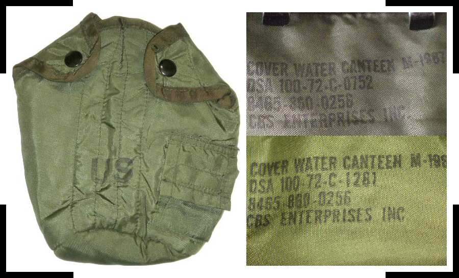

FY1972 - only two (2) known manufacturing contracts were awarded, for the COVER, WATER CANTEEN, M-1967, during FY1972. Both contracts were manufactured to MIL-C-43742 (21 June 1971) specifications:
DSA100-72-C-0752: was awarded to CBS ENTERPRISES (CAGE Code 1F958) of West Hollywood, Florida. The contract was let in December 1971 (second quarter of FY1972) with an estimated completion date of May 1972.
DSA100-72-C-1281: was also awarded to CBS ENTERPRISES of West Hollywood, Florida. The contract was let in March 1972 (third quarter of FY1972) with an estimated completion date of December 1972.
BELOW: the two (2) FY1972 contract dated nylon COVER, WATER CANTEEN, M-1967 which were manufactured to MIL-C-43742 specifications. The image shows both FY1972 Procurement Instrument Identifiers (PII or “contract number”). These nylon water canteen covers are part of the M-1967 Lightweight Load-Carrying Equipment (LLCE) system:

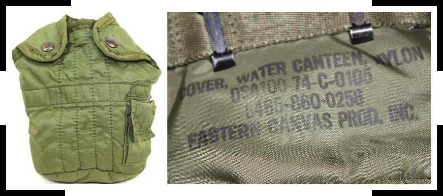

FY1974 - four (4) known manufacturing contracts were awarded, for the COVER, WATER CANTEEN, M-1967, during FY1974:
DSA100-74-C-0105: was awarded to EASTERN CANVAS PRODUCTS INC of Corozal, Puerto Rico. The contract was let in July 1973 (first quarter of FY1974) with an estimated completion date of April 1974. This contract was manufactured to MIL-C-43742, Amendment 1 (20 December 1972), specifications.
BELOW: the first FY1974 contract dated nylon COVER, WATER CANTEEN, M-1967 which was manufactured to Amendment 1, of MIL-C-43742, specifications. This nylon water canteen cover is part of the All-Purpose Lightweight Individual Carrying Equipment (ALICE) system:

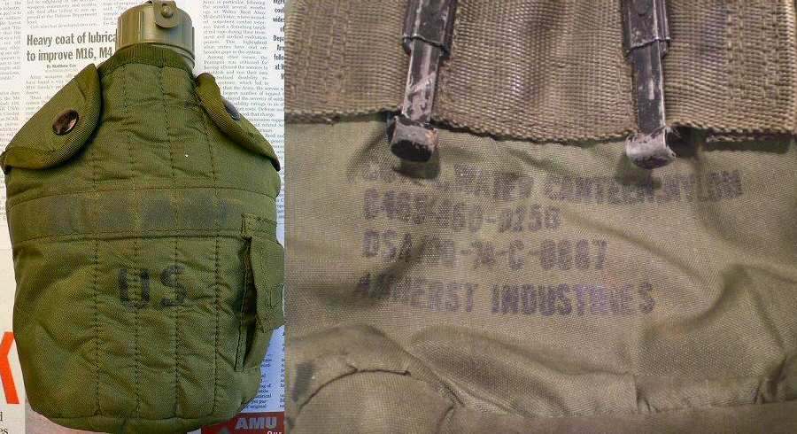

DSA100-74-C-0887: was awarded to UNITED STATES SMALL BUSINESS ADMINISTRATION of Riverdale, New Jersey. The contract was let in February 1974 (third quarter of FY1974) with an estimated completion date of August 1974. This contract was manufactured to MIL-C-43742 Amendment 1 (20 December 1972) specifications.
This contract was obviously "sub-contracted" as the early production covers are manufactured by AMHERST INDUSTRIES (and are marked with Federal Stock Numbers). Later production covers are manufactured by WESLEY AND PINE INC (CAGE Code 6B982) and are marked with National Stock Numbers.
During my early research into the ALICE system, Carter Rila helped me out with some information he had gathered for his unfinished manuscript (entitled Accoutrements Of The U.S. Army 1921-1985). One piece of information that he relayed to me was concerning the WESLEY AND PINE debacle. It seems this company (which also had contracts to manufacture nylon flight helmet bags) decided to produce nylon water canteen covers for the civilian commercial market at the same time they were fulfilling their government contract.
The nylon water canteen covers produced for the commercial market were of inferior quality to those they were producing for the government contract. They used lighter weight nylon duck and the stitching was not up to mil-specs. The company ran afoul with the government as they decided to mark these nylon water canteen covers with the actual Procurement Instrument Identifiers that they were putting on the government contracted ones, which is not allowed (most companies that do this get around the government regulations by using a fictitious Procurement Instrument Identifier). A government contractor cannot put a current government Procurement Instrument Identifier (that they are awarded and working to fulfill) on the same item to sell for civilian consumption. Once the government got wind of what WESLEY AND PINE were doing they filed an injunction and other governmental legal action was taken. Carter had provided me a link to the original government suit against WESLEY AND PINE, but I have long since misplaced it - and now I cannot seem to find anything on the internet about the case.

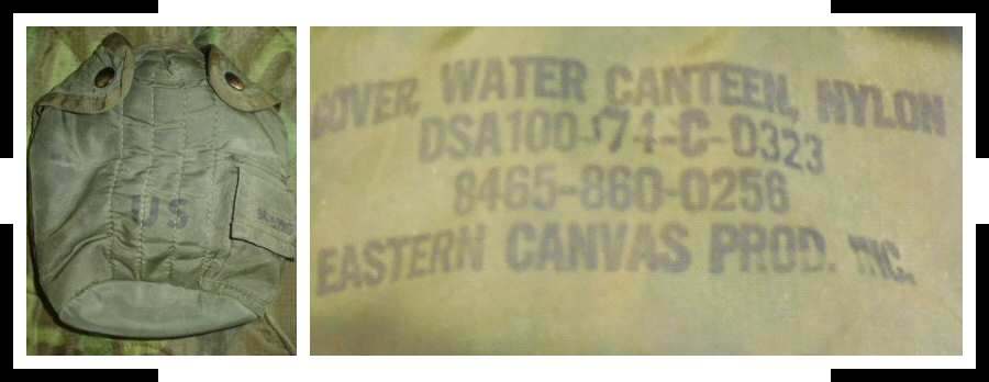

BELOW: the third FY1974 contract dated nylon COVER, WATER CANTEEN, M-1967 which was manufactured (by AMHERST INDUSTRIES) to Amendment 1, of MIL-C-43742, specifications. This nylon water canteen cover is part of the All-Purpose Lightweight Individual Carrying Equipment (ALICE) system:
BELOW: the inferior WESLEY AND PINE commercially manufactured nylon COVER, WATER CANTEEN, M-1967 with actual Procurement Instrument Identifiers from the DSA100-74-C-0887 manufacturing contract:

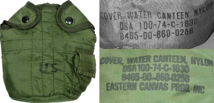

DSA100-74-C-1630: was awarded to EASTERN CANVAS PRODUCTS INC of Corozal, Puerto Rico. The contract was let in April 1974 (fourth quarter of FY1974) with an estimated completion date of February 1975. This contract was manufactured to MIL-C-43742 Amendment 1 (20 December 1972) specifications.
BELOW: the fourth FY1974 contract dated nylon COVER, WATER CANTEEN, M-1967 which was manufactured to Amendment 1, of MIL-C-43742, specifications. Two (2) label variations are illustrated: one (1) without the contractor’s name and one (1) with the contractor’s name. At this point the Federal Stock Number system has been totally phased out of service, replaced by the National Stock Number system. The National Stock Number is the same as the Federal Stock Number but with the additional National Codification Bureau Code of “00” (which indicates the United States and the item was “in the system” prior to September 1974). This nylon water canteen cover is part of the All-Purpose Lightweight Individual Carrying Equipment (ALICE) system:

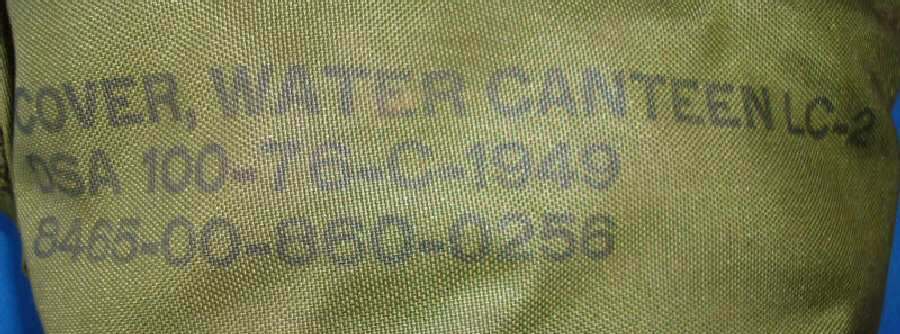

DSA100-76-C-1949: was awarded to K P B INDUSTRIAL PRODUCTS INC of Hillsboro, Wisconsin. The contract was let in September 1976 (first quarter of FY1976T) with an estimated completion date of September 1977. This contract was manufactured to MIL-C-43742A (7 November 1975) specifications.
BELOW: the second FY1976 contract dated nylon COVER, WATER CANTEEN, LC-2 which was manufactured to MIL-C-43742A specifications. This nylon water canteen cover is part of the All-Purpose Lightweight Individual Carrying Equipment (ALICE) system:

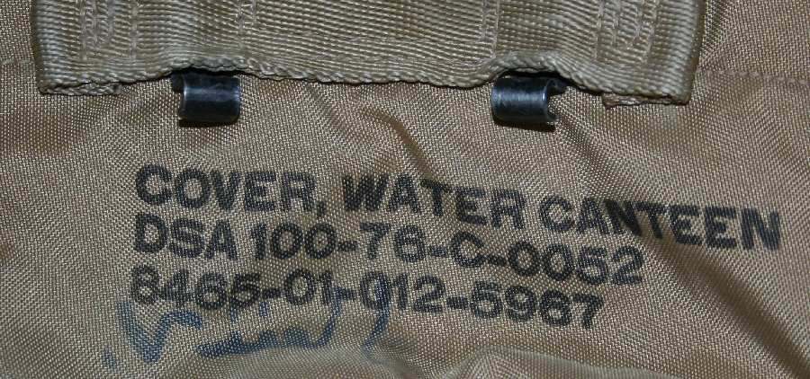

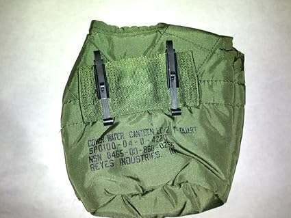

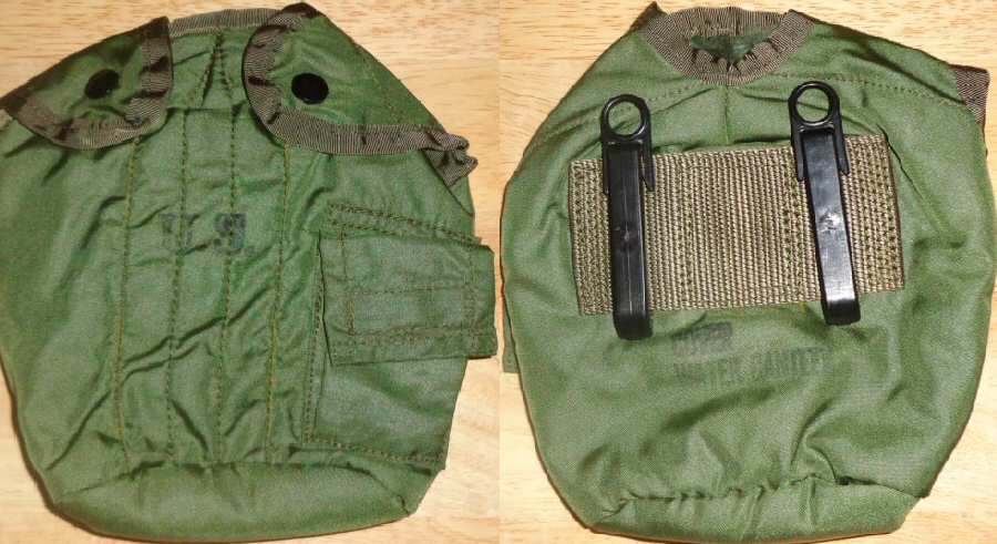

Since FY1976T, the nylon COVER, WATER CANTEEN, LC-2 has been continuously manufactured. The most recent manufacturing contract, SPM1C1-13-D-F503, was let in FY2013 to UNICOR (CAGE Code 82125). Additional awards to the above manufacturing contract, also to UNICOR, were made in 2014, 2015, and most recently for 6,525 units on 12 January 2016.

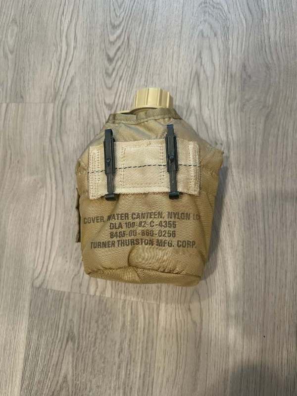

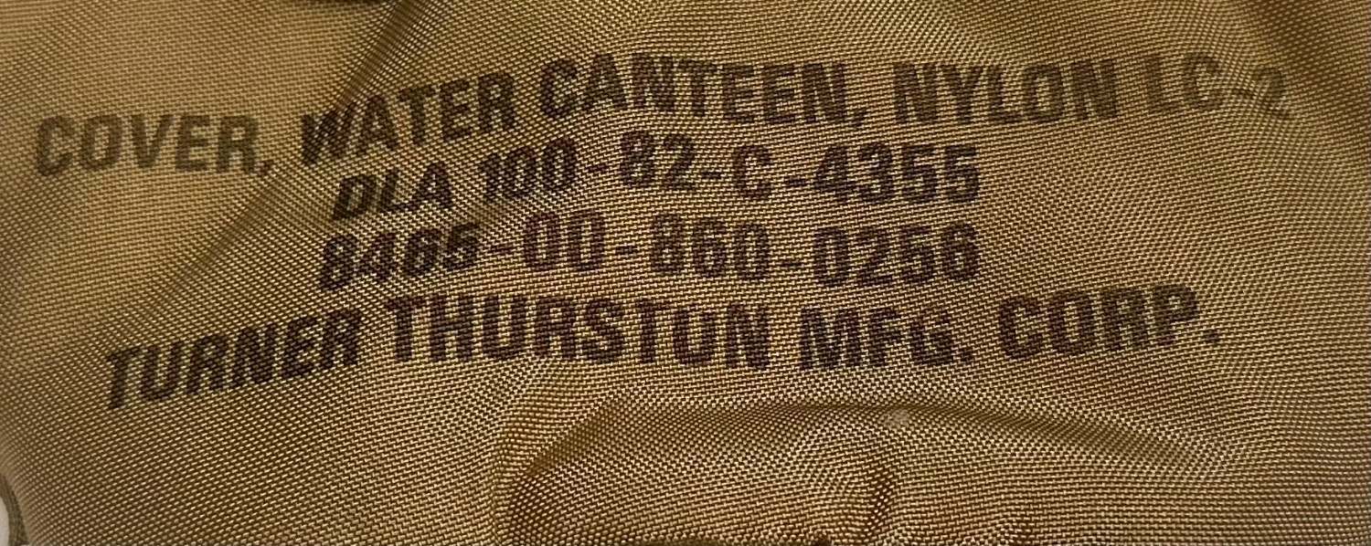

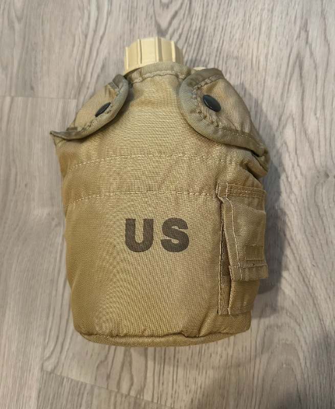

So keeping with the timeframe of this post...in January 1976, Foreign Military Sales (FMS) contract DSA100-76-C-0052 was let to K P B INDUSTRIAL PRODUCTS INC of Hillsboro, Wisconsin for the US Army Tan Shade 96322 nylon duck Saudi Arabian Army COVER, WATER CANTEEN, LC-2 (National Stock Number 8465-01-012-5967).
BELOW: the back of the Saudi Arabian Army tan nylon COVER, WATER CANTEEN, LC-2:
BELOW: the Natick Laboratories designed US Army Tan Shade 96322 nylon duck and web ALICE system for the Saudi Arabian Army:

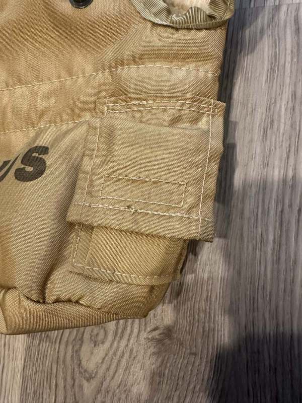

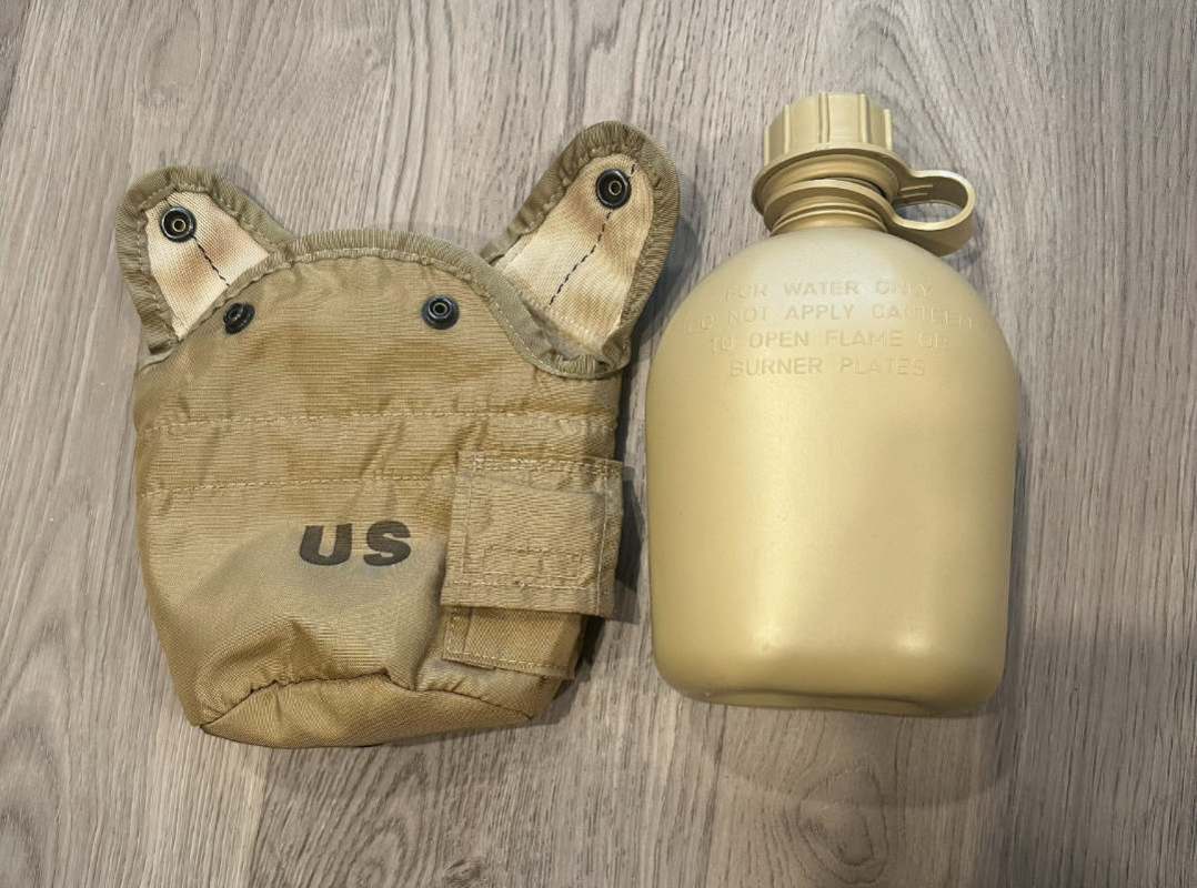

I have a quick question for canteens. Was there ever an official US military canteen cover where the water Purification pouch is double wide? I have one in my collection and it is up to military standards and grade but it just has that double wide pouch and the US Symbol close up to the top.
Quote
Simply put: whether it is ERDL, woodland, 3-color desert, 6-color desert, black, "desert tan”, Flecktarn, ACU, MARPAT, etc., there has been no other color (besides OG-106) contracted for manufacture for use by the United States Government.
First, canteen covers have been mass produced and issued in Camouflage Green 483 instead of OG106 since the mid 90s. So this statement is incorrect. This color change is most frequently seen on Unicor canteen covers but also on Reyes Industries canteen covers contracted in 1995.
Also, I have this clearly genuine desert canteen pouch that I recently picked up on Ebay to prove desert canteen covers do exist (Albeit extremely rare). Notice from the pictures that it was contracted in 1982 around the same time a lot of 6 color desert camo uniforms were contracted and it even has a matching canteen that was made only 2 years prior. That and the verifiably real government contractor, Turner Thurston (whose name is mostly found on shotgun ammo pouches from the early 80s), with all the appropriate nomenclature is pretty hard to refute. Due to the extreme rarity of this pouch and the year it was contracted, it was most likely a test item and certainly never saw widespread issue. However, it does in fact exist. So making bold claims that OG106 is the only color ever contracted is simply incorrect.
I can't find the 1995 example I had seen but here are just a couple of the many easy to find examples of camo green 483 canteen pouches from various surplus websites.
