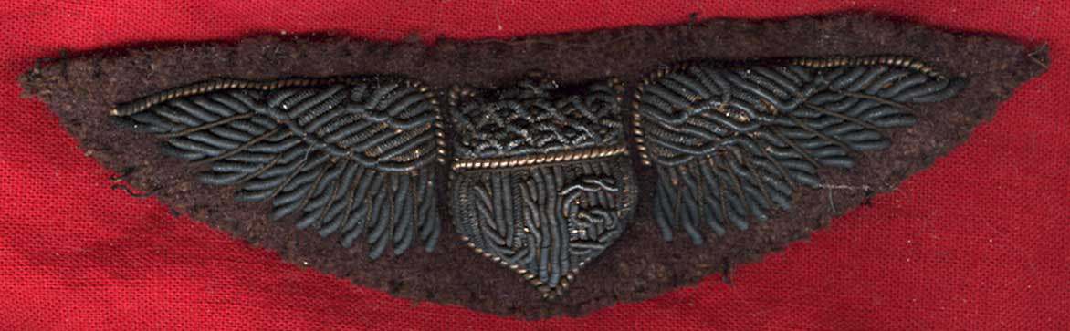

cwnorma Posted September 10, 2008 Share #13 Posted September 10, 2008 Very good, thank you. Let's make this even more interesting by throwing a bullion wing (metal backing plate) in the mix. I know these are easily faked, but look at the ageing and wear on this. If it is a fake, it is one of the most convincing I have seen to date. If I was a betting man, I would say that this is 100% legit. IQ, This is a good wing, but the aging and wear are not what makes it good, its the construction and three dimensionality of the way the bullion is executed. You are also correct that this is not an English made wing. It is a classic "American" style wing. Chris Link to comment Share on other sites More sharing options...
IMPERIAL QUEST Posted September 10, 2008 Author Share #14 Posted September 10, 2008 Hi Chris, All of these come from Snyder's Treasures...Charlie Snyder has quite a reputation. Yea, I know.... This is a good wing, but the aging and wear are not what makes it good, its the construction and three dimensionality of the way the bullion is executed. You are also correct that this is not an English made wing. It is a classic "American" style wing. Thank you Chris for the confirmation. This one just jumps out at me as saying "I HAVE BEEN THERE!" BTW...have any idea how the backing material and bullion is attached to that backing plate??? Thanks again for your input on all... Link to comment Share on other sites More sharing options...
cwnorma Posted September 10, 2008 Share #15 Posted September 10, 2008 BTW...have any idea how the backing material and bullion is attached to that backing plate??? IQ, I can't see any stitches, so I am going to guess it is somehow glued on. I don't see anything wrong with the backing plate/pin combination, but I have to say it is a little weird the way it is constructed--never seen one quite the same... I am pretty certain the wing on the front is good, I won't vouch for the backing plate, but I also don't have any problem with it. If I found this wing "on the loose" I wouldn't have any issues with it at all. Chris Link to comment Share on other sites More sharing options...
IMPERIAL QUEST Posted September 10, 2008 Author Share #16 Posted September 10, 2008 IQ, I can't see any stitches, so I am going to guess it is somehow glued on. I don't see anything wrong with the backing plate/pin combination, but I have to say it is a little weird the way it is constructed--never seen one quite the same... I am pretty certain the wing on the front is good, I won't vouch for the backing plate, but I also don't have any problem with it. If I found this wing "on the loose" I wouldn't have any issues with it at all. Chris Chris, Glued on was my thought as well. I have been contacted by more than one person after posting this to further expand on the seller's reputation. The wing is offered at a very good price I think, but I have been told in no uncertain terms to stay away at all costs. I get the feeling that I would come out on the losing end, so I will play it safe and digress. I have waited over twenty years for a good wing, so a while longer won't kill me. Link to comment Share on other sites More sharing options...
pfrost Posted September 10, 2008 Share #17 Posted September 10, 2008 In regards to the bullion wing. I suspect at one time, the backing was wrapped totally around the plate (like you see with the other Dallas 1/2 wing). Over time, the material starts to wear along the edge of that backing plate, and it eventually cuts the fabric like a knife. I suspect that someone may have trimmed off the old fabric just leaving the stuff on the front of the plate. It may be glued or it may be just sitting there. I have seen a number of interesting Bullion wings with backing plates like this. I have even seen bullion wings with a silk backing sewn over the stitching and then a safetypin being used to secure it to the uniform. Patrick Link to comment Share on other sites More sharing options...
Gary Cain Posted September 10, 2008 Share #18 Posted September 10, 2008 I will toss in my two pennies, I agree with Chris that the Bullion is good. I think the plate is a 1920's replacement however. Patrick, I don't see any evidence of fabric having covered the plate in the past. I have seen wings like you describe but I don't think this is one of those. Cheers Gary Link to comment Share on other sites More sharing options...
pfrost Posted September 10, 2008 Share #19 Posted September 10, 2008 If you look at the edge of the plate, alongside the scalloped edges on the underside of the wing, you can see excess fabric sticking out. If this the result of a wing being cut to fit a plate and then glued on, it isnt logical that the excess fabric would remain. The plate seems to have always been intended for the wing. Note the top part of the shield of the bullion wing comes to a very obvious point. Also note that the top part of the plate comes to an obvious point. IMHO, these things were intended to be together. Of course, without handling it, its hard to know for sure, but it sure seems that their is excess fabric. Patrick Link to comment Share on other sites More sharing options...
pfrost Posted September 10, 2008 Share #20 Posted September 10, 2008 Here is something that may help with bullion wings. A few years ago, a very advanced collector sat down and spent a few moments educating me. One of the things he talked about was "sun aging" or "bleaching" of the fabric of a wing. This is especially true of wings that saw a lot of wear and tear. He said that a wing will show different bleaching patterns if it is due to age as opposed to artificial aging. Because of the process involved with artificial aging (usually done with a bleach or other similar liquid) you almost always get BOTH the front and back of a bit of fabric bleached...the liquid soaks through and so both sides will be the same. On the other hand, natural aging will only affect the surface that faces the sun. IF a wing was sewn on a uniform, for example, then the underside should be protected and a darker color. So, if the front and back are different, then you should have a better confidence that the aging is natural. I recently got this wing on a bit of the original uniform. I took it off because the fabric was getting mothed and I didnt want any damage to the wing. First the front. Notice that the bullion is heavily tarnished and the black wool fabric has bleached to a brownish color. Link to comment Share on other sites More sharing options...
pfrost Posted September 10, 2008 Share #21 Posted September 10, 2008 Now the back. This wing has likely been protected from sun for decades. You can see that the back side of the fabric is much darker. It is more obvious in person, but you can clearly see the difference. Also, the white backing threads are nice and clean and bright. Again, proof that they were protected, while the front of the wing was exposed. Link to comment Share on other sites More sharing options...
