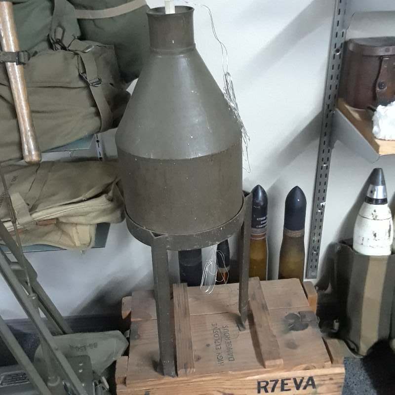

TheGrayGhost Posted February 24, 2016 #2 Posted February 24, 2016 Very nice! Don't see these too often. Nice to see one that isn't over painted as well. I ended up having to make my own reproduction because I couldn't find an original.
Blackops Posted February 26, 2016 Author #4 Posted February 26, 2016 Thanks just waiting for the summer to display at the shows...still look for some priming adapter M1A1 can any one help...
Dirt Detective Posted February 28, 2016 #5 Posted February 28, 2016 Very cool...I know nothing about these...any info of this item? Size? Year made? ect.. Thanks, Mike
Blackops Posted February 29, 2016 Author #6 Posted February 29, 2016 Hi Mike. The height is 430mm x 210mm give or take a mill you can find more information in Ammunition General I hope this helps Thanks Phil

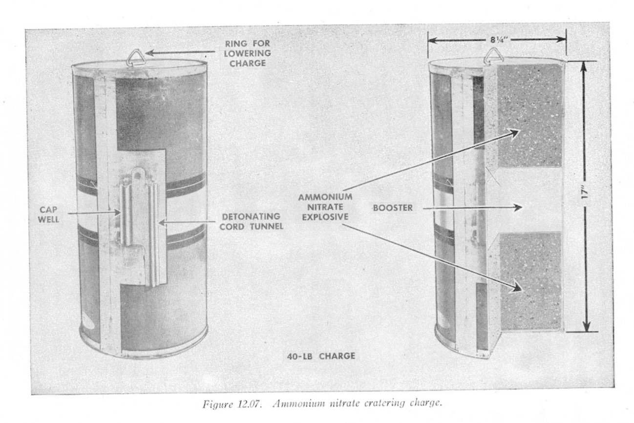

TheGrayGhost Posted March 2, 2016 #9 Posted March 2, 2016 From May 1945 FM 5-25 Explosives and Demolitions:
Dirt Detective Posted March 3, 2016 #11 Posted March 3, 2016 Thanks Grayghost, great info, that's the stuff I was looking for.... 40lbs...wow.

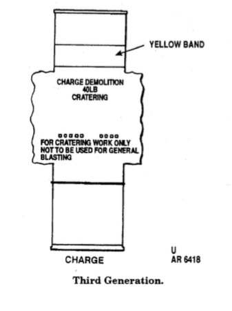

EODsmity Posted March 9, 2016 #12 Posted March 9, 2016 Do you have a 40lbs shape charge to accompany it? The 40lbs shape charge uses a glass cone, which is cool!!! Also, there are 3 generations of the 40lbs cratering charge. Here are the differences: The 40-pound cratering demolition charges are watertight cylindrical metal containers with approximate 39 pounds of H-6 explosive. A semicircular angle is located on the top of the container for handling the charge or lowering it into a hole. The first generation charge has a booster charge of 0.43 pounds of composition A-5 posi- tioned at the top of the main charge to facilitate priming from the top, Two priming tunnels are therefore located on the top surface of the charge along with a steel lifting handle and a blasting cap wire-securing post. The second generation charge is an interim design that may or may not have a booster and priming tunnels similar to the first generation charge. Due to a technical irregular- ity in production, it must be treated as if it has no internal booster and must be primed with external booster charges. The third generation charge is designed to be easily initiated with detonating cord. Dual detonating cord tunnels are on the top surface above a special (internal) booster. (Final con- figuration not available at this time). There was also a 43lbs cratering charge.

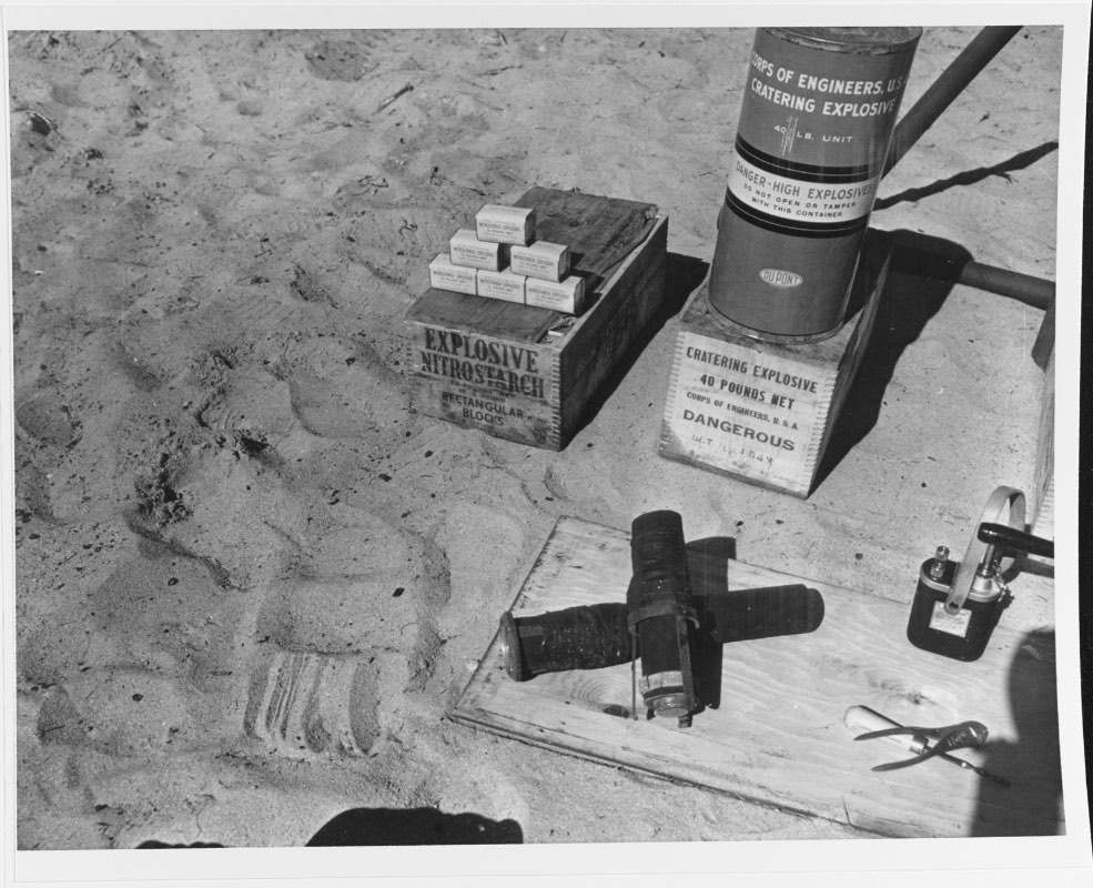

Antoon Posted September 24, 2023 #16 Posted September 24, 2023 Does someone know what the two cylindrical items in front of the cratering charge are?
robinb Posted September 25, 2023 #17 Posted September 25, 2023 The 40 pound shaped charge does exist. An old ebay purchase for me. The seller called it a 'Smudge pot".
