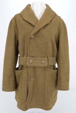

world war I nerd Posted January 30, 2016 #1 Posted January 30, 2016 In regard to this WW I enlisted men's overcoat, which differs significantly from both the 1917 and 1918 pattern overcoats, does anyone know: 1. What the official name of this style of overcoat was? 2. What the Specification No. of this style of overcoat was? 3. When was this style of overcoat adopted by the Army? 4. Why was this style of overcoat developed? 5. Who was this style of overcoat issued to? Thanks for looking ...

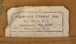

world war I nerd Posted January 31, 2016 Author #2 Posted January 31, 2016 Perhaps anyone who owns an overcoat of this style could check the contract label for a specification number? It would also be good to know what the contract dates on the labels were. This would help narrow down the date on which production began for this style of overcoat. Thanks again for looking ... and I hope, helping ....
jagjetta Posted February 1, 2016 #3 Posted February 1, 2016 I have handled about five of these shawl-collared overcoats. None have had labels. At least three (I don't recall on the other two) were unlined. The only markings I found in any of them is a "42" stamped in this one sold by AGM in 2008.

US Victory Museum Posted February 1, 2016 #11 Posted February 1, 2016 This discussion is becoming convoluted with overcoats being compared to mackinaws. The shawl-collared overcoat does not conform to any of the olive drab overcoat specifications. The fact that most are unlined would suggest that these are foreign made and purchased by the USQMD for expedience. Remember, the US entered the Great War in a state of woeful unpreparedness. This is not a transitional mackinaw, as there were two specifications for mackinaws issued during the war: the 1907 pattern, and the 1918. Jagjetta is correct, the photo he posted (re-posted below) is the 1907 Spec 863 pattern. The late war issued mackinaw is the Spec 1343 issued in Sept 1918 (photo) As to the artist rendition coat you are looking at, I would suggest that it is likely one of the following: Spec 629 1903-05-18 OvercoatSpec 701 1904-09-26 OvercoatSpec 762 1905-07-14 Overcoat Coats specified before these are blue wool. Msn

world war I nerd Posted February 2, 2016 Author #13 Posted February 2, 2016 Mike thanks for adding your expertise to this discussion. I too agree that the shawl collar overcoat does not match any of the known overcoat specifications. That however, does not mean that a specification for the shawl collar overcoat does not exist. Prior to WW I the Quartermaster Department / Corps created a new specification number for even the most minor changes made to a regulation garment, such as changing the weight of the thread used. Based on their obsession with documenting how each garment was to be made and what it was to look like, it's doubtful that a whole new overcoat could sneak into existence without any form of documentation. However, if that overcoat was designed and contracted out to European clothing manufacturere by the AEF, then it's possible that a specification number for that coat may not exist. The ultimate goal of this post is to hopefully find out one way or the other. I also agree with your brilliant conclusion that the mackinaw style coat in the background of the Ogden illustration is the cotton canvas work coat ... something I didn't know existed until now. Thank you very much for adding that information! In respect to this thread wandering into mackinaw territory, I'm okay with it because I've always believed that the two garments were somehow related. That being said here is some more grist for the mackinaw mill ... Here are the three variations of WW I era mackinaws that I've observed. At left is apparently the 1907 style mackinaw (Specification No. 863) with a button loop on the lapel and no pocket flaps. In the middle is a wartime variation of the 1907 Mackinaw made with pocket flaps, but without a button loop on the lapel. Is this just a manufacturers' variation or could this type of mackinaw have an as yet undiscovered specification number of its own? The mackinaw on the right appears to be the 1918 Mackinaw (Specification No. 1343) introduced late in the war. Thanks to Mike for the specification numbers. Left hand photo courtesy of the Chuck Thomas collection Center photo courtesy of the John Adam-Graf collection Right hand photo courtesy of the National World War I Museum

Dragoon Posted May 8, 2016 #23 Posted May 8, 2016 I have been taking some photos of the coat shown in posts #7, #8 and #11. I just thought I would include one here for reference of the inside of the coat. Kurt.
world war I nerd Posted May 8, 2016 Author #24 Posted May 8, 2016 Kurt, Nice example. Thanks for the view of the inside. Does yours have the button loop or the button hole on the lapel? Any chance of posting a close up of the contract label?
Dragoon Posted May 8, 2016 #25 Posted May 8, 2016 Hi, sorry I should have mentioned this is the actual coat also shown in post #7, #8 and #11. A shame as I would like to see another contract label. Kurt.
