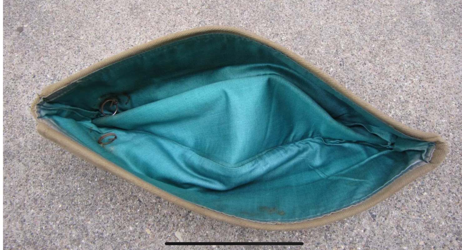

What are the thoughts on this overseas cap. I’ve never seen one like this before
Emerson illustrates this design (in blue) worn by an Army Nurse (p581 figure 79-4).  This particular example (in khaki twill) is likely from a semi-official women's motor corps unit.  There were literally dozens of such organizations in cities around the country.  Despite Jill Smith's extra-ordinary study of World War One women's uniforms, most of these smaller, regional organizations remain poorly, or completely undocumented.

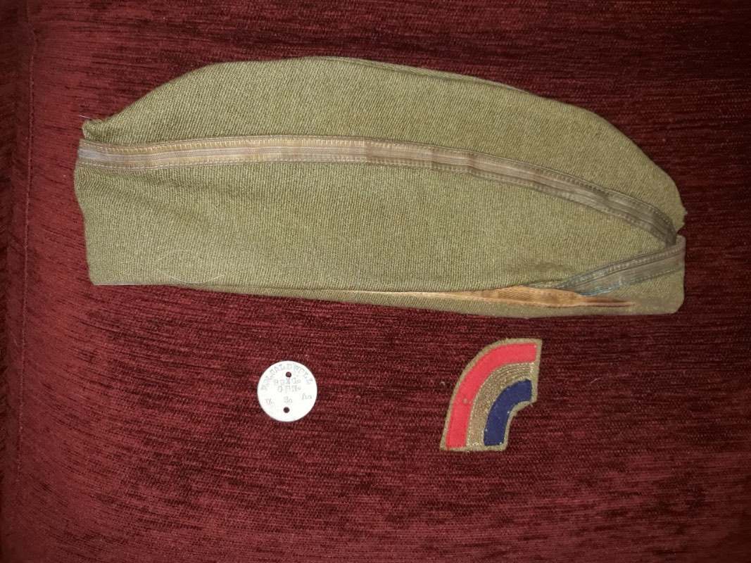

Hello all -

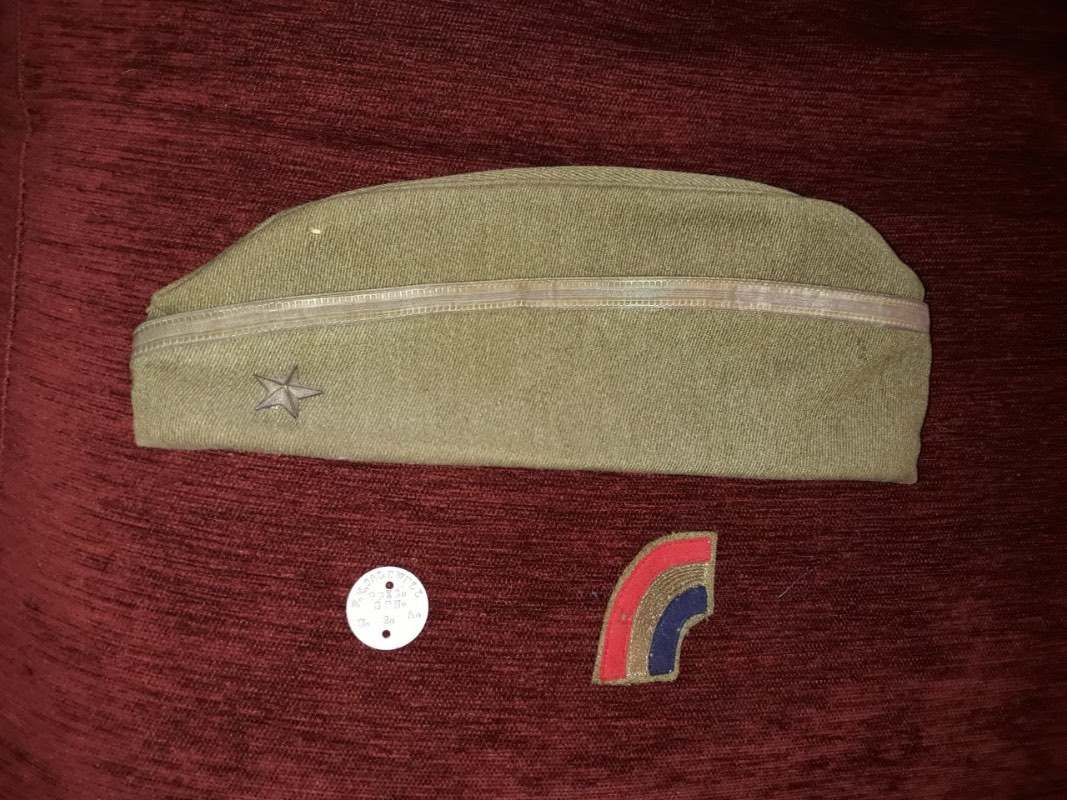

     I'm glad this topic is still active & rich with information.  Many thanks!  I include here some images from my great-grandfather, Brig. Gen. F.M. Caldwell,  He commanded the 75th brigade, 38th division, which was broken up on arrival in France in October, 1918.  He was then assigned to the 83rd brigade, 42nd division, though he was attached to the 29th & 79th divisions during the latter stages of the Meuse-Argonne offensive (I assume with V corps & perhaps helping coordination of the passage of lines, as the 79th relieved the 29th).  He later commanded the 83rd brigade during the occupation of the Rhineland, returning Stateside in April, 1919.
     This cap is his, along with his 42nd div. patch & I.D. tag.  I believe purchased Before going overseas.  The photo certainly is, note the absence of a Sam Browne belt.  I have never seen a general officer photo in France showing a cap with 3/8" gold trim, all I've seen seem to be with rather narrower gold soutache.  Enjoy.

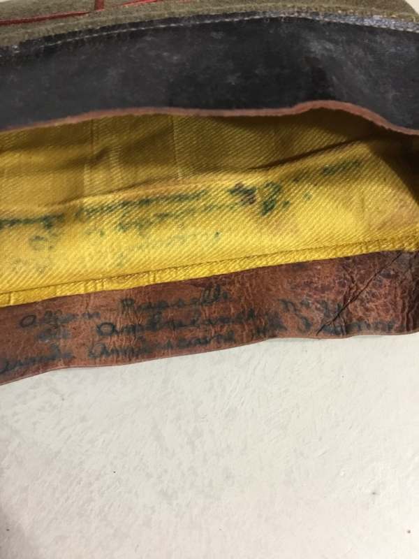

July1, 1916-HLI17SB
Hello.  I recently purchased this Belgian service cap.  Inside, it has the name of a member of the 33rd US Ambulance Company ….a unit that arrived in France during the first week of June, 1918.  I did find this man as a WW1 veteran in MA burial records and the hat came from MA.  At first, I thought  the cap might be a souvenir.  However….
1) I find no combination of red piping and white tassels in the Belgian army during WWI
2) it is a private purchase hat and the tassel is attached unlike the standard Belgian practice.
3) The tassel is not a style of any standard period production. It appears locally hand made.
4) The American soldier has written his name and unit under the sweat band twice… once in English, once in French.  Probably not necessary for a souvenir that gets stuffed in your kit.
5) Red would be the closest Belgian piping to the US Medical Corps maroon/scarlet of the period.
You probably know where I am going with this.  I am inclined to believe that the American soldier purchased this cap, had a white tassel made to complete his arm of service colors, and wore it for at least a while until his unit received the more common style(s) of cap worn by the AEF.  Thoughts?
I tend to agree with your theory. Was he an officer? If not, it's interesting that he decided to go with officer's branch-colored piping in lieu of attaching a medical disk to the cap. Is there any evidence of officer's rank insignia, or an enlisted disc having been attached?
July1, 1916-HLI17SB
He was enlisted personnel, and I find no indication of any insignia (pin or post attachment) being added.

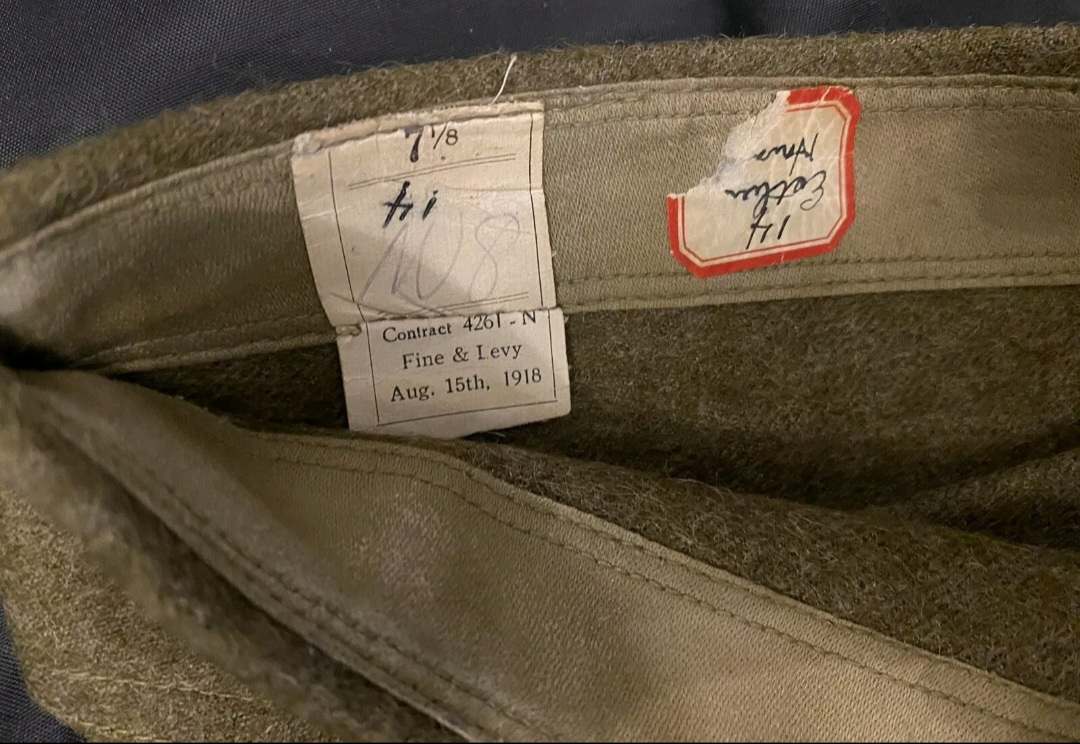

Meanwhile Im in touch now with AEF caps and I purchased my first example I found this GREAT thread and although Sorry I started a thread(before seen this here) about my first one garrison cap  I would like to post here the pics requesting info about the labels, what are them,if is a maker one,s ....
Have you ever seen this Fine& Levy one???
About the label with red colour around what should be for???
The device USNA I read here on Page 4 of  this thread that is one from earlier ones examples??
Thanks in advance

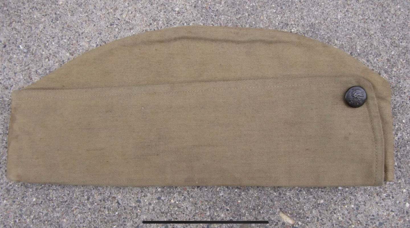

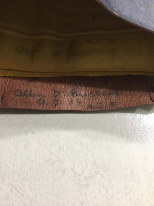

I just now picked up this cap. Really nice condition with evidence of a disk having been attached. The markings on the sweatband have me puzzled. I've attached an image. To me it looks like-
"USG M[ADE?]
106
INSPECTED"
all enclosed in a box. Maybe it means US Government Made? There's also a size,"7' on the sweatband.
aznation
"USG M[ADE?]
106
INSPECTED"
That's U.S.Q.M. for United States Quartermaster.
Very, very possible. As I keep staring at it for way too long, it looks like a G and not a Q, and there are more letters after the M . The box seems wider, too. I'll keep staring.. Perhaps a D after the M for USQMD. D for Department. I think I'll go with that for now.
aznation
Maybe my eyes are getting worse than I thought.  I didn't even see any other letters about the M but I think you might be right perhaps about the D.  Maybe the D is for Depot.  Just a thought.  I'm pretty sure someone on the forum will let us know what we're actually looking at.
CAC1901
It should be US Quartermaster Corps - initials USQMC.  The USQM Department became the corps in 1912. The former USQMD initials lingered on with a few items though.
That makes the most sense. I'll let my eyes rest and take another look later. To me it seems an unusual marking in a cap.
