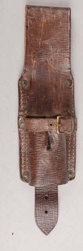

jagjetta Posted August 13, 2008 #9 Posted August 13, 2008 I thought some folks may not know what some of us refer to as "chalky" leather, so am posting a couple of images. The leather frog (South African) on the far right is untreated leather. The first frog and detail is a WWI P14 frog that has been "lightly coated" with Pecards several years ago. The owner said it looked "fresh and soft" when he was done. This is the "after" photo--that is, after about 12 years. You can see the dry white "chalk" in all the cracks. That is the chalky bloom that emerges from leather that has been treated. It doesn't go away. You can't brush it out. More treatment "hides" it, but even the most oblivious will probably recognize the downward spiral that this creates. And finally, I have attached images of two victims of overzealous treatment...notice all the extra oil and finger prints. I am not going to show the tops of the helmets because I don't own them and don't want to embarrass anyone. But, suffice it to say, the person who thought they were "preserving" the helmets coated them with varnish and pecard. The helmets were ruined beyond recognition. And still, the owner insisted he was "preserving them for history!" John Adams-Graf

mrhell Posted August 13, 2008 #11 Posted August 13, 2008 Interesting post and I always welcome information, but there are just too many variables in this example. Such as...What was the leather condition of the left frog before being treated? I have doubts it was as pristine as the right photo and if so, then why was it treated at all? Also "lightly coated" is vague as well. Was it simply wiped on and left? How was it stored? As for the helmet example, I'll dismiss that issue and concentrate on the topic of this thread—leather. While I appreciate any information this forum offers, I can only take such evidence under advisement. Before making an informed decision I need supporting facts. So far the only facts I have are my experiences of trial and error and other people's experiences and opinions. This includes museum curators. I heed what they say, but it's far from gospel. Don't misinterpret my reply; I have no goal to prove me right and you wrong. All I know is sometimes perceptions can be as distorted. I may very well regret treating my leather collectibles years from now but I guess time will tell. I'm just over half-way to the 12 year mark since my first use of Pecard's, so we'll see. Fortunately I have not experienced that nasty spiraling effect or any similar eyesore. I simply posted my experiences; results may vary.
jagjetta Posted August 13, 2008 #12 Posted August 13, 2008 Thank you so much, Mrhell! That is the point EXACTLY...one doesn't know what is too much or too little UNTIL they have applied the magic potion to the leather. But unfortunately, then it is too late. Like peeing in a pool...once its in there, you can't take it out. Leather was once a living tissue. There are no magic potions for bringing it back to life. You can mask the aging process, but you can't erase the fact that it was once a living tissue and now it is a dead tissue. The tanning process, by its very nature, was an attempt to stop the decay. Left untanned, well...we all know what the results are there. We all want to feel that we are "preserving" something. And as long as it looks good in our life time, we feel we did just that. Nothing wrong with that. There are no governing "rules" that collectors have to follow. If folks like leather that feels soft and oily today, that is their own business. The fact is, though, many dealers and collectors are refusing to pay full value for leather that has been 'treated'. That is the only 'fact' of the matter that I can point to with certainty. The same thing happened in the daguerreotype world in the 1980s. Up until then, people believed that thiourea solutions could literally erase the tarnish of time. Then, a few scientists and museum curators (Grant Romer and Susan Barger come to mind) said, "HALT! The tarnish you are removing is also taking microscopic levels of the image." Furthermore, they demonstrated that images that were "washed" (as folks called it then), began to show a brown hue after several years. They proposed the NEW wonder drug of cleaning daguerreotypes with electrolysis. That was all the rage through the 1990s. Then, further studied produced some caution...etching was occurring at the ATOMIC level! "HALT!" went up the cry a second time. Now, the photo-history world says, "no treatment is the best treatment." But does that mean I as a private collector has to be content with looking at tarnished images of Mexican War soldiers? Of course not. If I want to dip my $6,000 image of a US Mexican War soldier into thiourea that is my business. However, watching the prices of images that have been "cleaned" verus those that are in "original condition" leaves no doubt in my mind that original condition is the way to go. Another example can be found in the muscle car world. Find a Shelby Cobra in a barn with all the 'original' dirt and patina of a glorified past still on it, and you have a price-record breaking car. "Restore" it, and the price drops considerably. The muscle car guys have figured it out. "As found condition" equals TOP DOLLAR. I mentioned this to the Pecard folks a few months ago...there is nothing wrong with folks wiping goo all over historic relics as long as they own them. Just don't misrepresent the stuff as "preserving" leather. The National Park Service, the British Museum, and the Smithsonian all agreed that the product does not reverse the effects of aging on leather, just as a fresh coat of paint doesn't keep a fox out of the chicken coop. Nevertheless, people will do what they believe is right in spite of "facts". They have to, especially if they have been committed to it for years. If one read the NPS, British Museum or Smithsonian reports on leather treatments, the chances are they will say, "Well I know it works for me!" and keep right on doing what they are doing. Admitting that they have done irrepreprable damage to historic objects is a heavy burden. It is much easier on the mind to defend a practice and look for those who hold the same faith then it is to investigate, evaluate and modify collecting practices. (Just so ya'all know, it is as recent as six years ago when I applied WD-40 to a helmet because I thought it "looked better" and made the rust look less obtrusive.) It takes a heck of a lot of will power to admit that nothing can be done when everything we have learned is that "wet" or "moist" or "shiney" is the same thing as "preservation". Believe me, hang around with a few conservation lab types and they will tell you that "wet", "moist" and "shiney" is exactly the opposite...usually points to slow-speed destruction and devaluation of an artifact. I realize that I have rambled on and on...I don't supsect that anyone will change their current collecting trends because of it. But I hope some folks will have the humility to say "we don't have the answers on leather preservation and until we do, leaving an object alone is better than doing something that can't be reversed". Science has come a long way since the 1980s (and an ESPECIALLY long way since the pecard formula was hatched prior to WWII!). It has a long way to go. If we can simply not speed up the decay process by slathering goop on leather, we will have done a good bit for the prolonging of original artifacts. Thanks for letting me share these views, John Adams-Graf
