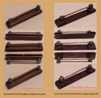

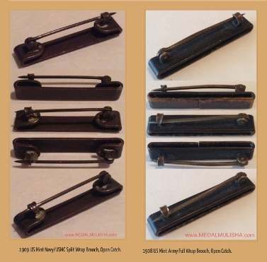

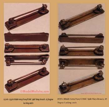

WS60 Posted April 25, 2007 Share Posted April 25, 2007 Although I'm not a medal collector, I have considered adding a grouping (or two) to my collection. I'm relatively new to colleting US. How daunting a task would it be to have one or more of our knowledgeable medal collectors pin a thread explaining brooch design and dates of use? It's interesting we have a category to ID patches, but not medals. I realize there are books out there that have the ID information, but most of those are only a photo telling you what the medal is. I think it would be beneficial for collectors to also know what things to look for in order to narrow down the era of a medal. What do you folks think? Very good idea to put all styles of broaches to one topic. Link to comment Share on other sites More sharing options...

MMcollector Posted February 27, 2014 Share Posted February 27, 2014 Here is my personal brooch guide, incomplete but covers the large majority of standard brooches. If I've got anything mixed up, please let me know. Link to comment Share on other sites More sharing options...
