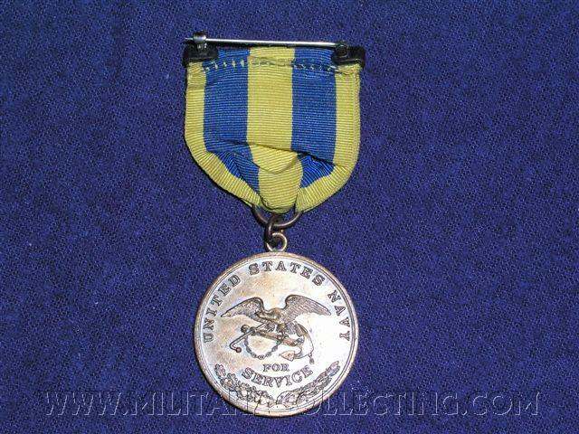

collectsmedals Posted February 4, 2007 #5 Posted February 4, 2007 Split Broach The split broach was first used on US medals around 1898. This style of mounting was purchased by the Army until around 1920 and by the Navy/Marines until 1932. This style consisted of a solid metal bar that wrapped partially around the medal ribbon, not meeting in the back, hence the "split". The pin therefore had to provide structural support for the back of the mount. This caused the ends to sometimes become misaligned such that the pin and catch could not mate properly. This style had the advantage of allowing the ribbon ends to be sewn together first then the broach applied after. This first picture is of a split broach with an open catch on a Navy Mexican Service Medal. Note: The ribbon on this medal has obviously been replaced at some time as the broach is mounted upside down with the open part of the catch facing up.

collectsmedals Posted February 4, 2007 #7 Posted February 4, 2007 Here is a split broach on a Navy Spanish Campaign Medal from the 1923 Bastian Brothers Contract. This is a much thinner broach and was only used for this medal, which is easily identified by the triple ring suspension.

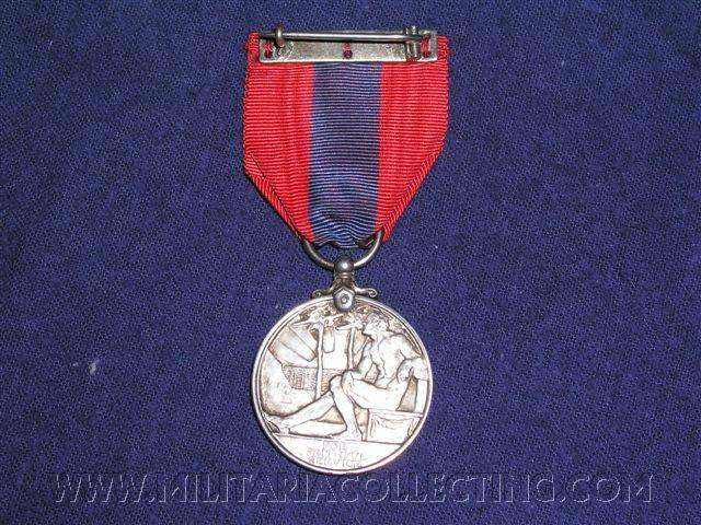

collectsmedals Posted February 4, 2007 #14 Posted February 4, 2007 Now a few medal mounts for countries other then the US. Here is a typical mounting for a Britsh Medal from the 1940s.

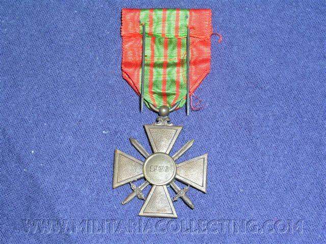

collectsmedals Posted February 4, 2007 #16 Posted February 4, 2007 Typical mounting of a French Medal from World War II.
collectsmedals Posted February 4, 2007 #17 Posted February 4, 2007 Typical mounting of a French Medal from World War II.

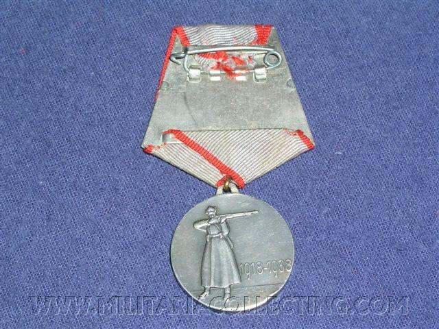

collectsmedals Posted February 4, 2007 #18 Posted February 4, 2007 Typical Mounting for a single Russian medal from World War II era.

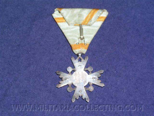

collectsmedals Posted February 4, 2007 #19 Posted February 4, 2007 A typical mounting of a Japanese Medal from World War II.
