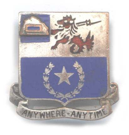

Wow I should have my eyes examined, I got a tip that it's the 57th Infantry (PS), and he was right, I guess it was the slight redesign of it in this cloth form that threw me, note the one Wayne is wearing has a rounded bottom to the shield and plus the oblique view of it.
Wasn't Waynes roles based on Col. George S. Clarke of the 57th INF(PS)
Just saw this. It is the 57th inf. Studios made insignia based on real insignia when they could not obtain the real McCoy which could explain the difference in the motto shape.
