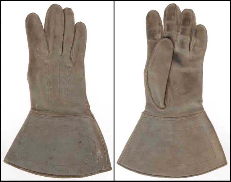

world war I nerd Posted May 12, 2015 #3 Posted May 12, 2015 The Army issued 1905 Riding Gauntlets made from gray buckskin to all mounted troops. I don't think these were that popular during the Punitive Expedition, but they do show up in photographs of that campaign.

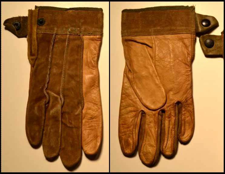

world war I nerd Posted May 12, 2015 #4 Posted May 12, 2015 In most cases officers and enlisted men wore private purchase russet leather gloves, which could appear in a myriad of styles. This particular example is from WW I.

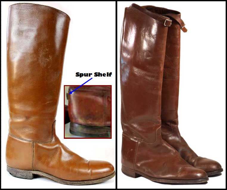

world war I nerd Posted May 12, 2015 #5 Posted May 12, 2015 In regard to riding boots - a true pair of riding boots will not have any lacing either on the instep or at the top of the calf. They will also have a small shelf at the back of the heel on which the spur would rest as indicated by the inset. It also wasn't unusual for riding boots to have an adjustable narrow strap near the top of the boot.

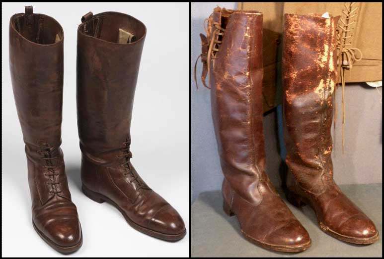

world war I nerd Posted May 12, 2015 #6 Posted May 12, 2015 Riding boots also show up with lacing at the instep. The British Army referred to this style as an "Officer's Marching Boot", because the instep laces allowed the wearer to adjust the fit of the boot in that area to make it a bit more flexible, and thus more comfortable when walking. In addition riding boots were also manufactured with laces on the upper half which allowed the wearer to adjust how the boots fit the calve of the leg. Both of these styles were made with and without spur shelves and commonly worn by both mounted and dismounted officers.
world war I nerd Posted May 12, 2015 #7 Posted May 12, 2015 Riding/Marching boots featuring both a laced instep and upper were made as were various styles whose shafts were secured by a series of straps and buckles. Note the spur shelf on the latter style. These types would have been less common, but I have seen similar variations of both worn on the Punitive Expedition and in WW I. I hope this helps ...
