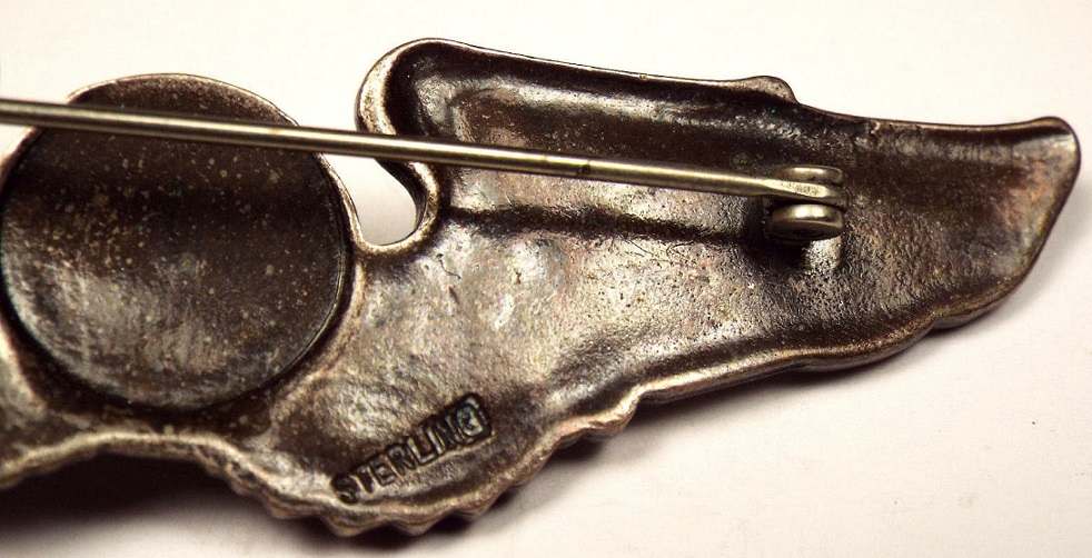

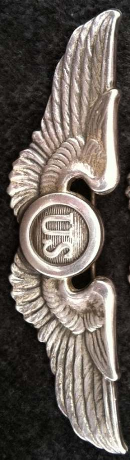

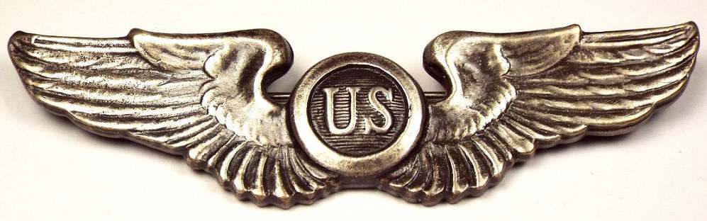

rustywings Posted February 4, 2016 #28 Posted February 4, 2016 As stated several times above by dedicated aerial badge collectors, the only way to really get an edge on not getting burnt with reproductions and restrikes, is to get out there and handle as many examples as possible and absorb what is right as much as what is wrong with each piece. This also means making the effort to seek out reputable dealers and fellow collectors to help expand your exposure to authentic wings before you open your wallet. Check out ebay auction #321998283239 which describes an "Original Pre-WWII N.S. Meyer U.S. Observer Sterling Silver wing..." and "Vintage...nice piece to add to your WWII wing collection." Obviously the seller doesn't have a clue what he's listed, but his verbiage in the description could certainly be appealing enough to lure an unsuspecting buyer. In reality, this listed Meyer restrike is attempting to portray an extremely rare 1920 Observer's badge to only be worn by those who previously qualified as a Pilot. The badge was authorized for only a year before they changed the design by removing the "U.S." from the center. I believe a new collector will likely encounter hundreds, if not thousands of these restrikes before he runs across an authentic 1920-1921 period piece. And in all likelihood, will have to pay $1,000.00 to $1,500.00, not "$128.95 buy-it-now" to add it to his collection. Here's the current ebay listing:

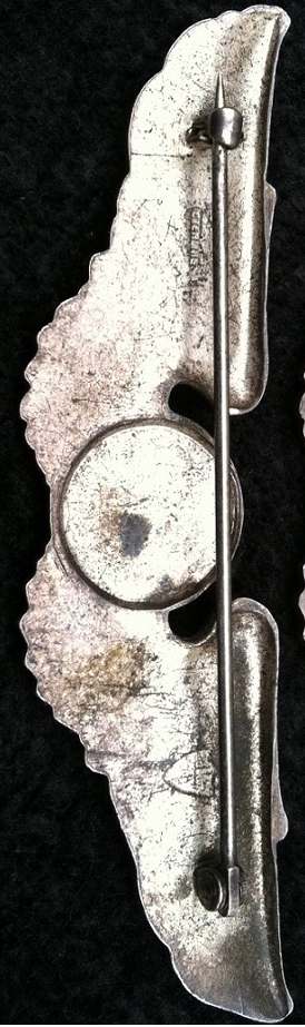

rustywings Posted February 4, 2016 #29 Posted February 4, 2016 For comparison, here's what I believe an authentic Meyer-made 1920's Observer badge should look like. Note the incised Meyer shield (further debunking the quote from "A Companion To Wings Of WWII"); the very small "STERLING" stamp; the Tiffany style lever catch; the cam-stop pin; the additional feathering details; and the overall appearance and surface texture of the reverse. For me, sometimes these wings talk and make it easier to decipher what is right or wrong with the badge. After handling many Meyer restrikes, this badge screamed authenticity at me!

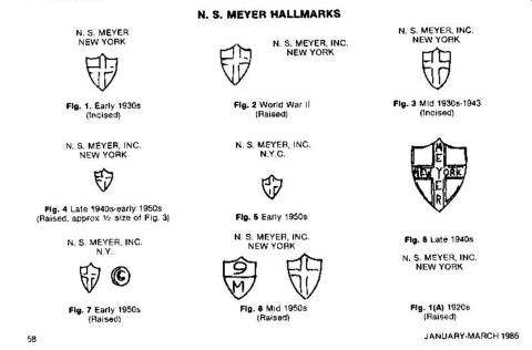

Patchcollector Posted July 27, 2016 #31 Posted July 27, 2016 I found this image of various Meyer hallmarks on another thread from this Forum.Would figure # 4 be the match for the one I posted?
B-17Guy Posted July 27, 2016 #32 Posted July 27, 2016 That diagram has been around for a long time. I have seen legitimate Meyer wings not fall within the guidance set by this chart. To be honest, I don't put too much faith in it...it's an interesting reference, just not iron clad. Again, collectors are looking for a silver bullet in dating wings... My two cents. John

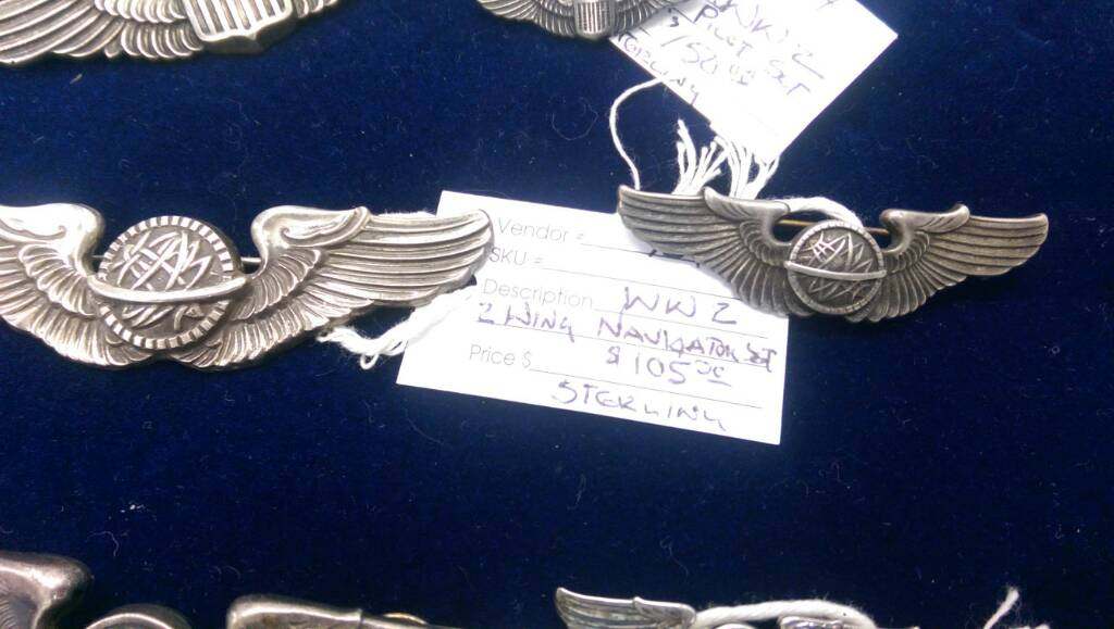

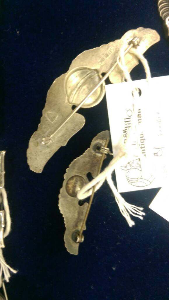

Gerradtgrant Posted July 27, 2016 #33 Posted July 27, 2016 That diagram has been around for a long time. I have seen legitimate Meyer wings not fall within the guidance set by this chart. To be honest, I don't put too much faith in it...it's an interesting reference, just not iron clad. Again, collectors are looking for a silver bullet in dating wings... My two cents. John Hi, I have a few pictured to submit and see what you think. The two pictures I have are not very good. I took them and sent them to somebody I know who is very knowledgeable in WWII wings. He instantly said Meyer wings are faked to often and didn't want to speculate anymore. If there is any chance they are real I would love to own them. If anything about these two pictures gets you excited please tell me and I will go take better more detailed pictures. Wanted a generic opinion before I drive the hour to take more. Thank You in advance. Sent from my m8wl using Tapatalk
pfrost Posted July 27, 2016 #34 Posted July 27, 2016 There is probably nothing wrong with either those wings. The 3 incher is a NS Meyer wing but is right as rain. The 2 incher is a "Bell pattern" wing. Patrick
Gerradtgrant Posted July 27, 2016 #35 Posted July 27, 2016 There is probably nothing wrong with either those wings. The 3 incher is a NS Meyer wing but is right as rain. The 2 incher is a "Bell pattern" wing. Patrick I didn't assume the 2in was a ns Meyer it doesn't have any maker marks. And rough idea on value as I don't want to over pay? Or is it safer if I run and never look back? Sent from my m8wl using Tapatalk
pfrost Posted July 27, 2016 #36 Posted July 27, 2016 Value is relative, but if they price is shown on those cards, you should run away. NS Meyer wings are never going to command great value anyway and with patience you will find them much cheaper. I wouldn't pay more than 40-50$ for the 3 inch NS Meyer navigator wing and probably not more than $25 for the 2 inch wings. They aren't that rare. It just depends on how badly you want them.
pfrost Posted July 27, 2016 #37 Posted July 27, 2016 not associated with this auction at all, but here is one for about $55. Make an offer or wait and see if you can find one cheaper. http://www.ebay.com/itm/Vintage-Sterling-Silver-US-AIR-FORCE-NAVIGATOR-WINGS-badge-pin-full-size-/262530086474?hash=item3d2003364a:g:G7UAAOSwqfNXi4Iy and the 2incher for about 30$ http://www.ebay.com/itm/Vintage-Sterling-Silver-WWII-U-S-Army-Flight-Navigator-Wings-Badge-2-1-8-Long-/122052240731?hash=item1c6ae1655b:g:CdUAAOSw0fhXkBY2
Gerradtgrant Posted July 27, 2016 #38 Posted July 27, 2016 not associated with this auction at all, but here is one for about $55. Make an offer or wait and see if you can find one cheaper. http://www.ebay.com/itm/Vintage-Sterling-Silver-US-AIR-FORCE-NAVIGATOR-WINGS-badge-pin-full-size-/262530086474?hash=item3d2003364a:g:G7UAAOSwqfNXi4Iy and the 2incher for about 30$ http://www.ebay.com/itm/Vintage-Sterling-Silver-WWII-U-S-Army-Flight-Navigator-Wings-Badge-2-1-8-Long-/122052240731?hash=item1c6ae1655b:g:CdUAAOSw0fhXkBY2 Thank You for your help. I want one but not that badly. I will look around and patiently wait to snipe one at a much lower price. Sent from my m8wl using Tapatalk
bschwartz Posted July 28, 2016 #40 Posted July 28, 2016 That diagram has been around for a long time. I have seen legitimate Meyer wings not fall within the guidance set by this chart. To be honest, I don't put too much faith in it...it's an interesting reference, just not iron clad. Again, collectors are looking for a silver bullet in dating wings... My two cents. John Bingo. Totally agree John. I've seen many wings that are vet owned that don't agree with that chart at all. It's a good chart to show the different types of marks that Meyer used but I wouldn't rely on the associated dates. Not trying to ding whoever created it I just have seen too many things that don't fit the dates.

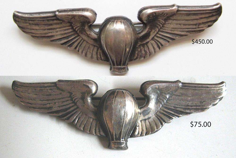

The Rooster Posted October 20, 2018 #41 Posted October 20, 2018 Greetings all, Here are two balloon pilot wings from ebay at vastly different prices. Opinions please. Thank you in advance to all!
268th C.A. Posted October 20, 2018 #43 Posted October 20, 2018 From the lack of feathering on these wings and the bottom basket....I dont like them, but that's my opinion.
mghcal Posted October 20, 2018 #44 Posted October 20, 2018 Not good. See the flaw in the right side on the front? It's like a circular indentation? All of the repros have that is what I was told.

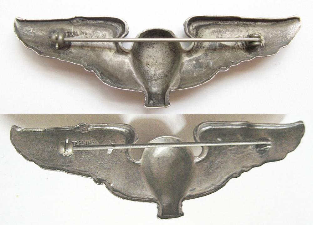

The Rooster Posted October 20, 2018 #45 Posted October 20, 2018 I also noticed that the tarnishing on the front is in almost the same places........ and on the back. The same half indented Sterling hallmark in the same spot. No solder puddles under the pins...
B-17Guy Posted October 20, 2018 #49 Posted October 20, 2018 Someone once said its easy to join an avalanche, lol. Really easy here, both wing badges bad. Personally, I went straight to the back of the wings. Sterling marks are typical of the style seen on repros and findings, specifically the pin bases of both are also typical of the those seen on repros or restrikes. Never even got the front of the badges. John
The Rooster Posted October 20, 2018 #50 Posted October 20, 2018 Thank you one and all. This forum is great! And you all are a great bunch of folks! Its great to have a resource like this one to avoid making very expensive or even not so expensive mistakes when purchasing a wing. I hope nobody gets suckered by the 450 dollar wing. Now... like Lowell Thomas used to say........"Here's the rest of the story." Im the sucker that bought the 75.00 dollar wing. LMAO at myself. Auction was ending and lol I got it. Then I checked it out. Jump decision gone wrong. Lesson learned. Let the buyer beware. Wing has been sent...... But.Here's the rest of the story The owner is being gracious enough to take it back if I dont want it. So not a total loss. I am learning. like usual... The hard way... lol Great weekend everyone.
