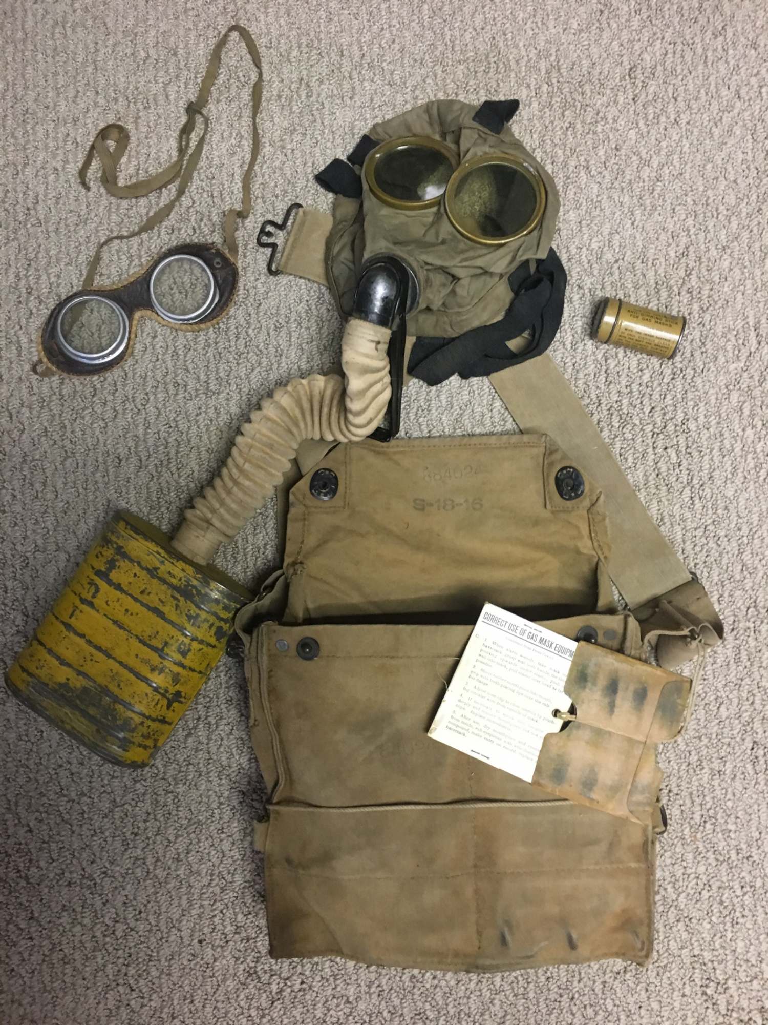

jayhawkhenry Posted August 17, 2017 #204 Posted August 17, 2017 I recently came across this beauty. Soft and complete Sent from my iPhone using Tapatalk
TrenchRat Posted August 17, 2017 #205 Posted August 17, 2017 Nice find! Too bad about the hose though; out of all the masks I have come across, only one hose, on an English mask, had the proper shape. How is the mask itself? TR
jayhawkhenry Posted August 17, 2017 #206 Posted August 17, 2017 Nice find! Too bad about the hose though; out of all the masks I have come across, only one hose, on an English mask, had the proper shape. How is the mask itself? TR . The hose looks worse in the photo than in hand. It is still fairly round & soft. The mask is very pliable with clear lenses and good straps. The exhaust valve, mouth piece & nose clips are all pliable as well. I have some masks that are so brittle you hate to touch them. The goggles were in the bag as well. Sent from my iPhone using Tapatalk
TrenchRat Posted August 17, 2017 #207 Posted August 17, 2017 . The hose looks worse in the photo than in hand. It is still fairly round & soft. The mask is very pliable with clear lenses and good straps. The exhaust valve, mouth piece & nose clips are all pliable as well. I have some masks that are so brittle you hate to touch them. The goggles were in the bag as well. Sent from my iPhone using Tapatalk That's great then. The head bands on my English model are pretty well stretched out. I plan on displaying the mask on a torso w/head but not entirely sure it will hold up well enough. I'll have to have a plan B at hand. Another mask I have has better bands but every time I pick it up it rains that black powder, or the old rubber I presume it to be. I saw on the interweb a way to remove the rubber entirely to get the mask into a more "usable" state... I dig the goggles...great find as well...
TrenchRat Posted November 14, 2017 #208 Posted November 14, 2017 Good day, I thought I might add to this topic by posting a pic of the gas mask I am currently restoring. Fortunately, some time ago I had come across a satchel in excellent condition with a filter in similar condition. I also had for some years a rather pliable mask with a poor flattened hose. Then recently I found a mask in the typical petrified condition with a nice round hose. Here is the result after putting it all together. All that is left for me to do is wire the components back together then bind the connections with some suitable tape. TR

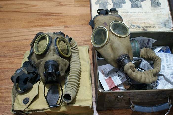

bn1961 Posted November 23, 2018 #211 Posted November 23, 2018 Many years back I got a WW1 Russian gas mask in a grouping from an Engineer from Michigan. It was excellent. Very pliable but when he packed it away he pinched the mask in between the top and bottom of the canister. One other cool item that came with it was a purple polar bear patch.

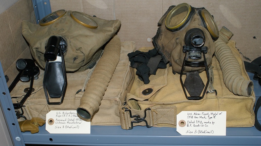

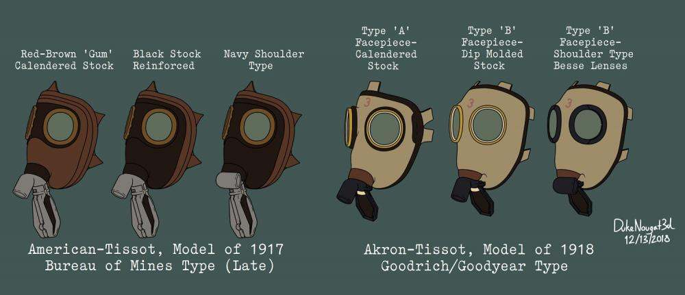

DukeNougat3d Posted December 20, 2018 #213 Posted December 20, 2018 It seems I have missed a photo, but Photo No. 134 does not feature a Kops-Tissot-Monro or "Victory Mask" as it's often been incorrectly labelled in this thread, but in fact shows an Akron-Tissot, Model of 1918 with the 'Type A' Facepiece, as noted by the 'bulging' eyepiece platforms.The suit also appears to be the same pattern of early 'permiable' gas suit known as the 'Simplexene Fighting Suit', comprised of an internal layer of dry cotton cloth with the outer cheesecloth layer being impregnated with Rosin Oil, Rosin, and Paraffin Oil for mustard gas protection. It was intended to be the chemical suit issued to every typical doughboy (as implied by the name 'Fighting Suit'), while specialized mustard decontamination squads got impermiable rubberized anti-gas suits.
world war I nerd Posted December 20, 2018 Author #214 Posted December 20, 2018 Duke Nougat3d, there's absolutely nothing pretentious about the corrections/clarifications you posted above. The pair of posts you added are exactly the sort of think I'm always hoping forum members (and viewers) will add to any topic that I begin … many thanks for broadening everyone's knowledge on the subject of WW I and post WW I gasmasks. It would seem that your personal knowledge on WW I era gasmasks far exceeds mine … Feel free to add more information or better photographs. My posts are far from being the last word on any topic. In fact, often, the inspiration for many of my posts is my personal thirst for more knowledge on whatever the given topic happens to be. Each post frequently starts out in my mind as merely a pathetic plea for more information from folks who know more than I on any given topic.
DukeNougat3d Posted December 28, 2018 #215 Posted December 28, 2018 Duke Nougat3d, there's absolutely nothing pretentious about the corrections/clarifications you posted above. The pair of posts you added are exactly the sort of think I'm always hoping forum members (and viewers) will add to any topic that I begin … many thanks for broadening everyone's knowledge on the subject of WW I and post WW I gasmasks. It would seem that your personal knowledge on WW I era gasmasks far exceeds mine … Feel free to add more information or better photographs. My posts are far from being the last word on any topic. In fact, often, the inspiration for many of my posts is my personal thirst for more knowledge on whatever the given topic happens to be. Each post frequently starts out in my mind as merely a pathetic plea for more information from folks who know more than I on any given topic. Much appreciated, glad I can contribute. ^^ I am still figuring out how I can link images from an external source so I can post full resolution photos, but in the meantime, I thought I should mention that after today, I am now in possession of both a Type A (left) and Type B (right) Akron-Tissot, Model of 1918. In fact, it is the same example featured in earlier posts in this thread that belonged to Dan-Retro. It has been loaned to me by a collector friend of mine whom bought it off him and has lent it to me for study and to remove rust on the flutter-guard and screws.

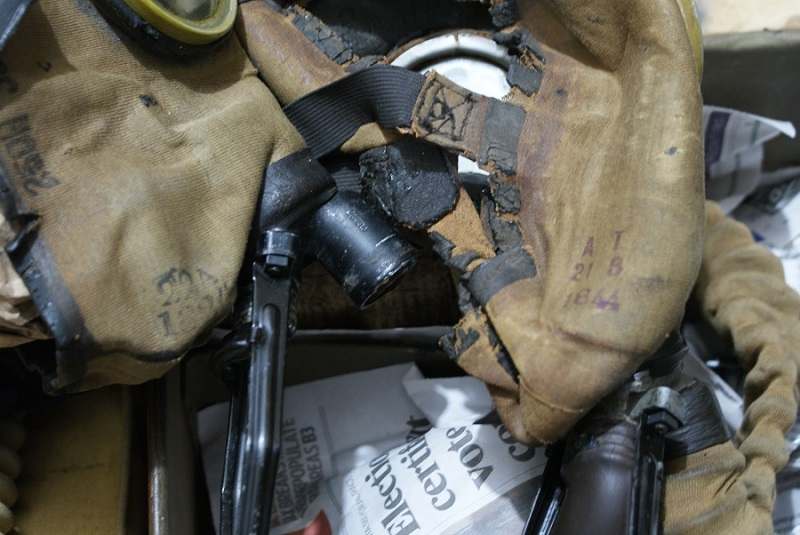

DukeNougat3d Posted December 28, 2018 #216 Posted December 28, 2018 This image shows where I get the 'Type A' and 'Type B' nomenclature for the early and late Akron-Tissot facepieces - after a 2-digit number (usually 22 or similar), there is a letter. on my "earlier" A.T., it is an 'A', and on the "later" A.T., it is a 'B', and these A/B markings have been consistently stamped this way on all examples I've seen.If you have any A.T. or Tissot-related questions, feel free to ask away!Again, I apologize for not showing more photos of markings, details, etc - the file limitations are troublesome.

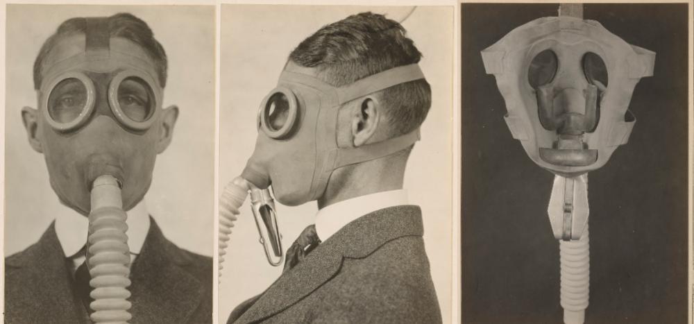

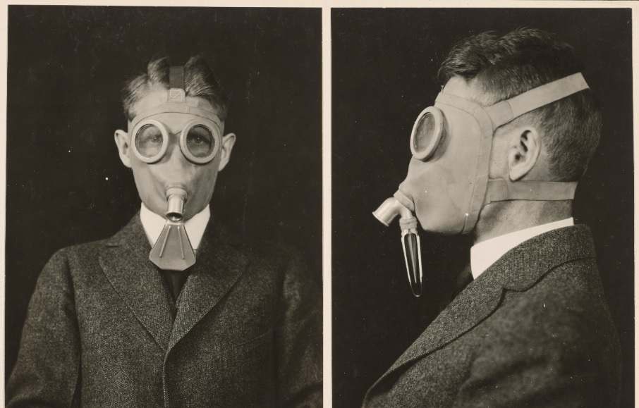

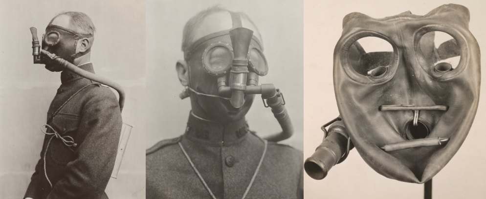

DukeNougat3d Posted January 20, 2019 #220 Posted January 20, 2019 U.S. Development and Domestication of the Tissot Gas Mask Section III. - American-Tissot, Model of 1917, Geer Type America’s first attempt at taking the French Mle.1917 Tissot and reverse-engineering it into an SBR-sized assembly came on October of 1917, developed by the B.F. Goodrich Company under the direct supervision and assistance of W.C. Geer, of whom this type is named for. Like the French model, it utilized a seamed facepiece and harness of (this time brown-red with black stock reinforcements round the eyepieces) calendered gum-rubber sheet vulcanized as one piece, an upwards-facing ‘flutter’-type outlet valve on an angletube/housing, and of course, the all important tissot deflector tubes. The similarities to the French mask end here, as the American-Tissot utilized an American SBR ‘Type H’ Filter and 11″ hose on the chest, it’s own, distintive crimped eyelenses, internally-glued deflector tubes, and a die-cast aluminum angletube rather than one of brazed copper. This particular model did not get too far in development, as it was likely realized the valve arrangement would be prone to letting any condensation, salivation, mucous, and other foreign matter down the hose and into the filter, rather than expired through the valve where it would cause no harm or degradation to the protective capabilities of the mask. The subsequent model which was improved by the Department of the Interior, Bureau of Mines (of thich Geer had strong Connections with) took direct influence from this initial mask and further developed it, cutting the test life of this U.S. Tissot clone reletively short. Pictured Below: Front and Side Profile Views of the American-Tissot, Model of 1917, Geer Type. [source: U.S. National Archives]

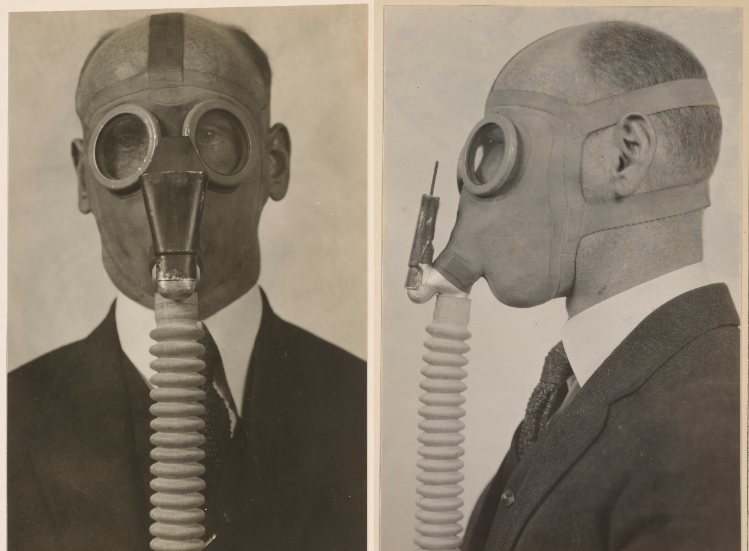

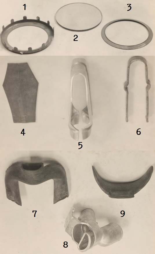

DukeNougat3d Posted January 20, 2019 #221 Posted January 20, 2019 U.S. Development and Domestication of the Tissot Gas Mask Section IV. - American-Tissot, Model of 1917, Bureau of Mines Type (Early) The next amendment to the American-Tissot Model of 1917 came under the assistance of the U.S. Department of the Interior Bureau of Mines sometime between October of 1917 and April 1918. The general facepiece arrangment and hardware remained the same, however the angletube was re-cast to integrate the hose in front of the outlet valve, which was now positioned in a downwards position, as to permit the drainage of fluids and moisture which may accumulate in the mask. The outlet valve was also protected by a humorously gigantic guard bracket, made of stamped steel sheet and secured to the angletube with a rubber band.The BoM American-Tissot's faceblank also differed from more frequent types later re-designed by W.C. Geer and the B.F. Goodrich Facility in the fact the calendered 'black stock' patch reinforcing the eyepieces was vulcanized inside the facepiece, instead of over the outside, as well as the use of a non-elasticated top strap, rather than producing all 5 harness straps from layered 'gum' rubber. Like the Geer Type, the BoM American-Tissot had a relatively short trial period before being once again corrected on various design flaws. This facepiece configuration would serve as the basis for all models to follow. Pictured Below: Front and Side Profile Views of the American-Tissot, Model of 1917, Bureau of Mines Type (Early). [source: U.S. National Archives]
DukeNougat3d Posted January 20, 2019 #222 Posted January 20, 2019 U.S. Development and Domestication of the Tissot Gas Mask Section IV-a. - American-Tissot, Model of 1917, Bureau of Mines Type (Late) Sometime before or around April of 1918, The American-Tissot, Model of 1917, Bureau of Mines Type was upgraded by W.C. Geer and the B.F. Goodrich Co. This rendition of the American-Tissot came the closest to being adopted by the AEF, and even saw minor usage stateside where absolute protection was needed, such as in Gas Production Plants at Edgewood Arsenal. This facepiece, as stated before went through the most changes and renditions compared to all other American-Tissot or Akron-Tissot variations. As previously mentioned, the construction of the harness and application of the 'black stock' reinforcements was alike that of the Geer Type American-Tissot. In this model, the die-cast aluminum angletube was improved and simplified and the sheet metal guard for the 'Flutter' Valve was also improved, being reduced in size and given a steel clip for retaining, rather than a rubber band. This design would prevent the flutter guard bracket from being easily torn or knocked loose. In April of 1918, the facepiece was also redesigned a final time for the standard infantry model, this time given an outer layer of calendered 'black stock' rubber to reinforce the flimsy red-brown 'gum' rubber used for the entirety of the faceblank. Despite all these changes, all the promise the design held, and all the development setting up the machinery to produce hardware for this model, it was ultimately rejected by the AEF and never saw usage overseas, save for maybe some rear area testing behind the lines. Pictured Below: Front, Side, and Interior Views of the American-Tissot, Model of 1917, Bureau of Mines Type (Late). [source: U.S. National Archives]

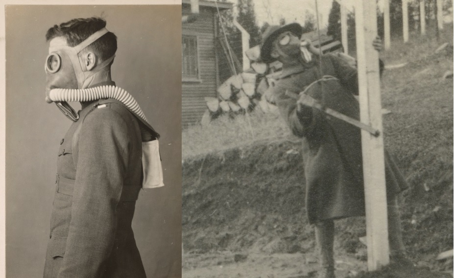

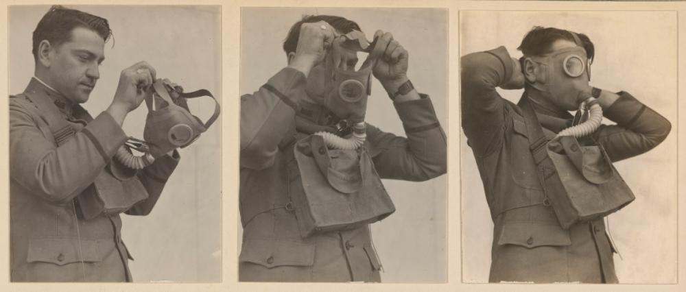

DukeNougat3d Posted January 20, 2019 #223 Posted January 20, 2019 U.S. Development and Domestication of the Tissot Gas Mask Section IV-b. - American-Tissot, Model of 1917, Bureau of Mines Type (Late) The photos below illustrate the simplicity to which the American-Tissot was donned as opposed to the Box Respirator-type Masks currently in use with the AEF by this point, which took seconds longer to properly don. It should be noted the specimen pictured is the April 1918 pattern with the reinforcing outer layer of 'black stock' rubber. [source: U.S. National Archives]The photos below show the various hardware used in assembly of an American-Tissot, Model of 1917, Bureau of Mines Type Mask - 1: Eyepiece Crimping Ring 2: Eyelens 3: Eyepiece Washer 4: Flutter Valve 5: Guard Bracket 6: Guard Retainer Spring 7: Clarifying (Tissot) Tubes 8: Die-Cast Angletube 9: Molded Chin Rest [source: U.S. National Archives] The photo below shows the assembled angletube, with breathing hose, chin rest, clarifying tubes, and outlet valve assembly. [source: U.S. National Archives]
DukeNougat3d Posted January 20, 2019 #224 Posted January 20, 2019 U.S. Development and Domestication of the Tissot Gas Mask Section V - American-Tissot, Model of 1917, Bureau of Mines (Navy Shoulder Type) Around the same time the April 1918 pattern of BoM American-Tissot was being pushed for a production contract with the U.S. Army, Geer had developed a variant for the U.S. Navy as well. This being the American-Tissot, Model of 1917, Shoulder Type. Documentation is scarce on this particular setup, but evidence seems to suggest this variant was relatively short lived in trials with both the Army and Navy.Essentially, it was a normal BoM American-Tissot, with the improvement of a left-angled hose stem on the die-cast angletube, so that a longer hose may be lead over the shoulder to a cental, back-mounted canister, with the hopes that it would be less claustrophobic to use in the confines of a ship. The Navy seemed interested in adopting it as a special purpose mask for use against ammonia, but ultimately it was rejected for mass-production after 100 had been procured by the U.S. Navy for testing. Pictured Below: Left - Side Profile View of the American-Tissot, Model of 1917, Navy Shoulder-Type. [source: U.S. National Archives] Right - View of a Soldier (Probably Charles William Maurer) raising a Gas Danger Sign while wearing the American-Tissot Navy Shoulder Type at the American University Experiment Station. [source: Estate of Addie Ruth Maurer]
