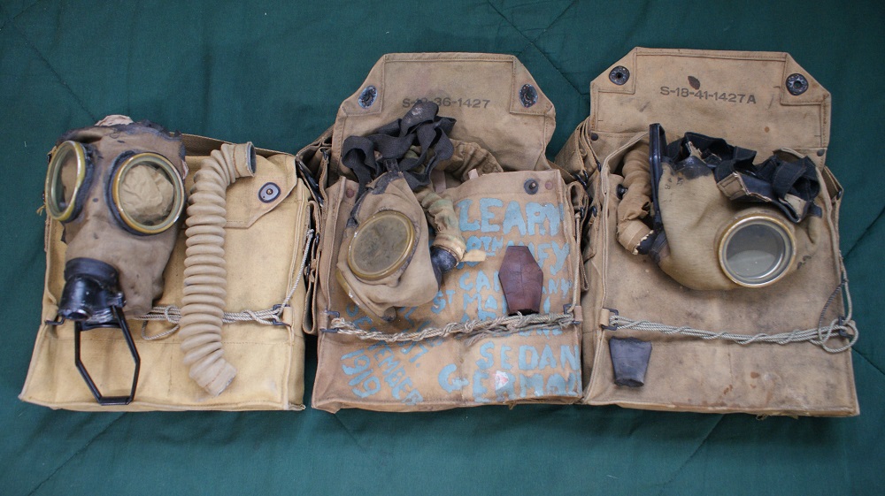

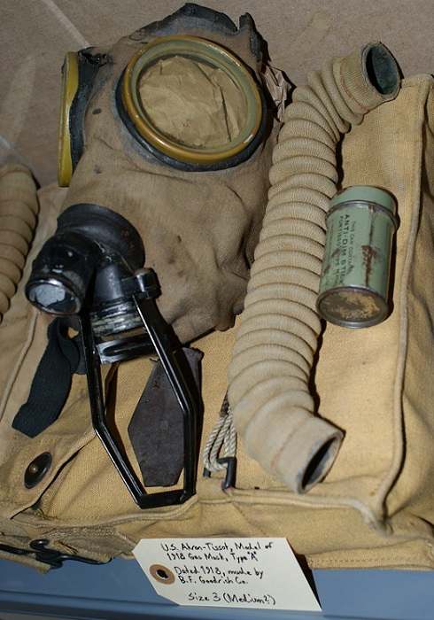

U.S. Akron-Tissot (A.T.) Masks. From Left to Right:
- Model of 1918, Type A Facepiece, Size 3
- Model of 1918, Type B Facepiece, Size Medium
- Model of 1918, Type B Facepiece, Size 3

The markings on my Type A's Facepiece read:
- 3 (Size Stamp)
- 250H 390 (Serial Stamp)
- 22A (Curing Form No. and Facepiece Type)
- "FOR TRAINING PURPOSES ONLY" (This stamp is sadly all but entirely faded away on the left cheek of the mask and is almost invisible to the naked eye.)

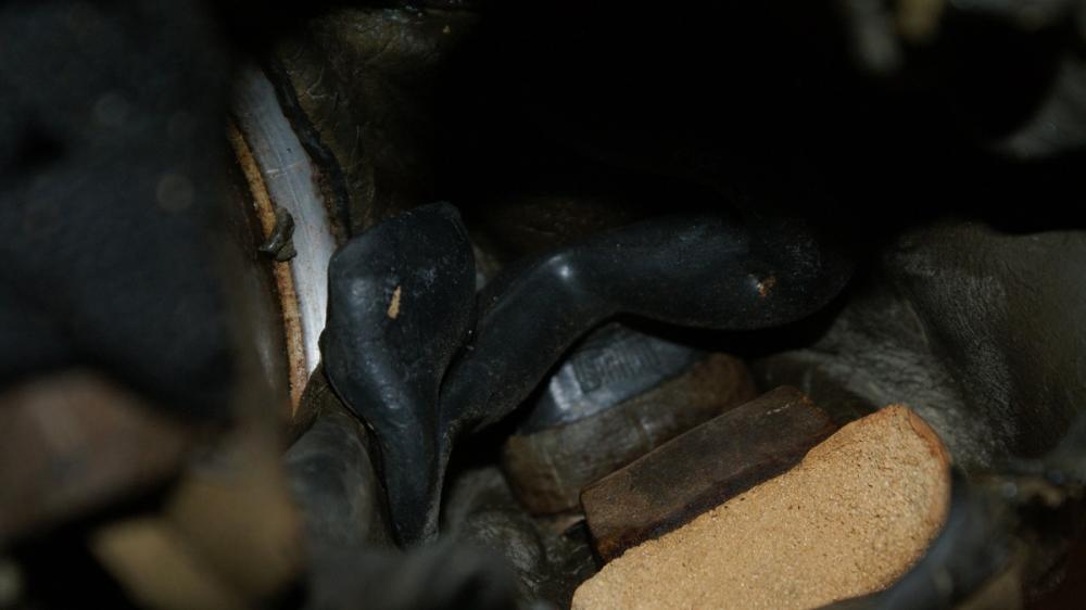

A good shot of the Type A's dilapidated interior, giving a view of the Clarifying Tube remnants and the earlier model of Chin Rest Padding.

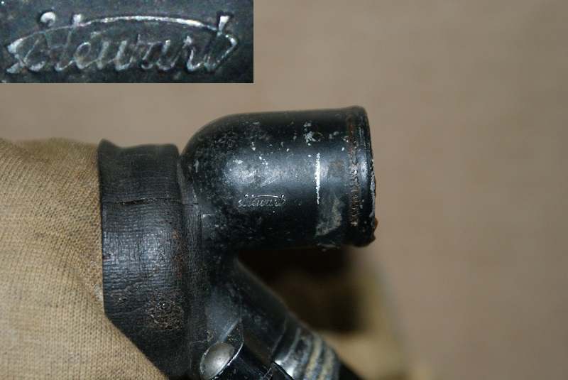

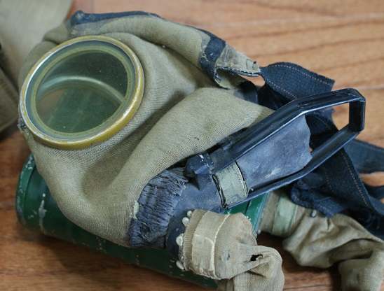

^Here you can see a detail that the hose would have originally covered up - the angletube assembly on my Type A is made by the Stewart-Warner Speedometer Co.

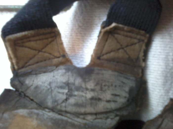

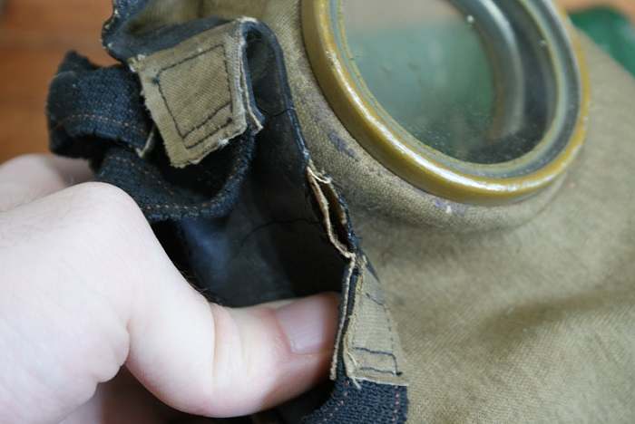

^Detail on one of the side harness tab assemblies of the Type A, with the side straps grouped together near the temples similar to a Box Respirator mask. The Type B Facepiece did away with this central 'mono-tab' horseshoe shape for the side straps and implemented individual harness tabs.

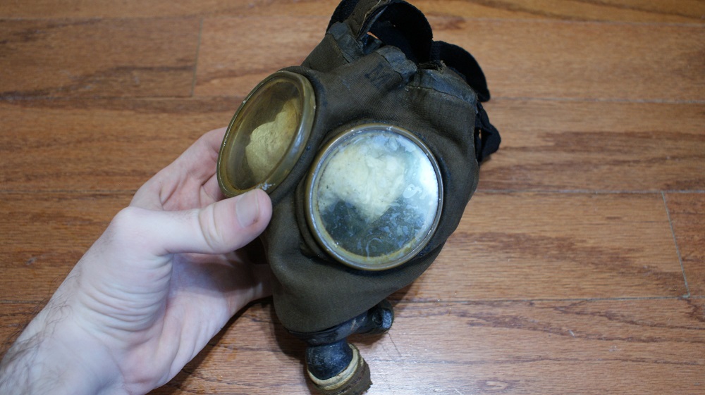

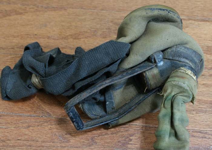

The next specimen is actually a quite recent addition that I picked up last Monday as of making this post - it is probably my worst condition A.T. that I own, overall somewhat of a typical Type B Facepiece, but with one major twist - the facepiece is stamped as a size 'Medium' rather than the usual 1-5 Numeric Size System we adopted from the British early on. There is a handful of period photos of Type B's with a Small-Medium-Large sizing system and it seemed to have been very short lived. Not even the carrier is stamped for a size medium (and is stamped with the Typical '3' representative of the size). The 'trench art' visible on the carrier is almost certainly 100% fake.
^The mask as received. It is quite in a poor state - solid as a rock and folded in on itself.
^Here you can get a good view of the aforementioned 'Medium' stamp in place of the typical '3'. Possibly the only example of it's kind. The head harness itself (not pictured) is also slightly different in that it lacks any adjustment buckles and the triangular head pad is sewn in a much tighter grouping.

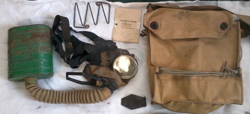

Now onto the final example in my personal collection, here we have a basic Type B Akron-Tissot, and probably probably my best condition A.T. of the three. This one I had actually bought off a very kind user in this forum (you know who you are) who was generous enough to bring this specimen to my attention after reading through this thread and resold it to me for study and evaluation. Despite being rock-hard and crumpled as usual, this kit is in extremely good shape with lots of visible markings and almost absolutely no rust whatsoever.
^The kit itself.

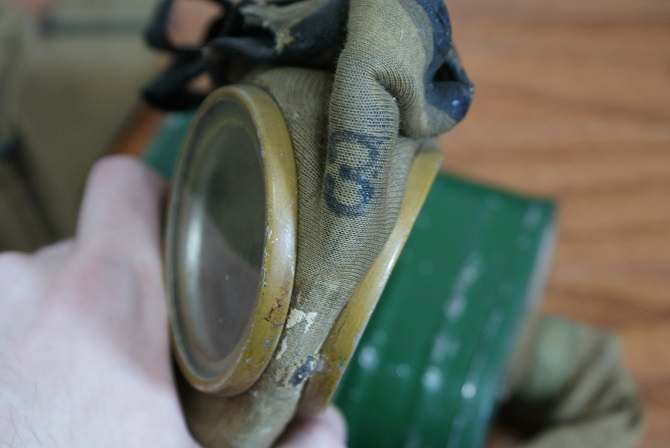

^ Detail on the facepiece. Note that 2/3rds of the original MI 'Flutter' Valve are still intact in this photo, but were very fragile and have since fallen off.
^Detail on the size stamp. Notice the evidence of a repair plaster being applied between the lenses. This is very typical on Type B Facepieces, as they are most prone to failure here.

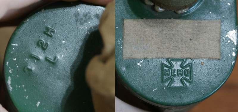

^Markings on canister:
Left:
- 312H (Batch or Serial No.)
- L (Type L Canister. Similar to the more common Type J, but the Type L has more absorbent inside.)
Right:
- Blank Fabric Name Tape (It is very common to see WWI-era U.S. Tissot Masks with a patch of tape on the canister named to the person it was issued to. This was to signify ownership and assure these highly experimental masks were not stolen.)
- Hero Manufacturing Co.

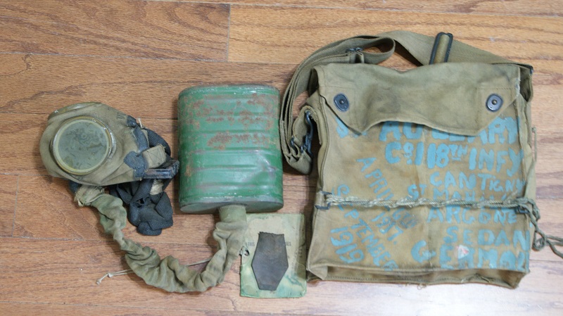

You're cornering the market! Great photos. Whats the name on the painted carrier? I'll look him up in the 1st Divisions records quick.
I wonder if 1845 is in reference to the week of production, 45, similar to how the carriers are marked?
Thanks! These things seem to keep finding their way to me lol
The name appears to be a Sgt.(?) A. O'Leary. I have had research associates to try find evidence on the man but unfortunately, nothing. If you can find anything, I welcome your efforts and any findings would be much appreciated.
The reason I think the markings are fake is because U.S. Tissot masks were never used on the frontlines, they were reserved for rear areas for testing only, they never saw combat as far as I know. And given that they were highly specialized experimental equipment of their time period, I highly doubt a soldier would have the time or freedom to scribble graffiti all over the carrier.
Moreover, the dates marked on the carrier do not line up with the A.T.'s contract and production dates, so assuming the markings aren't fake, it's possible the carrier is mixmatched, or perhaps the markings were added by a WWI veteran postwar, which at that point, A.T.'s were reserved as training masks only, and a majority of them were dumped on the surplus market or given to industrial safety companies to redistribute.
Anthony O'Leary in Company I 18th Infantry went to France as a Private, was wounded in 1917 and 1918, and came back from France as a Private in June of 1919. Doesnt jive with the date or rank...No other O'Leary in Company I 18th.
DukeNougat3d
That almost confirms these markings being a fake, much appreciated.

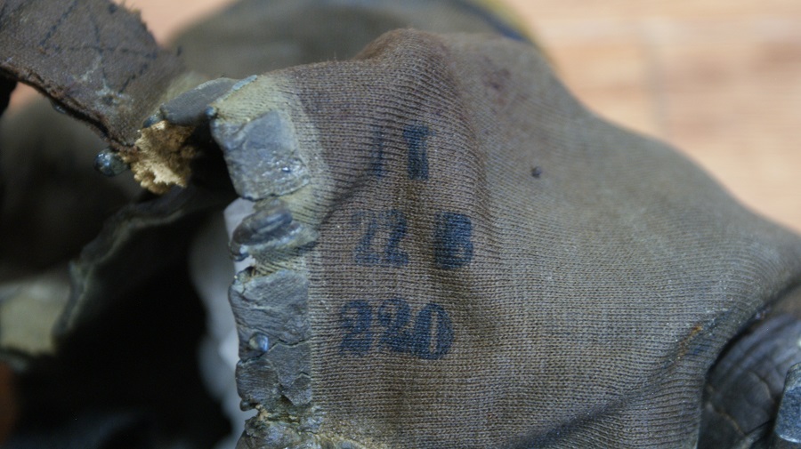

DukeNougat3d
AT - Akron-Tissot
22B - Curing Form #22 for Type B Faceblank
220 - 220th Day of 1918 (Assembled August 7th, 1918)
270H388T - 270 (Hundred), 338 (Thousand)th Faceblank Produced.
So not only is this Type B the only known existing Medium-sized model, but it is also the only Type B known to exist with a 3-Digit date code (Day Number of the Year), rather than the usual 4-digit (Last Two Numbers of the Year + Week Number of the Year).
Note that the mask is only this dark color because the stockinette was still damp when the photos were taken. It will resume its normal khaki color after drying.

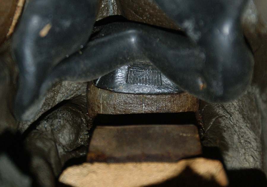

Now for the thing that shocked me the most - If you look closely inside the chincup, you can see a black rubber reinforcing strip in the center bordered by two lines of cement (green stripes). This is indicative of where the rubber was joined together at the chin.
This meaning that the Type B was NOT dip-molded as indicated by all previous references of the mask in this thread, but rather had a solidly vulcanized seam on the chin much like the Type A Model Akron-Tissot. Dip-molding was a production method being experimented with (and may have possibly been a later production method), but whether or not it was implemented into production Type B's or not has yet to be determined at this point.

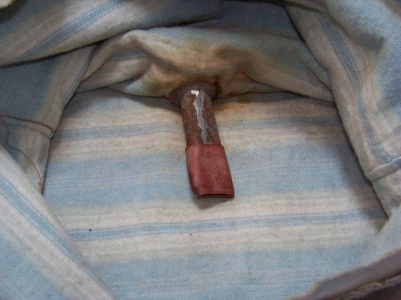

dan_the_hun84
Question on the PH helmet flutter valve- did they have the same sort of mouthpiece that the later SBR and CEM masks had? or was it just a simple rubber coated tube? I have never been able to find an interior pic of an origional- but keep hearing it described as a "tube" held with the teeth
It's the latter of the two - a soldered tin tube with a bit of rubber around the end. Some low-end reproductions try to get away with snorkel-style mouthpieces, but this is completely inaccurate.
