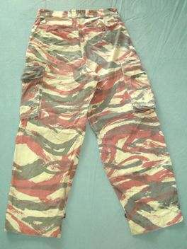

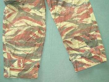

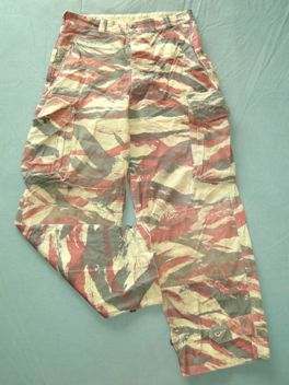

ARVNcollector Posted August 4, 2014 #1 Posted August 4, 2014 Greetings All, I enjoyed your previous thread on this topic but am still not very good at discerning which patterns were used in Vietnam. Would you please give me your thoughts on these pants? Thank you in advance, Alan
Mike Force Posted August 4, 2014 #2 Posted August 4, 2014 not a indochina war pattern, this cut first show up in the late algeria war! not a realy collectible but nice to wear for autdoor activity.
Andrei Posted August 4, 2014 #3 Posted August 4, 2014 They are starting to get hard to find. They don't fetch high prices but the day they will get off radar, everyone will be sorry.
Mike Force Posted August 4, 2014 #5 Posted August 4, 2014 yes they getting more and more hard to find.... back in the 80's and early 90's the militaria shops in germany had tons of them in any size and conditon! at the time you could find a medium-long piece in great/mint condition for about 10 to 20$.I enjoy to wear them because the cut and fabric fills very comfortable.
kammo-man Posted August 4, 2014 #6 Posted August 4, 2014 Pattern was used in Vietnam 100% . And Laos And Cambodia. And by US advisors in both Asia and Europe during the 1960s and 70s . owen
Mike Force Posted August 4, 2014 #7 Posted August 4, 2014 LoooL.... but its still far away from the 47/51, 47/52 and the 47/53 pattern!

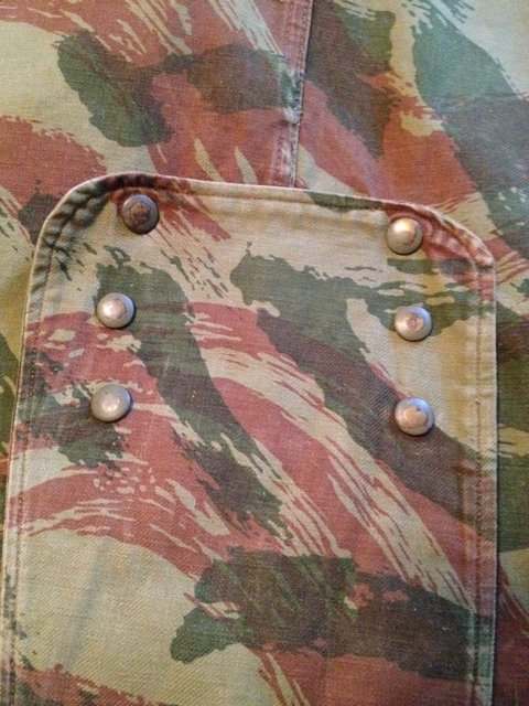

ARVNcollector Posted August 5, 2014 Author #19 Posted August 5, 2014 Thanks Owen, Awesome photos! It makes more sense to me now. When I wore my '54 jump jacket to the march with the Nhay Du vets at the Tet festival, some of them kept telling me that the ones they wore had elastic bands at the cuffs. I did not know at the time what they were talking about. Does your '56 have elastic cuffs? Alan
Klaxon Posted August 5, 2014 #20 Posted August 5, 2014 Owen, What type of material is the Viet made 56 lizard you posted printed on? I have a two square pocket utility type shirt that has no markings and is printed on a soft sateen type fabric. Wondering if that's the same as yours. Cheers, Matt
