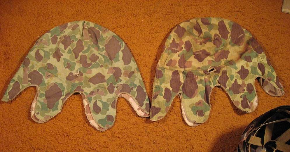

Below, an example of early vs. late dyes: the Helmet Cover from the Suit above (right), compared to a later Cover made with the "new improved" dyes (left). Both Covers show about the same amount of fading, but note that the early Cover still holds the original shades on the flaps which were hidden under the Helmet shell. Again, the background shade is decidedly green. If you come across a used HBT 'Flage piece, it's always interesting to look inside the pockets or other areas hidden from view to see what the colors were like before the garment was used and washed.
