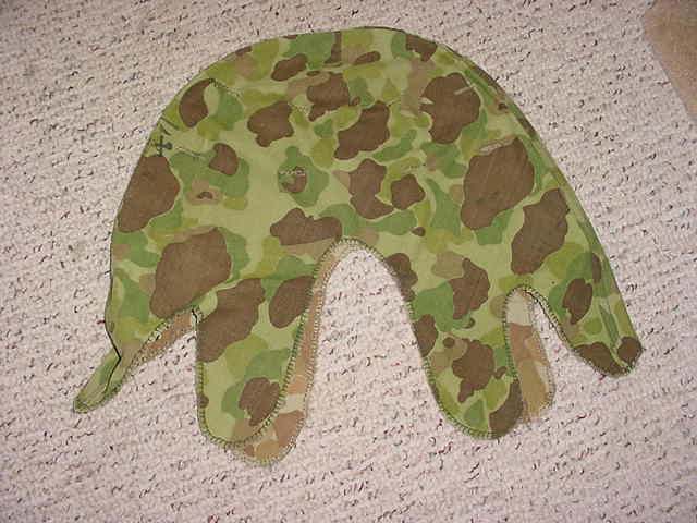

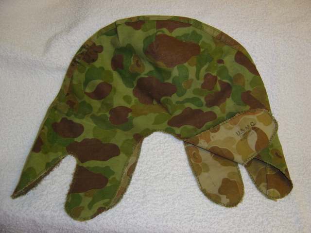

bigjoe Posted January 17, 2007 #26 Posted January 17, 2007 this one is made out of shelter-half cammo...u.s.m.c crystal ltd australia 1943...smells,rust stained,looks right... not sure..faint funny looking e.g.a on green side only..if only it could talk.

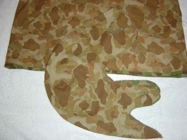

bigjoe Posted January 17, 2007 #27 Posted January 17, 2007 beach side. this is the one myself, lloyd and chris chewed over on sunday... this is made from ww11 shelter-half ..but when..
bigjoe Posted January 17, 2007 #28 Posted January 17, 2007 sat on my odd looking smock also made out of shelter-half..same pattern/ texture/feel if anyone has a h.b.t. cover crystal marked please post pics of the beach side for me.
Greg Robinson Posted January 17, 2007 #29 Posted January 17, 2007 Hey Joe Here's a non HBT camo cover that was sent to me by Lloyd a few years ago. No markings other than the very unique looking ega stencil. And I compared it to a confirmed modern made fake made out of ww2 shelter half and the colors are different. The quality of manufacture of this cover is inferior to known USGI covers but good enough that it might have been made overseas by a company not very skilled at this but good enough to get by during wartime. Greg PS...take note of the foliage slits which were always left off the "shelter half" fakes. No reason to do this with a fake since most USMC collectors will pay a preminum for "1st pattern" covers.
bigjoe Posted January 17, 2007 #30 Posted January 17, 2007 very interesting greg..foliage slits left off the "shelter half" fakes..yes that makes sence as you say collectors will pay a preminum for "1st pattern" covers..why go to the trouble to add them..the ega stencil is a dead copy of the shelter-half one i have sat here.. ..will post pics of mine ...now i have seen four of the wobbly aussie made covers but never one with foliage slits ...this gets deeper..joe
Greg Robinson Posted January 17, 2007 #31 Posted January 17, 2007 very interesting greg..foliage slits left off the "shelter half" fakes..yes that makes sence as you say collectors will pay a preminum for "1st pattern" covers..why go to the trouble to add them..the ega stencil is a dead copy of the shelter-half one i have sat here.. ..will post pics of mine ...now i have seen four of the wobbly aussie made covers but never one with foliage slits ...this gets deeper..joe The one that Kenneth found almost has to be legit......as does yours. Mine also shows use and age. But we may never know for sure. Greg

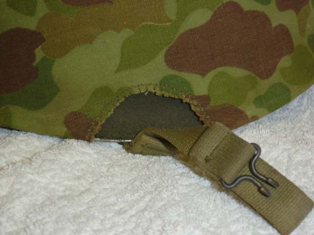

Schnicklfritz Posted January 18, 2007 #34 Posted January 18, 2007 On these Aussie covers where the M1's chinstrap bails would go through the cover. Does the cover need to be slit for the bails or is the cover made to fit around the bails? They look like they are made to fit around the bails without having to slit the cover. It looks to me that the Aussie cover conforms to helmet cover construction patterns that are much later and post war(like the Mitchell and Erdl pattern covers), not the WW2 style that Marines had to cut to put the chinstrap through. If Crystal Ltd. "copied" the cover like they copied the camo pattern, then I would imagine that the cover would exhibit the same construction as 1st pattern covers all around. I'm still on the critical side that these covers are post war fantasy pieces patterned off of later helmet covers. Even if one came from a vet's estate, that still would not do it for me. Not to be too cynical, but many times fake items have come out of vet estates. My friend just started a museum back home in WVa. A WW2 82nd vet brought him his M1C helmet and said that it was the one he wore during the war. The liner was dated 1963 and all componets were 60's era M1 parts. Just one of many stories of bad items coming from vet estates that I'm sure everyone has heard of. Not slamming vets of course, but sometimes along the line a dishonest collector might replace an original with a reproduction without the vets knowledge or may attempt to "plant" an item in an estate in order to try to validate it to the period. I've never owned one of these covers, so I've never been able to compare them to other covers. Perhaps one of the owners could compare the Aussie cover dimensions to the later ERDL or Mitchell pattern covers. To me the pattern looks like it came from a 60's dated ERDL cover.

bigjoe Posted January 18, 2007 #38 Posted January 18, 2007 e.g.a stamp on my ' made in Australia' cover
bigjoe Posted January 18, 2007 #39 Posted January 18, 2007 as you can see the Aussie cover looks like it is made to fit around the bails. ..are they all like this or is this the result of knocking them out in a back room... ..

Schnicklfritz Posted January 21, 2007 #42 Posted January 21, 2007 as you can see the Aussie cover looks like it is made to fit around the bails. ..are they all like this or is this the result of knocking them out in a back room... .. Ok, now if this is the way that the Aussie made covers fit over the M1 helmet, then it should be easliy picked out in period photos due to the high seam over the bails. Ok, start diggin' through those millions of photos!!
