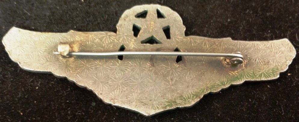

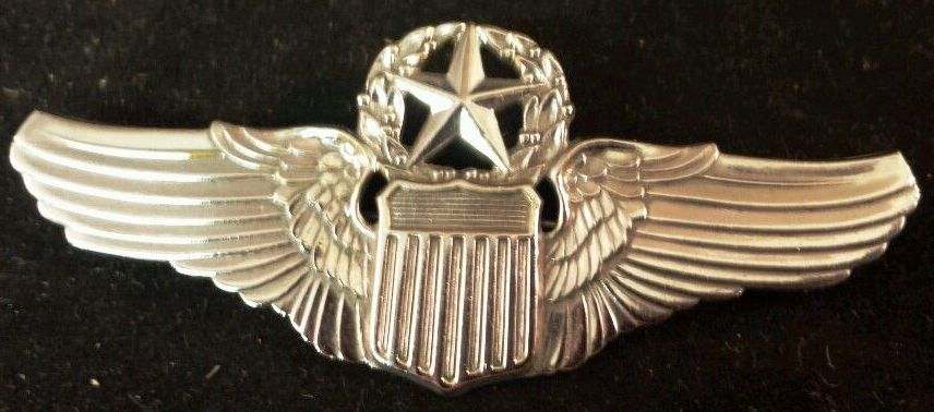

skypilot6670 Posted April 16, 2016 #301 Posted April 16, 2016 Currently on EBay.Here is a link .Someone with more computer skills could please import photos.Is this real?http://www.ebay.com/itm/ORIGINAL-WWI-ULTRA-RARE-US-FRENCH-LAFAYETTE-FLYING-CORPS-BADGE-WITH-STAR-/111812575136?hash=item1a088c7fa0:g:-lwAAOSwI-BWL3Oa
rustywings Posted April 16, 2016 #302 Posted April 16, 2016 Currently on EBay.Here is a link .Someone with more computer skills could please import photos.Is this real?http://www.ebay.com/itm/ORIGINAL-WWI-ULTRA-RARE-US-FRENCH-LAFAYETTE-FLYING-CORPS-BADGE-WITH-STAR-/111812575136?hash=item1a088c7fa0:g:-lwAAOSwI-BWL3Oa Here's two of those ebay images (#111812575136).

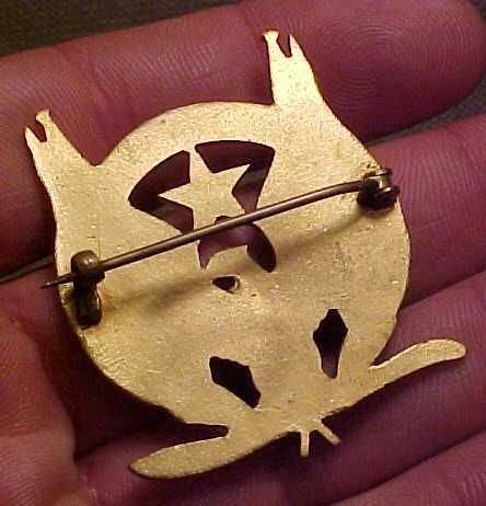

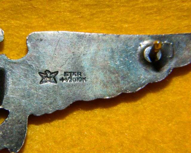

Kropotkin Posted April 17, 2016 #304 Posted April 17, 2016 Here's one for you lads. I saw this 1.5" balloon observer wing, being sold as a combat observer wing, for a pittance so thought what the heck, nothing to lose. The finish looks pitted and in places indistinct so could be cast, but I supposed (perhaps wrongl) that small sweetheart sized wings aren't often faked. So could it be a cheaply produced period piece or just a knock-off? Cheers!

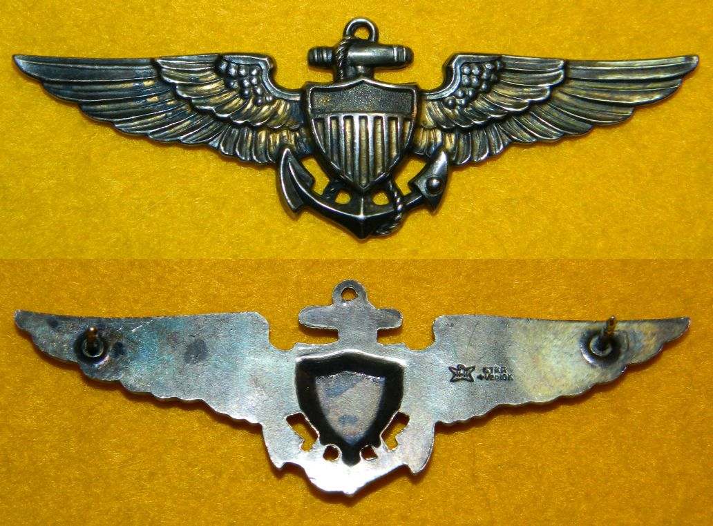

Wedgehead30 Posted April 20, 2016 #305 Posted April 20, 2016 H&H Naval Aviator Wings. Would these be post war?
pfrost Posted April 20, 2016 #306 Posted April 20, 2016 They very much could be. It's not like they drew a line in the sand and said, "the war is over, time to change up until the next war starts". These wings were probably used well after the KW time period as they moved through old stock and dies. P
pconrad02 Posted April 20, 2016 #307 Posted April 20, 2016 Patrick, But didn't they switch to the electro solder mention in the early 50's? These look more late WWII to me.. Paul
pconrad02 Posted April 20, 2016 #308 Posted April 20, 2016 Patrick, But didn't they switch to the electro solder mention in the early 50's? These look more late WWII to me.. Paul

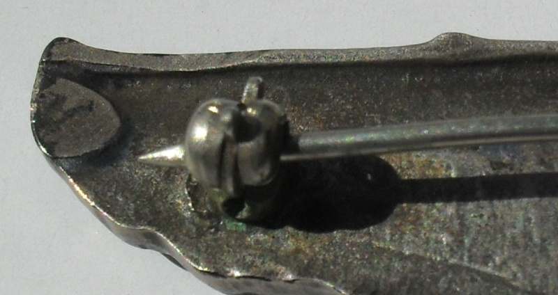

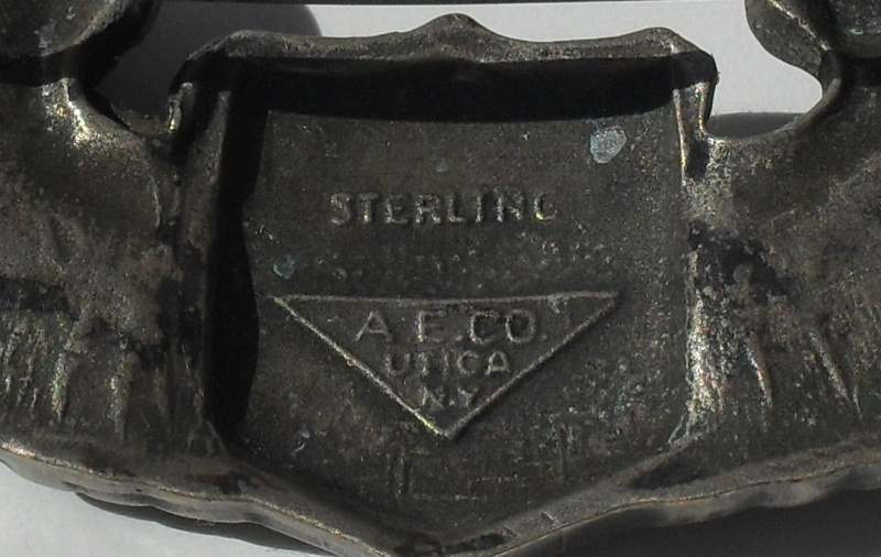

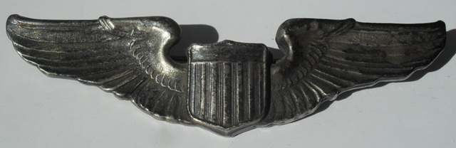

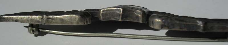

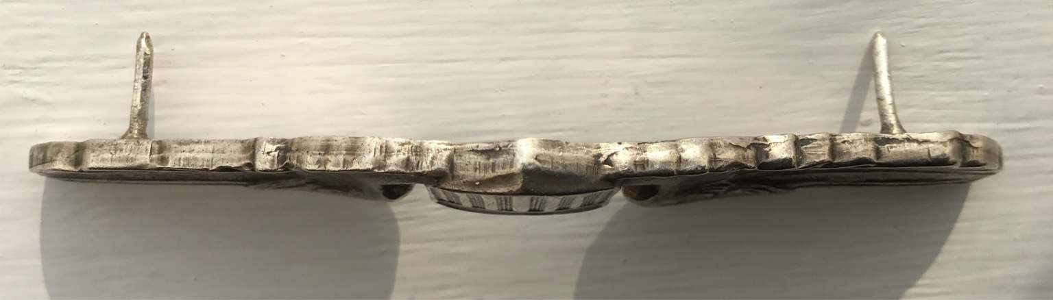

Kropotkin Posted May 28, 2016 #313 Posted May 28, 2016 Gentlemen, I'm a little suspicious of this AE Co pilot wing I Just picked up. An initial look at the hallmark persuaded me that this wing was ok but on further inspection I have my doubts. I've read that AE wings relatively poor quality gives off a cast-like aura, but in the cold light of day these look like a cast copy. Your frank and expert opinions will be gratefully received. If it's a collective thumbs down, I'll be going to get a refund tomorrow. Thanks!
AAF_Collection Posted May 28, 2016 #314 Posted May 28, 2016 Personally I'd say your AE Co wing is original WWII period, based on comparison with original AE Co wings I have. Matt.
BROBS Posted May 28, 2016 #315 Posted May 28, 2016 It's a cast fake, unfortunately. Sent from my iPhone using Tapatalk
pfrost Posted May 28, 2016 #316 Posted May 28, 2016 I'd be inclined to agree with Matt. It looks fine to me. AECo are not the sharpest of the wings. P
BROBS Posted May 28, 2016 #317 Posted May 28, 2016 It seems like bubbles and pits on the obverse?! I've never seen that on an original? Also the back looks 'puffy' and the edge shows casting marks rather than die marks IMO. I will have to pull a few of mine out and look at them again. I know on a few the strike is not that sharp but they don't look like this. Sent from my iPhone using Tapatalk
rustywings Posted May 29, 2016 #318 Posted May 29, 2016 BROBS, I see what you mean about the pits, pimples, blemishes and inconsistencies along the edge of the wing, but I believe Patrick's and Matt's evaluation is correct. AECO wings do appear to have been pumped out in large numbers without the quality control seen with other manufacturers... so with AECO made badges, I focus on the cleanness of the shield ribbing and crispness of the hallmark... which both display well in this case.
Kropotkin Posted May 29, 2016 #319 Posted May 29, 2016 Thanks for the feedback, guys. So do AECO wings often display such bubble/pits? Does anyone have any genuine examples they could share to illustrate a similar poor finish? It's all a learning process for me.

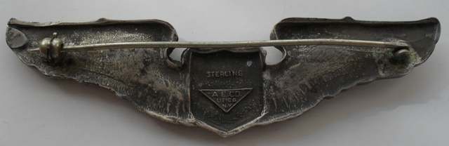

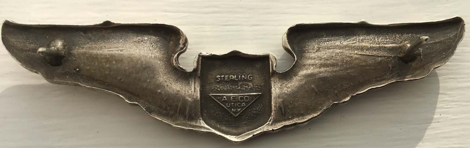

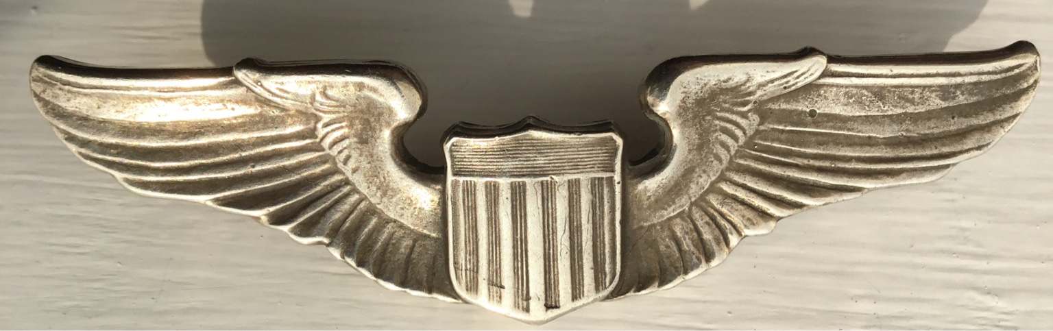

AAF_Collection Posted May 30, 2016 #321 Posted May 30, 2016 Thanks for the feedback, guys. So do AECO wings often display such bubble/pits? Does anyone have any genuine examples they could share to illustrate a similar poor finish? It's all a learning process for me. Here's an AE Co pilot wing I have for comparison.
