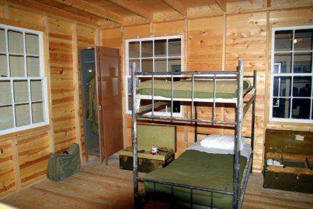

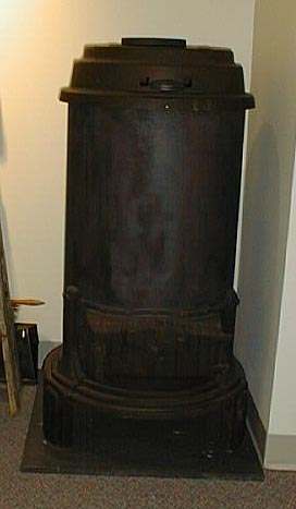

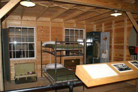

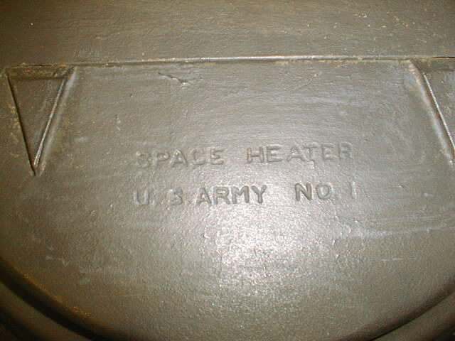

I cant take credit for these photos, as I had saved them off the web some time ago, but This is at the museum at Chenute Air Field Museum in Rantoul IL

Wow,
That is an awesome photo. I would love to have mine look like this. I am looking to try and build a smaller version with 4-6 bunks. I have a local guy who has some WWII Bunks he is going to sell me. I have an OLDDDDDS saw mill in my area that I know can cut the wood. I know that most of the wood was rough cut back then, or at least I think so. I saw on ebay an ARMY STOVE, but I missed out cause it was a local pickup only and it was in PA, or NJ, or NY or somewheres such. I think I will have to go that route when I get the barracks built and get to that point, but I dont want to buy new seats when I dont have the car yet.
I greatly appreciate any other help that you fellas can provide.

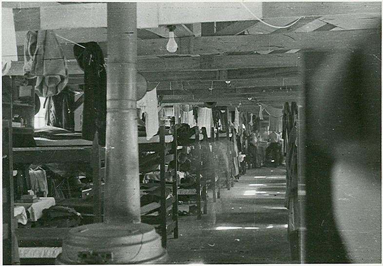

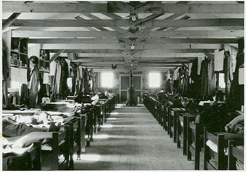

If you intend to replicate a typical Army training base barrack, you would do best with a metal bunk. I believe this is what is generally found at installations that are "permanent." The wooden bunks, as seen in my two photos, were constructed on site. Thus there was no need to haul in such furnishings.
Note that Camp Clinton was a temporary installation, to be used only for the duration of the war. After it was closed, the buildings, mostly pre-fab, were partially disassembled, sold as surplus property, and trucked away to local farms, etc. Smaller fixtures and furniture would likely have been destroyed. I know many things at the camp were burned. At some camps, even the underground plumbing and sewer lines were dug up and sold! For a number of small towns, this is how they were able to "modernize" their water supply and sewage system.

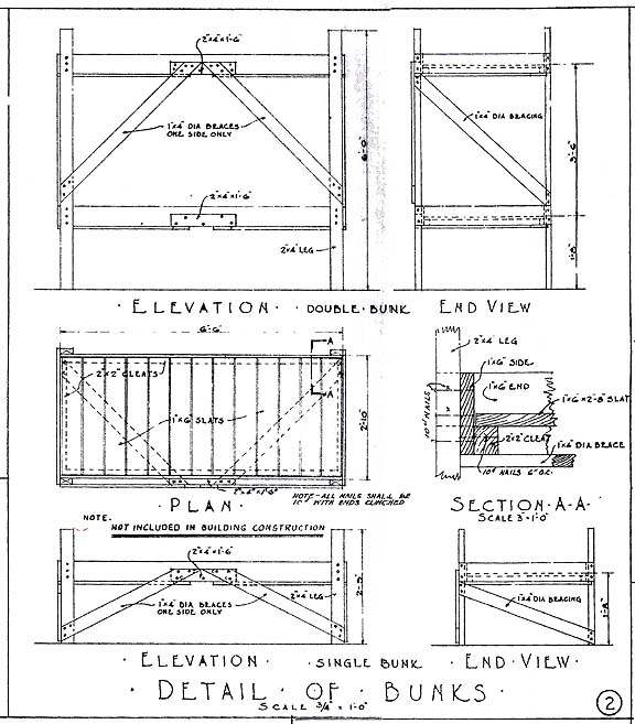

Chad---
Here is one design for the bunks. Circa mid-1942.

This is part of a PM sent to me by member tylis2 regarding the bunks seen in my two photos. Very informative!
I have a set of the wooden bunks in the picture, with original varnish finishes, and a US routed on one of the end panels. They are made of laminaed oak boards for posts and single boards for the side and end rails, and they came out of an old boy scout camp in upstate new york that was being sold off some 20 odd years ago. Hundreds of them. They have flat metal "springs" with about 3" coil springs on either end holding the metal springs to the wooden frame rails; and horsehair matresses covered in a blue striped mattress ticking. The rails are held to the headboard /footboard with approx 6" threaded bolts. Contract marking on the inside of the frame indicated they were sold by Macy's NY.
If you look at the photo closely, you will see a little light shining through the bottom of the posts on the bunks through a groove 'cut' into the bottom; these are bunk beds that were used singly in this photo. On the top of the posts was a piece of wood that formed a tongue. When assembled as a bunk bed, the tounge fits into the groove and provides a solid joint. The top and bottom sections differed. The bottom section had a flat bottom on the post to sit on the floor, and the tongue on the top of the post; and the top section had the groove on the bottom of the post and was flat on the top. These bunks would all be top sections. The 3 piece laminated posts would allow for the center piece to be raised / lowered to form the tongue / groove without cutting during manufacturing.

Okay, whereever you deem fit for the post. Hopefully we can get someone who has some barracks plans as well.
Thank you to all, please continue replying for any new information, detailed photos, or plans.
Please PM me to if needed.
Thank you also for the bunk blue prints.
