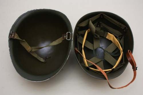

These are late pattern chinstraps. Notice the underside. (T1 device obscured for contrast.)
On the left; a US issue. On the right; an Austrian copy (U.SCH '74) produced for Denmark.
Does anyone notice some differences?
1. Notice the Euro model has a slightly larger fastener. (A bit longer & about 1 or 2mm wider.)
2. The catch "arrow" is longer & thinner on the Euro, vs. shorter & wider on the US.
3. The Euro buckle is squared, flat, and more of a point . The US version is a little more rounded on the edges, a less pronounced point, and the curved "dip" on the end. (The anchor is imprinted on the opposite side.)
4. The hourglass shaped cut-out for the claw is wider on the Euro version.
5. The tabs for adjustment wrap completely around the chinstrap on the US issue, versus the Euro that only partially encompass the chinstrap.

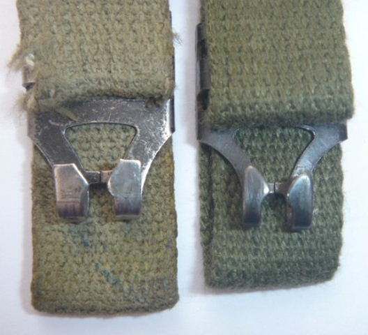

Just for discussion; I received an Belgian MP helmet with these chinstraps:post-123609-0-75605100-1380332002.jpg
Belgian marked shell, with a Belgian produced "ABL" liner.
These are the only one I have ever seen. (Perhaps Johann can tell us something about them.)
Johan Willaert
I've Always assumed those straps to be Dutch rather than Belgian... No idea if they were ever factory attached to Belgian shells or not..

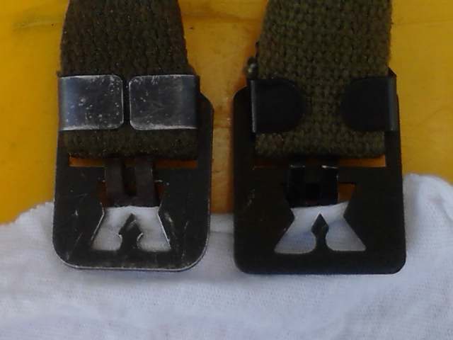

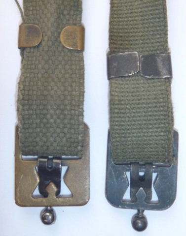

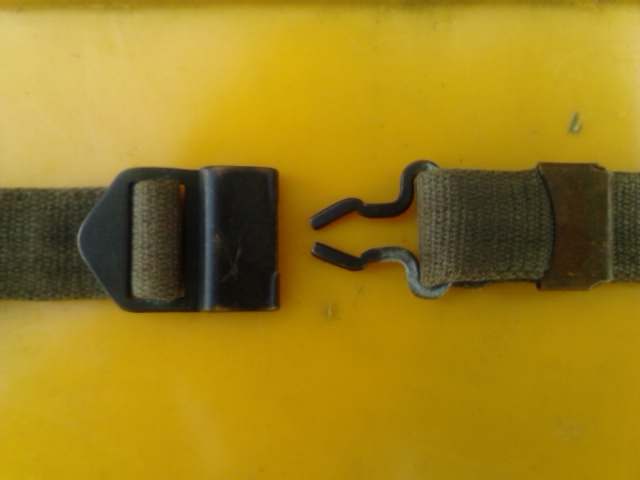

Some further T1 buckle comparisons. Belgian on the left, US on the right. The Belgian one is solid brass and the shape is slightly different from the US made buckle. The keeper is also evidently brass. Also note the different weaves of the webbing.
"J" hook comparison. The Belgian hook (left) is a slightly different shape and, beneath its finish, quite a bright silver.

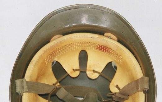

Ian what's the liner look like for this French M51 helmet? Can you post it?
Voila monsieur! Look familiar? Obviously, its shape follows the contours of the French shell, but its interior is pure M1.
Is there an outside exteriour shot of the French liner? I only ask because it's important to see the whol thing to get a id of it, It sometimes appears, this French M51 liner in photos being worn in the early period of the 2nd Indochina war (ie The Vietnam War) by ARVN, with it being incorrectly captioned as U.S. if it's captioned at all.
Here you go Kevin....a Casque M51 liner. The main difference is the flared rear rim...also present on the shell.

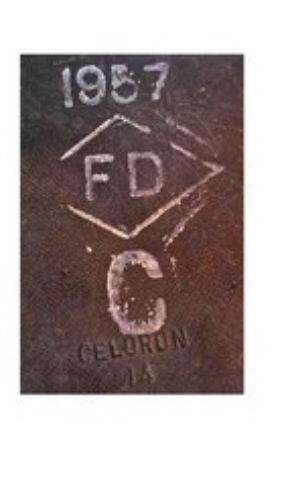

French '51 pattern "OTAN" helmet shells and liners usually bear clear white stampings inside them containing the date and manufacturer's logo, as below. I recall once seeing a French liner on eBayUS listed as an "original" WW2 GI liner. The ad featured good, clear photographs including a close up of the crown stamping which read something like " M.LECLERC ET FILS, 1953" as clear as day! So, I sent a polite internal message pointing out the fact that the liner was, in fact, clearly of French origin. The seller ignored me completely, the listing remained unchanged....and the item ultimately unsold!
